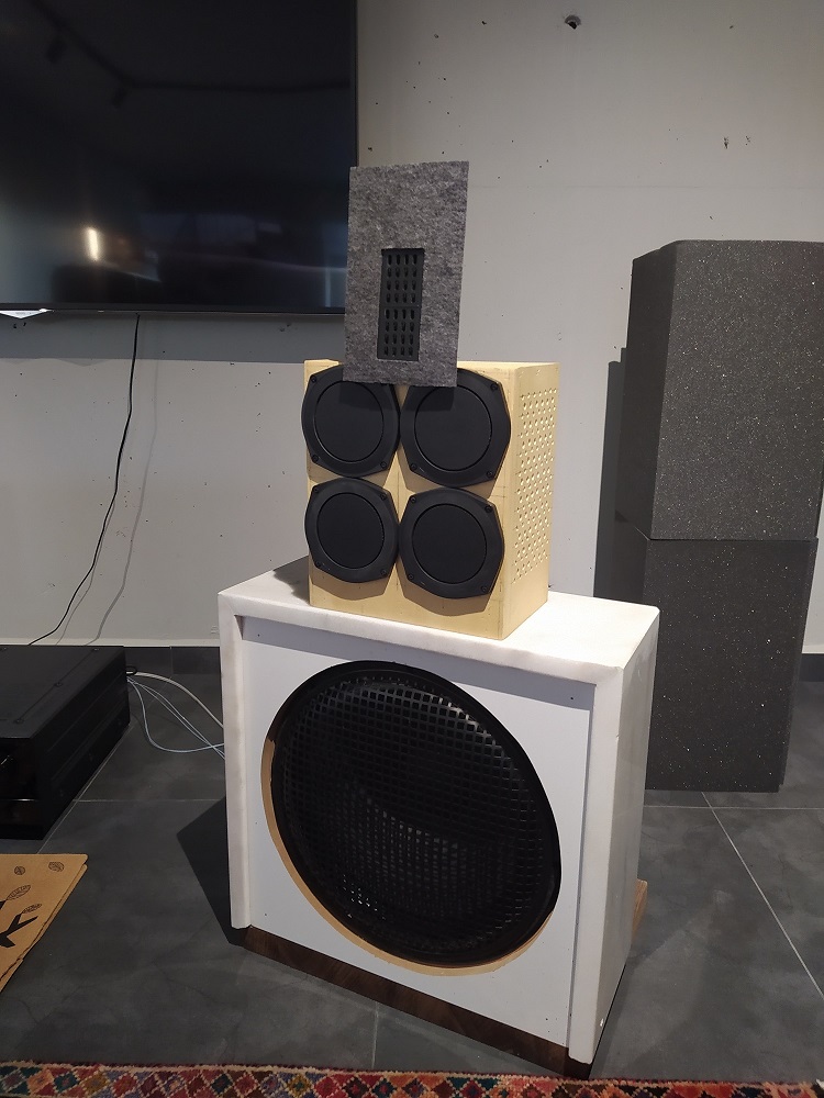

i have been busy...
first, as you can see in my previous post, i built heavy frames for the woofers.
the center is 7 layers of mdf; i had it covered with 3cm thick marble, and the base is butcher block. weigh probably 30kg each. frames are 52x52 and 21cm deep, sth between u and h frame.
feet are 3 wooden pins drilled into the butcher block; works very well with tiled floor.
i have tried no-baffle (swinging nude) and baffle with fin type center brace, but this heavy u/h frame surpassed them all; least ringing = tighter bass

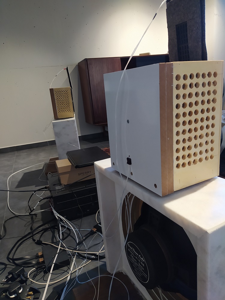

after the heavy woofer frame, the only ringing i could hear was in the mids.
the center was the weak point of the mid frame, hence i decided to close the back and put a brace in the center.
the walls are perforated on sides and top, and lined with wool carpet underlay.
box is 25x25 and 15cm deep.
the radiation should be closer to cardioid.
mid ringing is much reduced... whatever left is mostly room acoustics, i suspect. i will revisit after some room treatment.
and now the bomb...

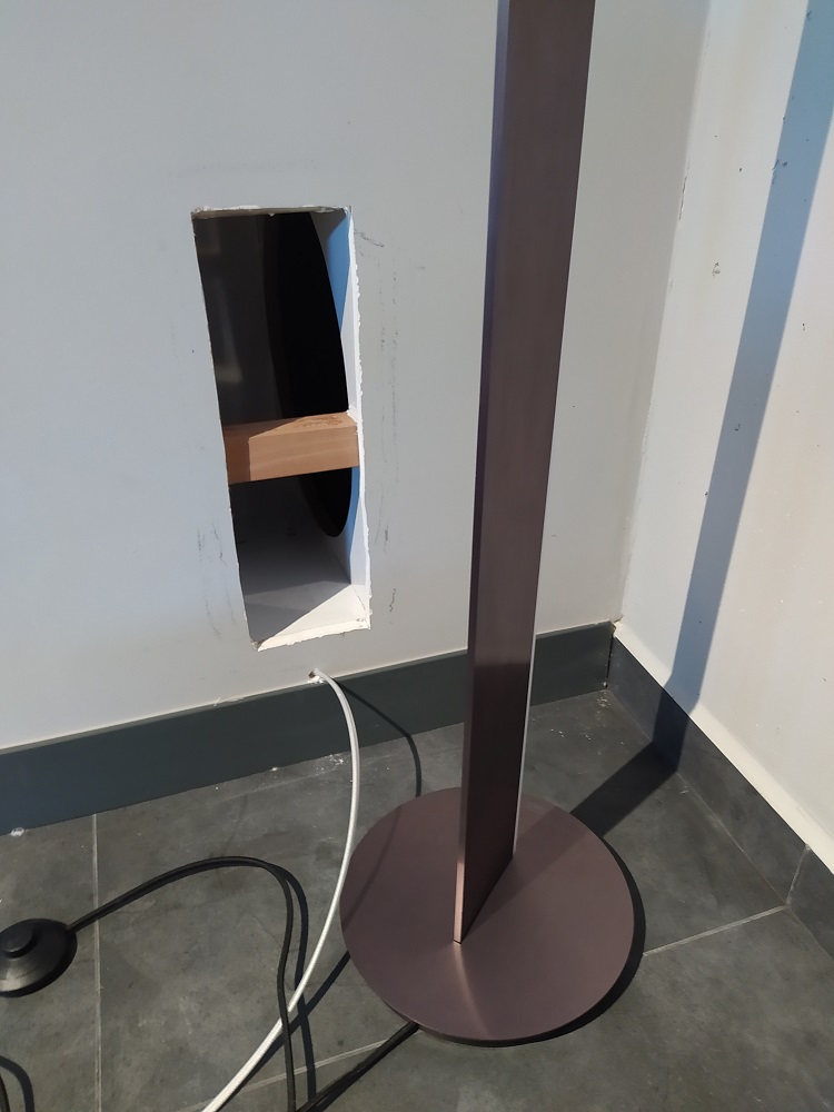

we have an IB subwoofer in the room.
two faital-pro 18fh500 push-push wired to 4ohm... powered by the center channel of the AVR ( i was worried that the class D icepower might struggle with 4ohm but it seems to work ok)
currently SW covers 30-60hz
sounds WWWWOOOOOOOOOOOWWWWWWWWWW!!!!!!!!!!

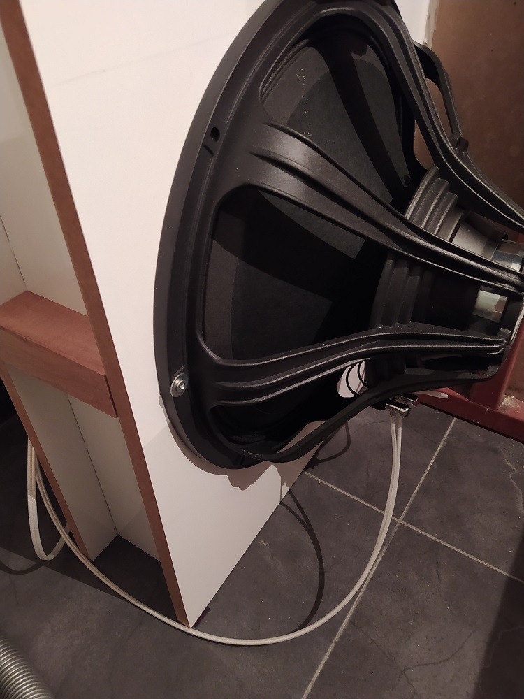

Very interesting. Would you mind posting a picture of the back of the midbass section? Why did you choose the "low H" on the front vs U? Aesthetics, structural robustness, other? Midbass are 18"?
I also have 18" midbasses in the same frequency range, currently on a swing, but your comments are making me wonder
Thanks Adason.
Lewinski, there is a picture of the back in post 45
My midbass is 15" and subwoofer 18".
The frame is not a full U, to somewhat protect the paper cone from accidents.
Yes, I do think that the heavy frame performs better than the swinging, but my experience is not a fully controlled scientific experiment. It needs confirmation by other DIYers too.

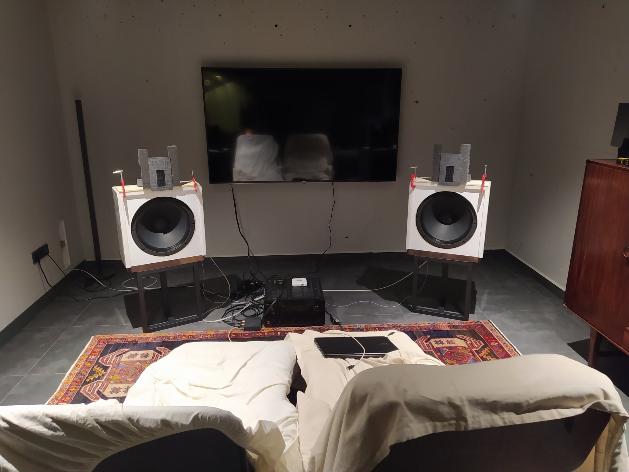

Back to 2 way + sub.
I tried all sorts of xo and eq, but there were always too much ringing in the mid section, IE 4xbmr.
What is different with latest two way? Very low xo point, 400hz 8th order BW. Neo8s handles it no problem even at high volume.
Best effort so far.
Listening to Monolake album Silence right now. Clean sounding system and electronic music is match made in heaven, who knew?
Best effort so far.

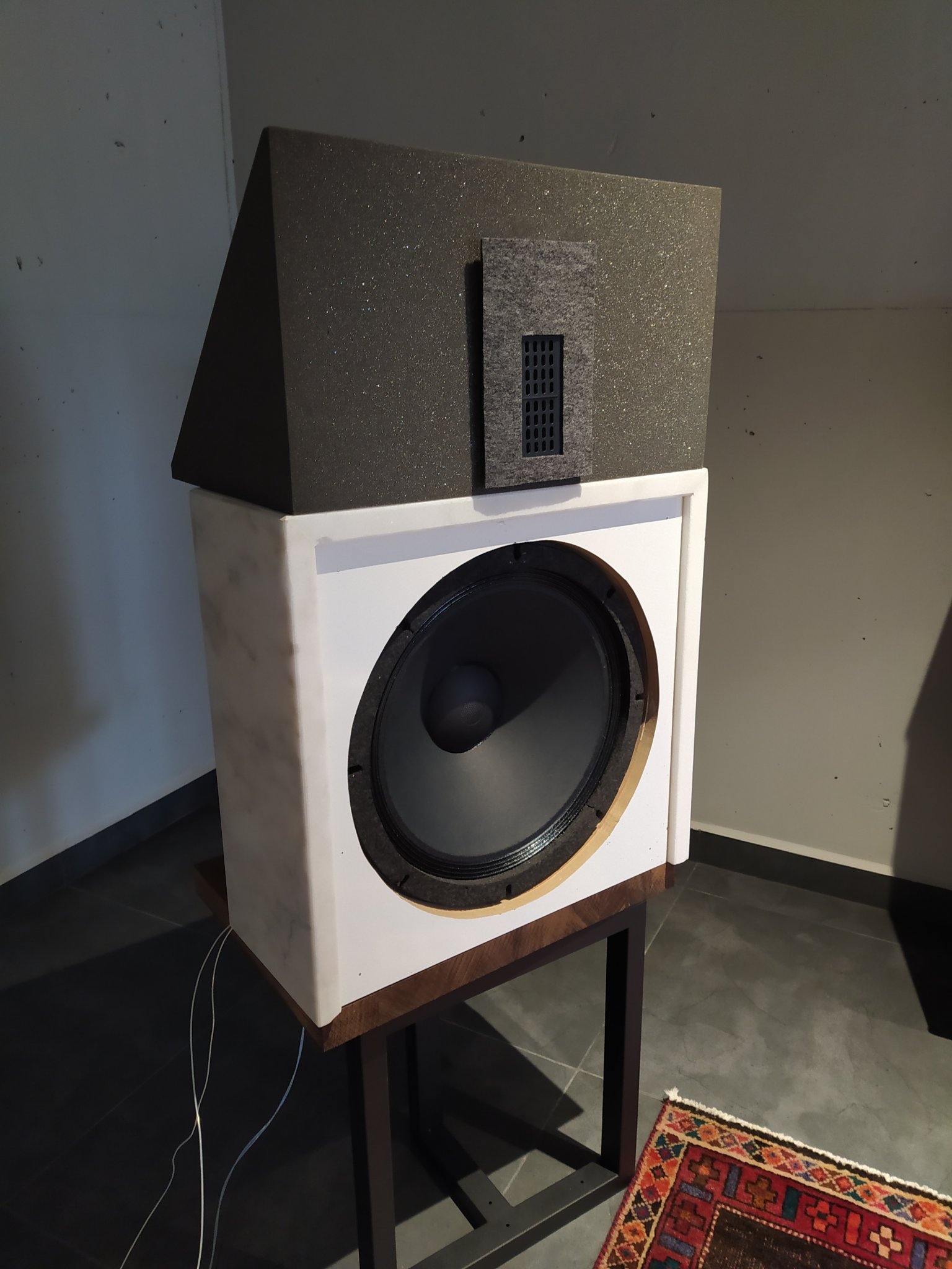

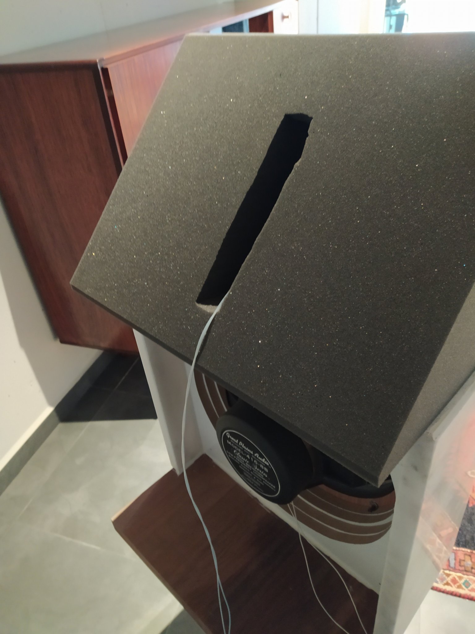

Reporting yet another mod.
Now using a carved acoustic foam bass trap as open back frame for neo8s.
No need for OB loss DSP compensation any more = more headroom.
Crossover point moved to 80hz for sub and 320hz for mains.
C to C distance now closer to 1/4 wavelength = sharper imaging
Happy
Happy

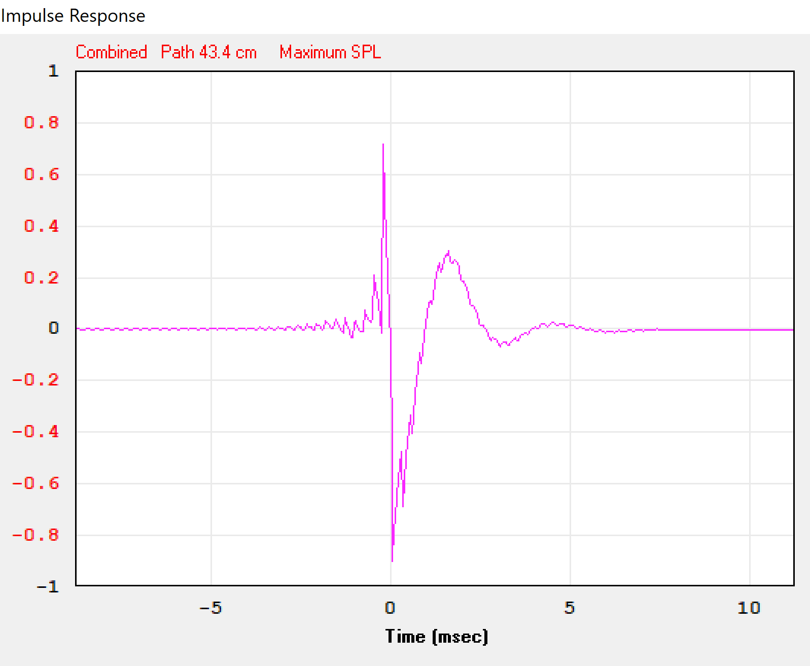

Bass response does fall off below 200hz or so, but it is not a cliff fall. I was able to eq it on DSP, no problems. Plus I now have a IB subwoofer crossed at 60hz. Everything below 60 is cut off 8th order for the 416s. As a result, even with bass heavy music at high volume, the 15" cone does not show any visible excursion.

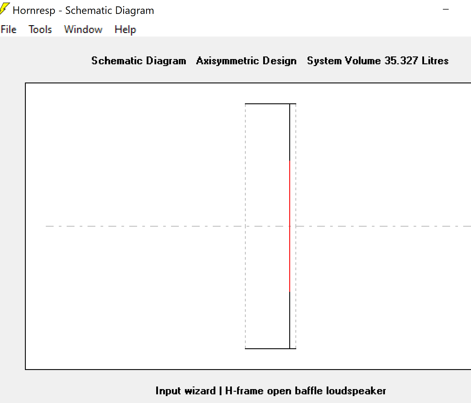

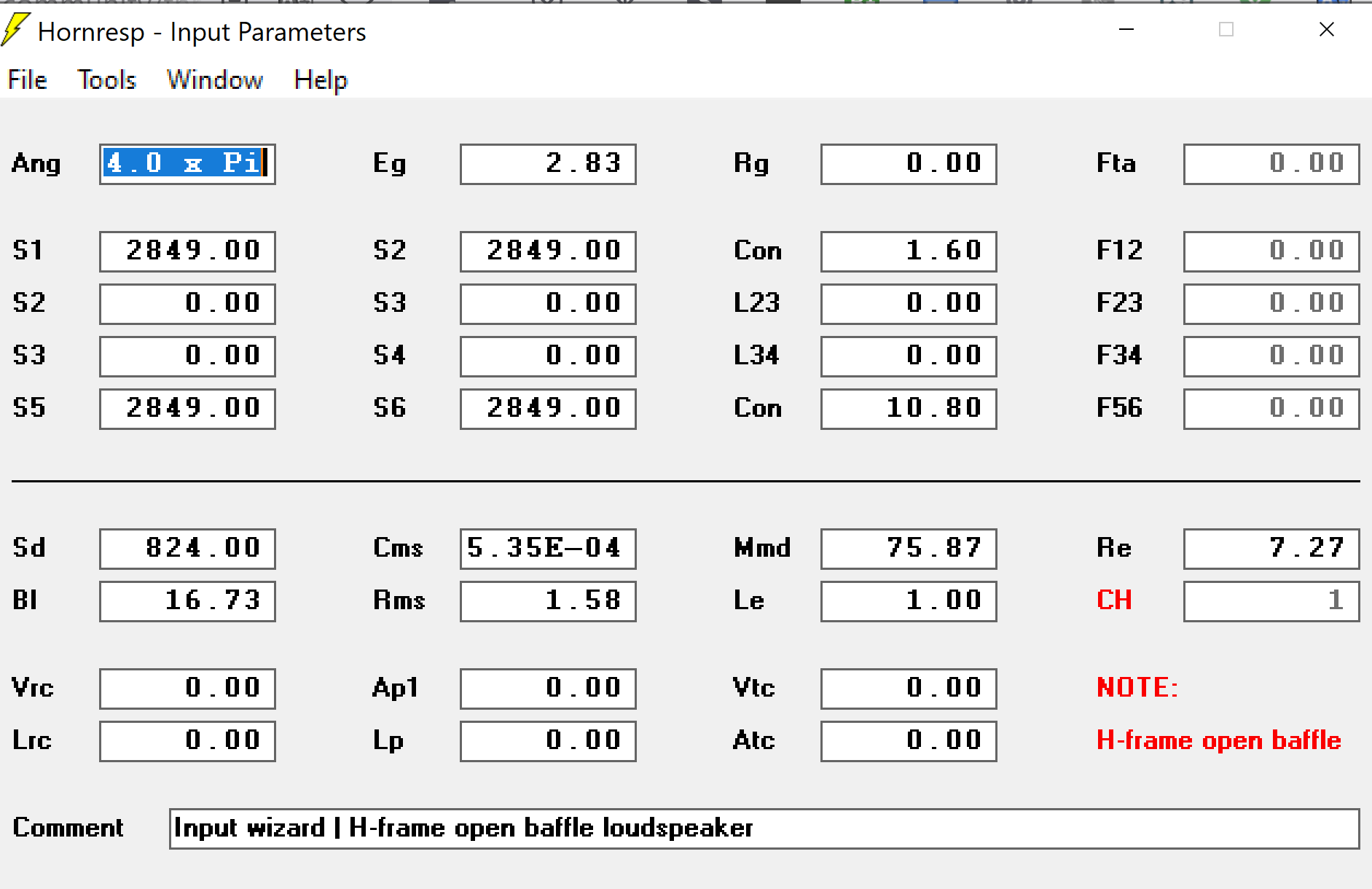

Rough guesstimate only Hornresp sim of your H-frame at Xmax looks good- I guess the IB XO could fill in up to 80Hz as the OB drops off?
An advantage of the small H-frame depth is a cleaner impluse:
but its only guess work:

And all this time, I have been trying to reduce the vertical height of the total radiating surface, to achieve better imaging. 😀
I indeed can't locate the sub. It's push push slot loaded. And with some delay on DSP to time align everything.
I very often listen to music/concerts on YouTube and I do get a very nice center image on the screen and a much bigger overall stage.
