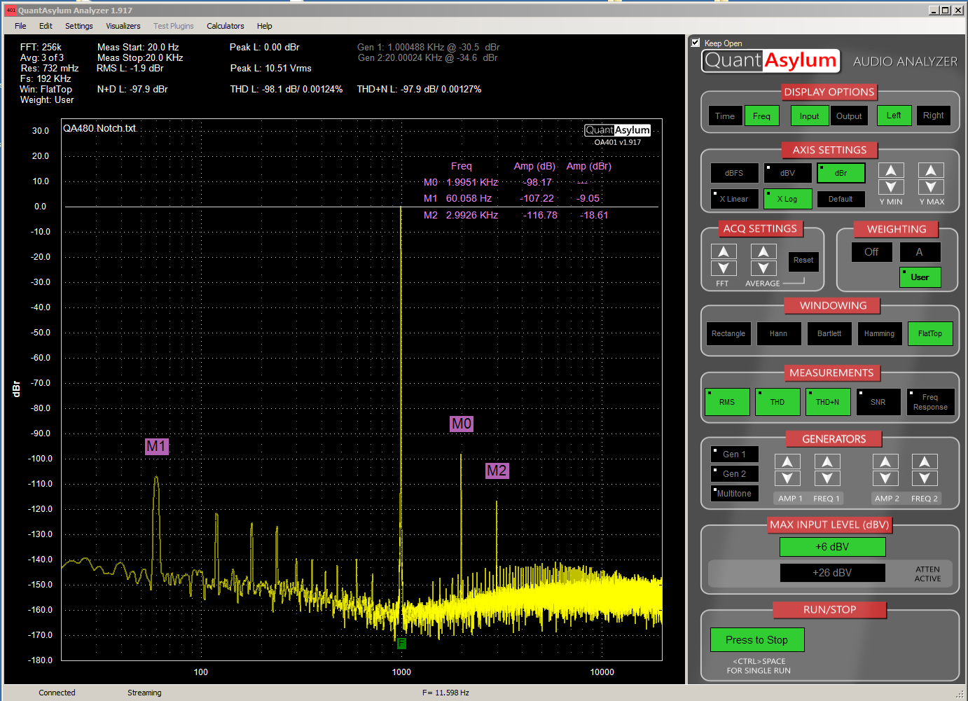

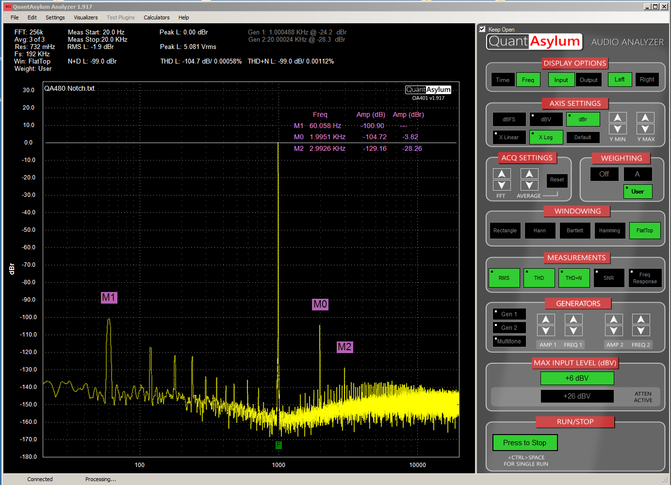

Today I was trying out my new QuantAsylum QA480 that goes along with my QA401. This is a low distortion 1 KHz analog oscillator combined with a notch filter. It's computer controlled, and along with the software now in the QA401, I can measure down to a distortion level of about -150 dB. That's the second harmonic level from the oscillator itself. Only at 1 KHz, but I'm not going to complain. Imagine being able to measure distortion that low with a tiny box that attaches to the USB ports of a computer for way less than $1k.
So, I measured the JC-2 I updated as described earlier. 2SJ103's and 2SK246's at the input and 2SC3468's and 2SA1381's at the output.
The distortion plots are below.
What's amazing, to me anyway, is that the LTSPICE simulation gave:
1 Vrms 2 Vrms
2nd -106 -99
3rd -128 -118
(Sorry for the lousy formatting)
The simulation agrees with the measurement within a dB or two. I guess simulation does work pretty well after all.
The big trouble makers are from the power transformer and the rectifier harmonics.

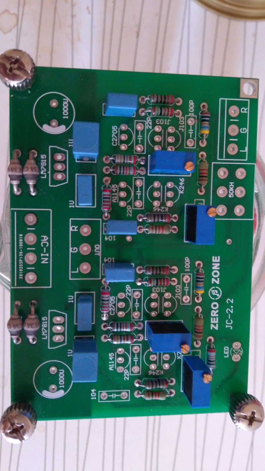

Does anyone have an sharable gerber and/or Eagle or KiCad or pcbCAD720 file for a JC-2 preamplifier?
Here's my Ebay chinese JC-2 inspired pre which I have tuned 🙂.
-Dale RS res (0,5/0,1% tolerance C and E series, non-magnetic)
-Epcos LL lytics
-Silver mica pf caps
-SiC schottky diodes + trafo sec. RC-damping
-Made the pre DC-connected by removing output caps and feedback loop cap that made the feedback AC
-Put the potentiometer from the input to output and changed to motorized pot
-After simming in LTspice removed the emitter follower output buffer transistors, now the schematic is +/- like JC-2.
Transistors in this chinese version are 2SK170/2SJ74 and 2SB647/2SD667. They seem to be well matched, DC offset is 3-5mV pot turned fully open (pot at output attenuates it also). I didnt even install dc-offset trimmer resistor.
This is a very fine sounding pre and I'm amazed how simple and compact the signal path of the JC-2 is.😱
I cannot explain why, since the load is referenced to earth and not floating, but by putting a "rail-to-rail" (between +15V and -15V) polyprop capacitor max locally around the output stage makes the sound noticeably better.😕
