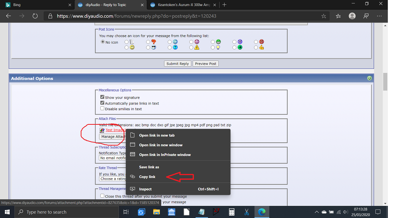

Yes, but how do you insert the image in the body of the post?
Like this:
Upload the image in the normal way and then right click the link and copy it. Paste the link into the post making sure it has image tabs wrapped around it. The link needs to be within the tags like this
Make sure the images aren't to large. You might need to experiment.

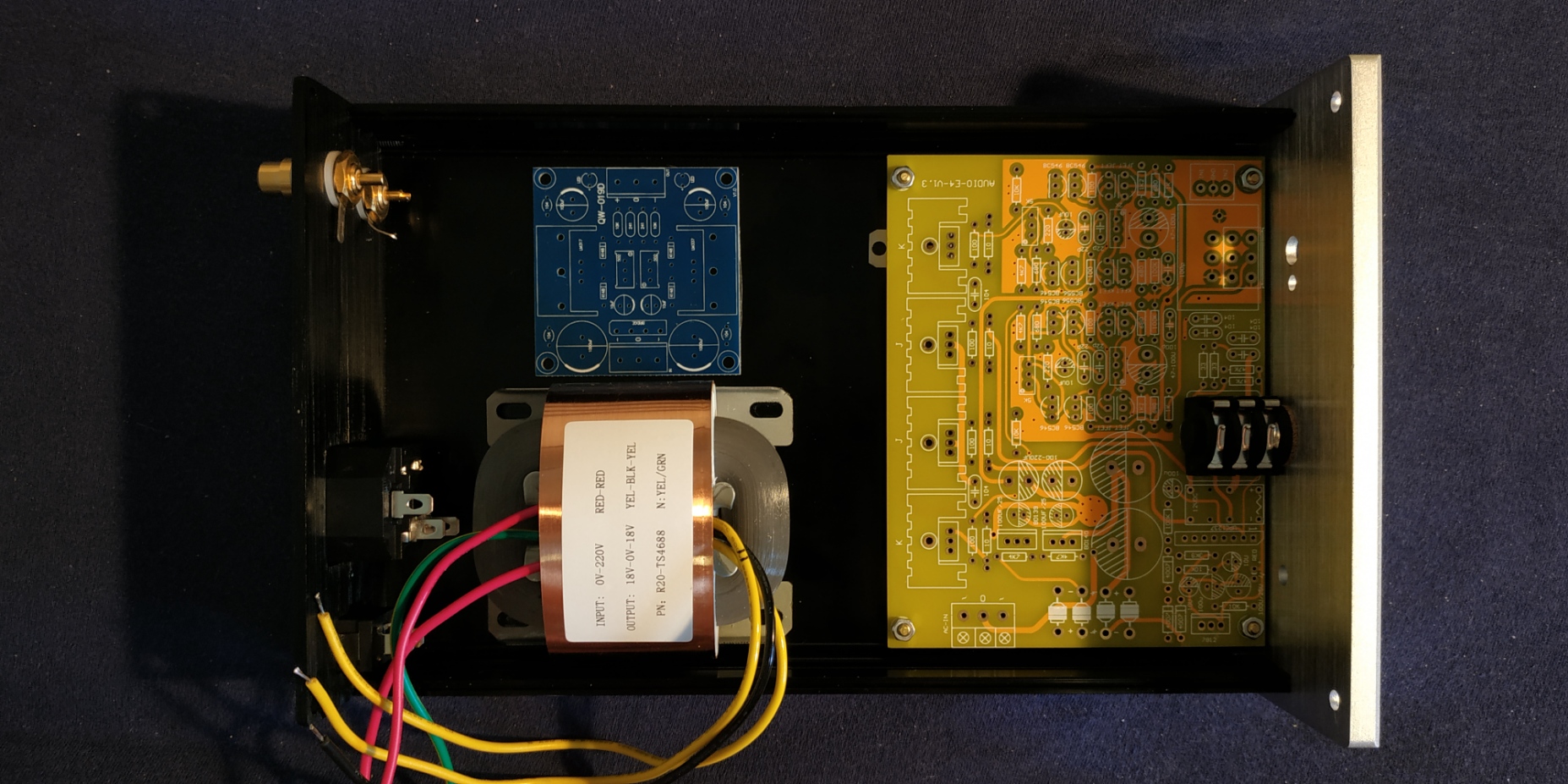

For what it's worth, I've just got this headphone amp kit from Aliexpress, basically a JC-2 with different input JFets and MOS output buffers. I wasn't expecting much, but the matching of the input Fets is a BIG surprise: inside of a ziplock bag, there were 4 n-ch and 4 p-ch with a hand written label : 10.22

I used an E19 board with almost identical circuit. The K2381/J407 are switching MOSFET. I am waiting for a few pairs of Toshiba 2SK2013/2SJ313 from parkit to replace them. I can't say if the improvement is audible or not because the E19 with K2381/J407 sound excellent too. I set my E19 board to 60 mA bias current which is the same as your kit. It keeps my Sennheiser HD600 and HD598 well inside class A operation. The K2381/J407 case surface go to about 40F above ambient temperature when the case is open. It should be ok in any air conditioned room. In class A, it does not get warmer even when you run the headphone in high volume. My headphone amplifier case stays 13-15 degree above ambient when closed.
Good luck and let us know how the project turns out. Do you see their headamp in a completed box? It uses 2 10000uf/60V capacitor for the PS.

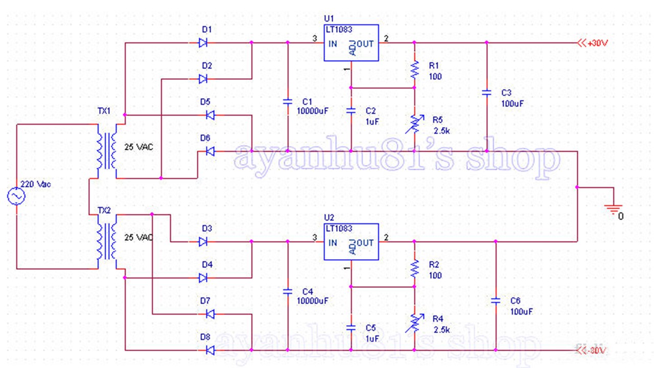

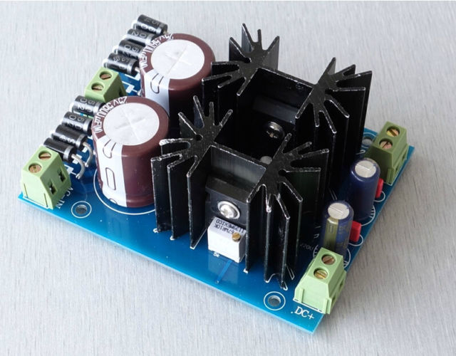

For the E19 I have, I use a twin LT1083 board and set it at +/-21 volts. Your amp has onboard Zener regulated PS which can be easily bypassed.

... Or converted to a cap multiplier to provide some measures of insolation against the nasties from the regulator. JC's been doing that since forever.
