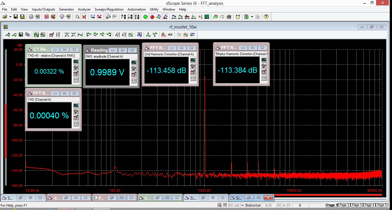

and fwiw here it is without this preamp .... so just a loop through

I tried to find more 'problems' with my unit, but I could not find any extra pickup above 20KHz. I first thought that the case might not be connected to the system ground, but it is. Still, there is room for improvement in many of the parts, wiring, and grounding. The improvement will not be overwhelming, but it can be noticed with the best playback equipment.
One of my associates, HAS found the oscillation problem with the JC-2 clone that is both system and adjustment dependent. I simulated the basic circuit on LT Spice and found a potential problem, which can be fixed by adding 20pf (hopefully mica or polystyrene) between the 2 output transistors base-collector (output) junctions. This was left out by the builder, and needs to be included to keep this circuit from going unstable in some situations.
