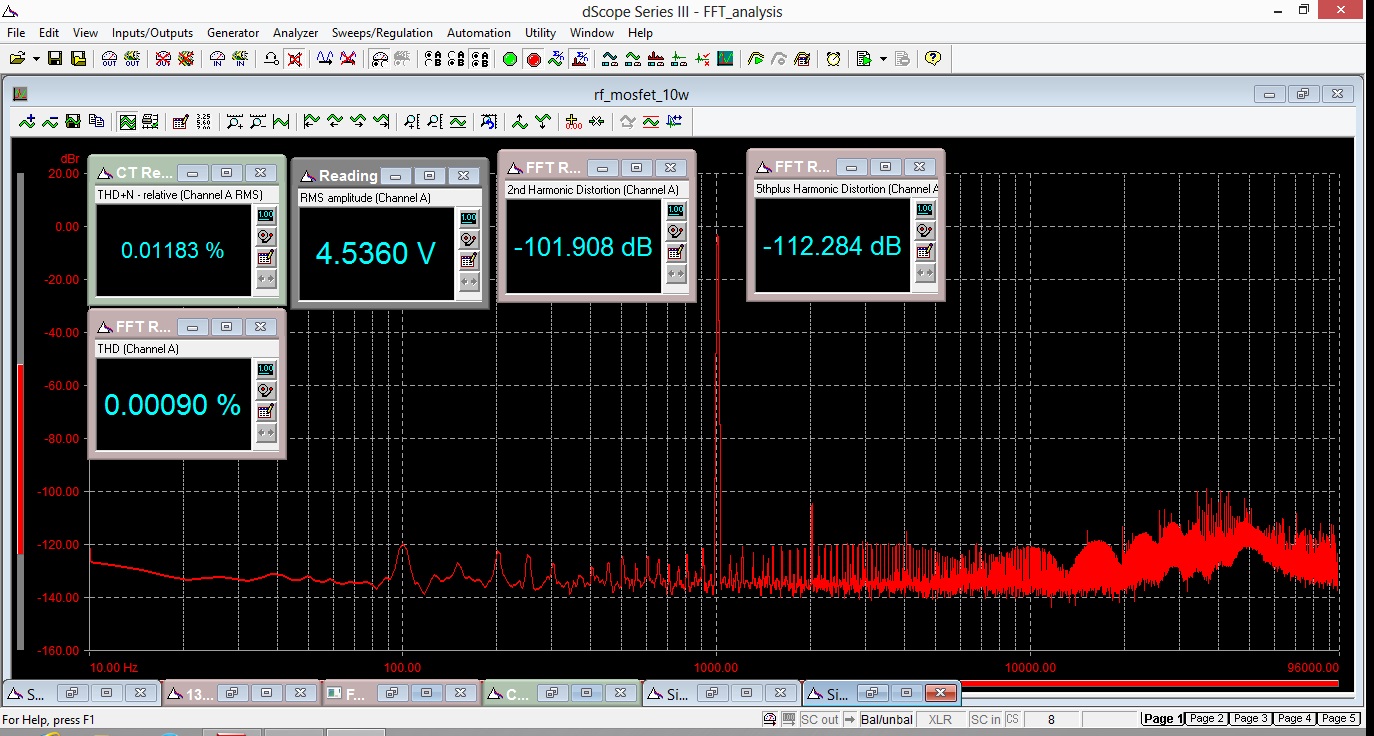

What was odd though was the amount of noise - most of it >20khz but it doesn't seem to be mains borne so I don't yet know it's source. It's clearly evident even with a good mains filter and didn't go away even when the measurement was carried out with the mains unplugged (ie. during the 10 secs or so before the caps discharged.) I intend to power this preamp with a known good lab PSU to confirm the issue.
If it's not main related, then the noise might be oscillation of some kind.
I saved some curves when i had this on the test-bench so I can put some results here in the next few days (am traveling) in case anyone is interested.
Thanks JC for the circuit and the generous tip - now for a bit of work to get rid of the hash. If I can definitively rule out the PSU, this will take some doing.

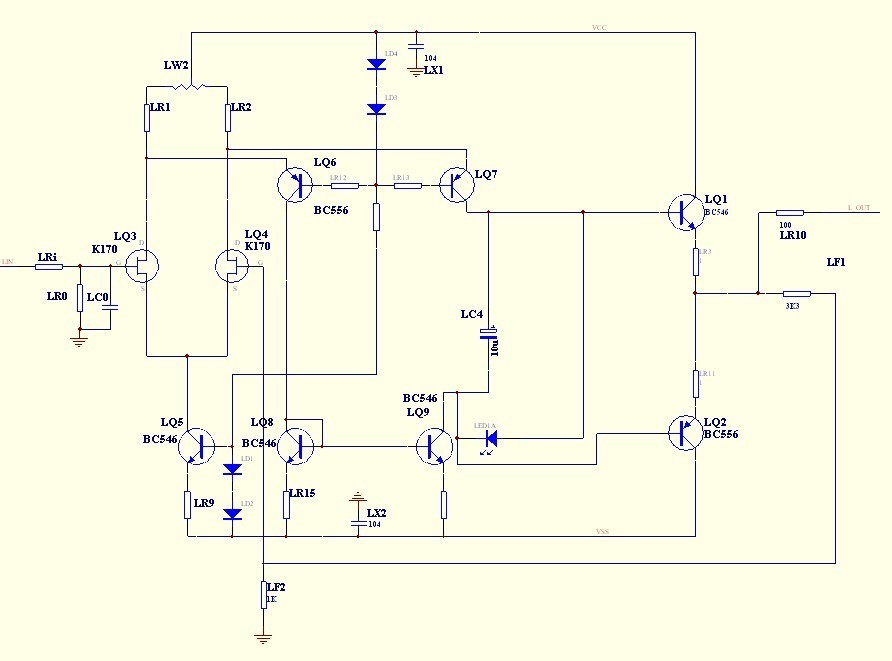

The circuit uses the classic Marantz front-end circuit, warm mellow tone. Plump natural addition, low dive and jumping ability are better than the JC-2 preamp circuit,

The Marantz might be improved adding a cascode on the LTP above the FETs.
Apparently it zeroes DC offset with the trimpot above, but does it hold with minimum offset?
Encapsulation of both or dual LSK might secure offset. Interesting design.

Max, the 'Marantz' circuit is a pretty good deal, also. It is like a simple discrete version of the AD797.
Why I recommend these sorts of designs is that they are low open loop gain, which implies high open loop bandwidth, can be Class A throughout, and basically balanced, partially cancelling the even order distortion generated by the devices.

Scott if you have time to take some measurements and post them it would be great. Mine seems to exhibit a lot more noise than one would expect.
With a 80KHz bw I am seeing about 6mV RMS of gunk ....see fft below.
And unless someone else can do some measurements, I will assume that this is just specific to the unit that I have. It would be nice to have someone else confirm or otherwise 🙂
I won't be tweaking this until I can get the basics working well.
P.s. the results below are after mains isolation and AC line filtering.
Ignore the H2 and 5th+ harmonic calcs in the 2 boxes on the right.
