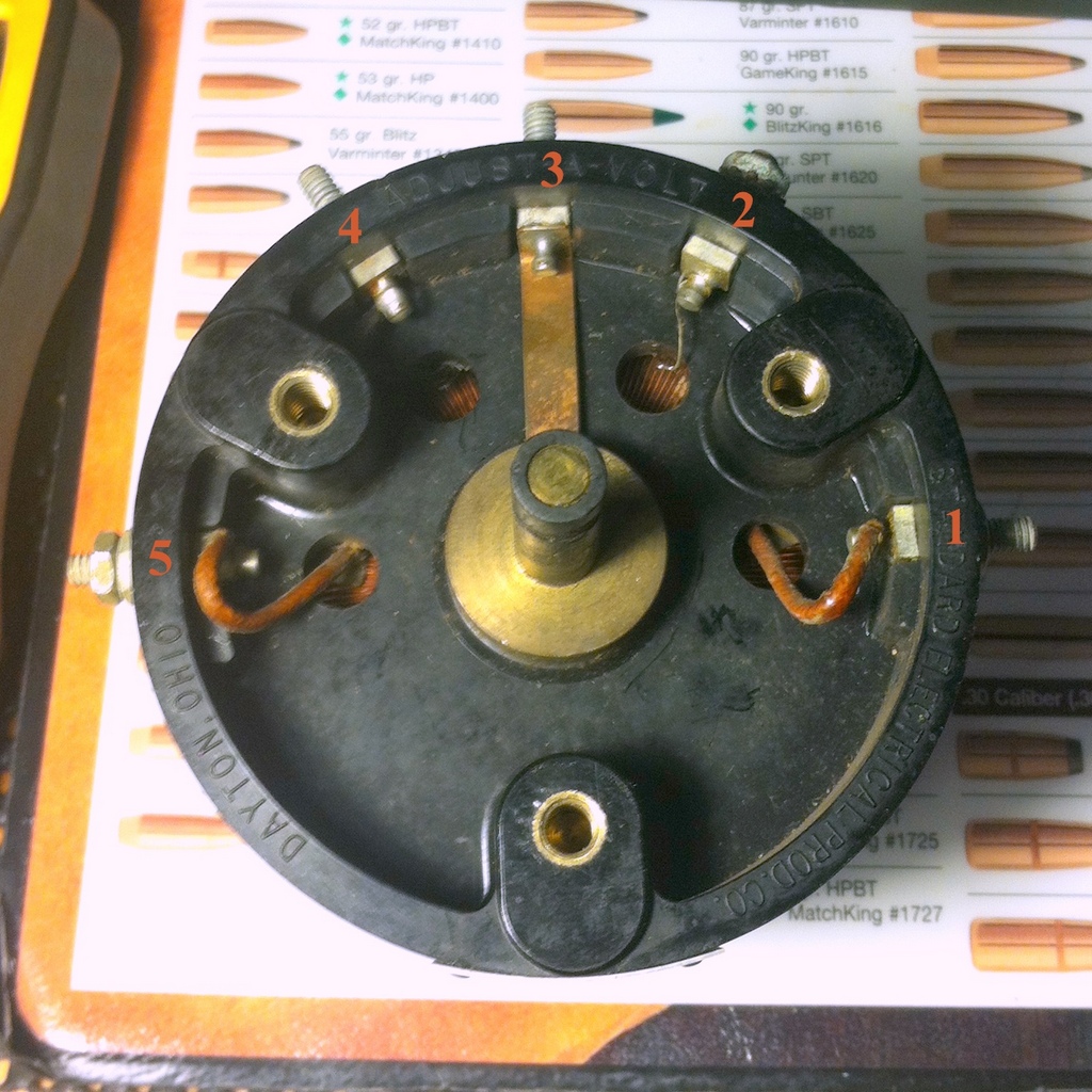

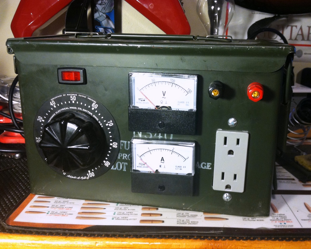

I recently acquired an old Standard "Adjust-A-Volt" variac which I've rigged up in a case with volt and ammeters output plugs and posts, to make it useful for amp work.
My problem is that I can't seem to figure how to wire it correctly to get the voltages out that I'd expected.
This one is a little different than some I've seen in that instead of a single panel of numbered terminals, it has 5 terminal posts arranged around one half of the perimeter of the transformer body. But they're numbered 1-5 so I thought my job would be easy.

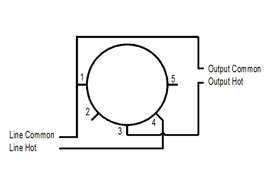

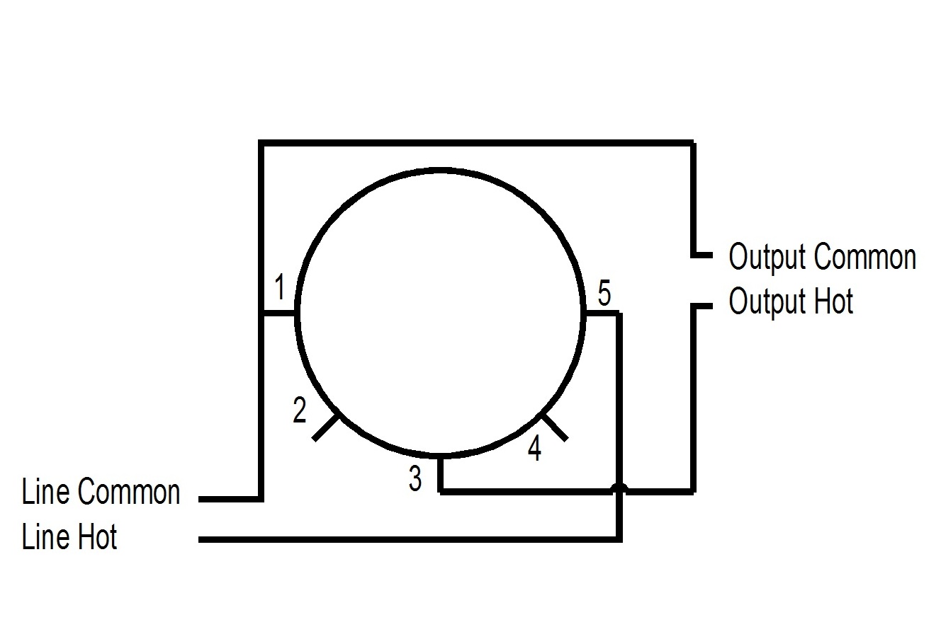

Based on reading a lot of threads on variacs, I figured that if I wired it like this:
attachment.php
I'd get out a linear voltage rise from zero to about 140V.
Well, that t'aint what happened. 🙂
What I get out is 20V at the 0% setting, which drops to 0V as I bring it up to about the 15% mark. Then it starts to rise again and tops out at the 100% setting giving me my full house voltage of about 122 V.
Ok, so that's not the end of the world. I at least can get a smooth 0-122V range, but it bugs me that it's not done correctly and I get this bit of opposite phase voltage at the bottom of the range.

The one thing I think I'm sure of, is that there is a big copper bar running from Terminal 3 to the center shaft, which makes me somewhat confident that 3 is indeed the wiper, as every other Variac I've read about.
Can anyone help me get over my mental block and see what's going on? How should I wire this thing?

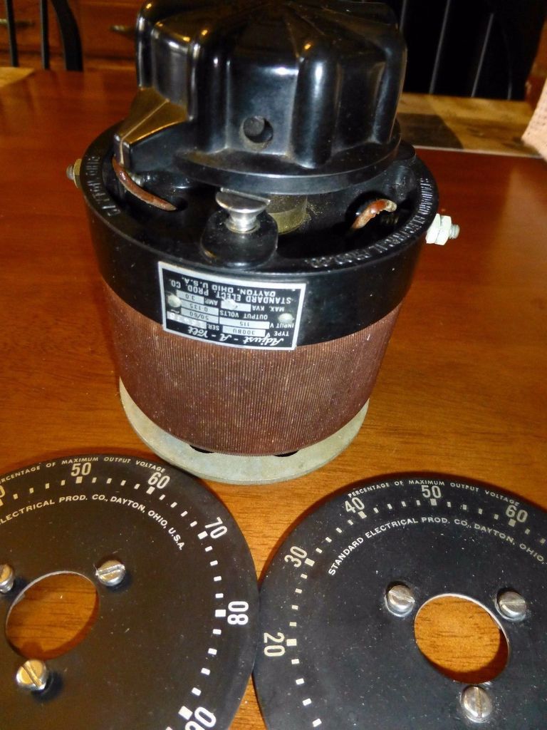

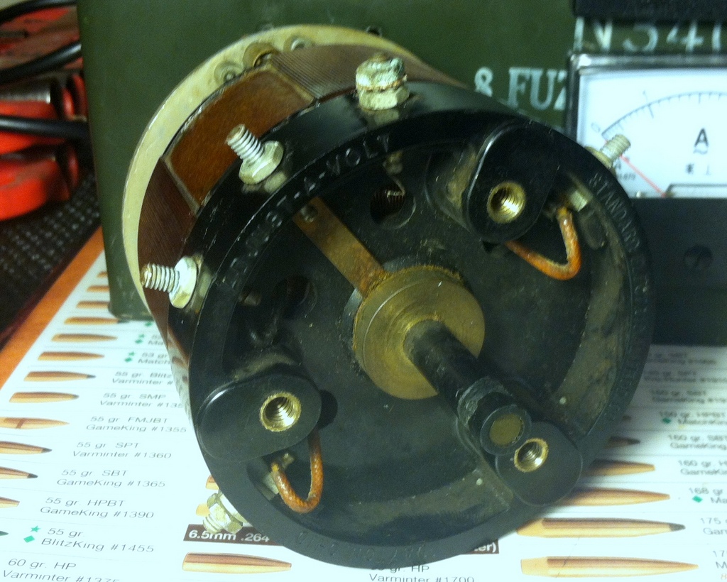

Here are a couple of pictures:
attachment.php

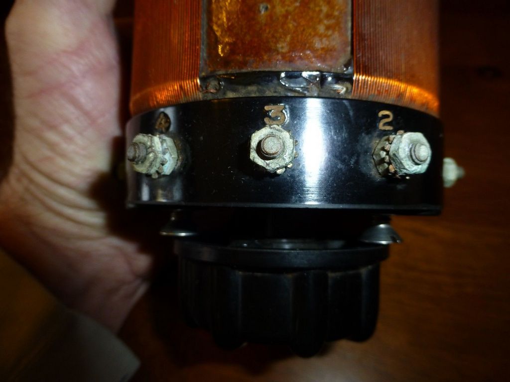

The terminals:
attachment.php
And the terminals from the rear, centered on "3" which I believe is the wiper. (You can see the copper strip that runs to the center spindle.)
attachment.php

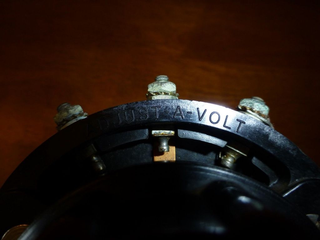

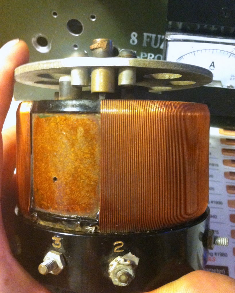

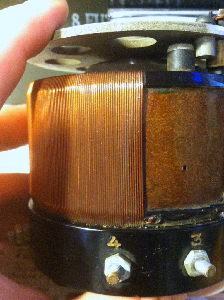

OK!
Here are some more pictures.
A better view of the front of the device, showing the terminals and their leads down into the winding:
attachment.php
A general shot:
attachment.php
With the wiper turned all the way to 0%, it actually seems to line up with Terminal 2, giving me a glimpse at why I'm probably seeing these weird readings:
attachment.php
And here's where the wiper would stop if I turn it to 100%. Going PAST 5, around to 4. Maybe it's just that the numbers don't correspond at all to the numerical percentages of output and I was too silly to grasp that before... 😱
attachment.php

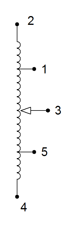

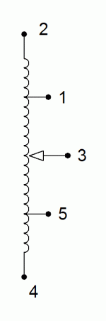

Ok
You have maximum voltage betwen #2 & #4 ...these must be the 2 end of the winding
A low voltage betwen 1 & 2 so #1 must be a tap close to #2
Alow voltage betwen 4 & 5 so #5 must be a tap close to #4
#3 is the wiper
So neutral of the source and neutral of the load should be at #4 ( 2 wire on this one )
Hot side of the LOAD at #3 with a fuse selected according to the variac nominal current
Then the mains ( HOT side ) connect to #2 with a second fuse selected according to the variac nominal current ... and output voltage will be ajustable from 0% to 100% ( no overvoltage possible )
To make overvoltage possible move the main from #2 to #1 ( dont forget the fuse )
