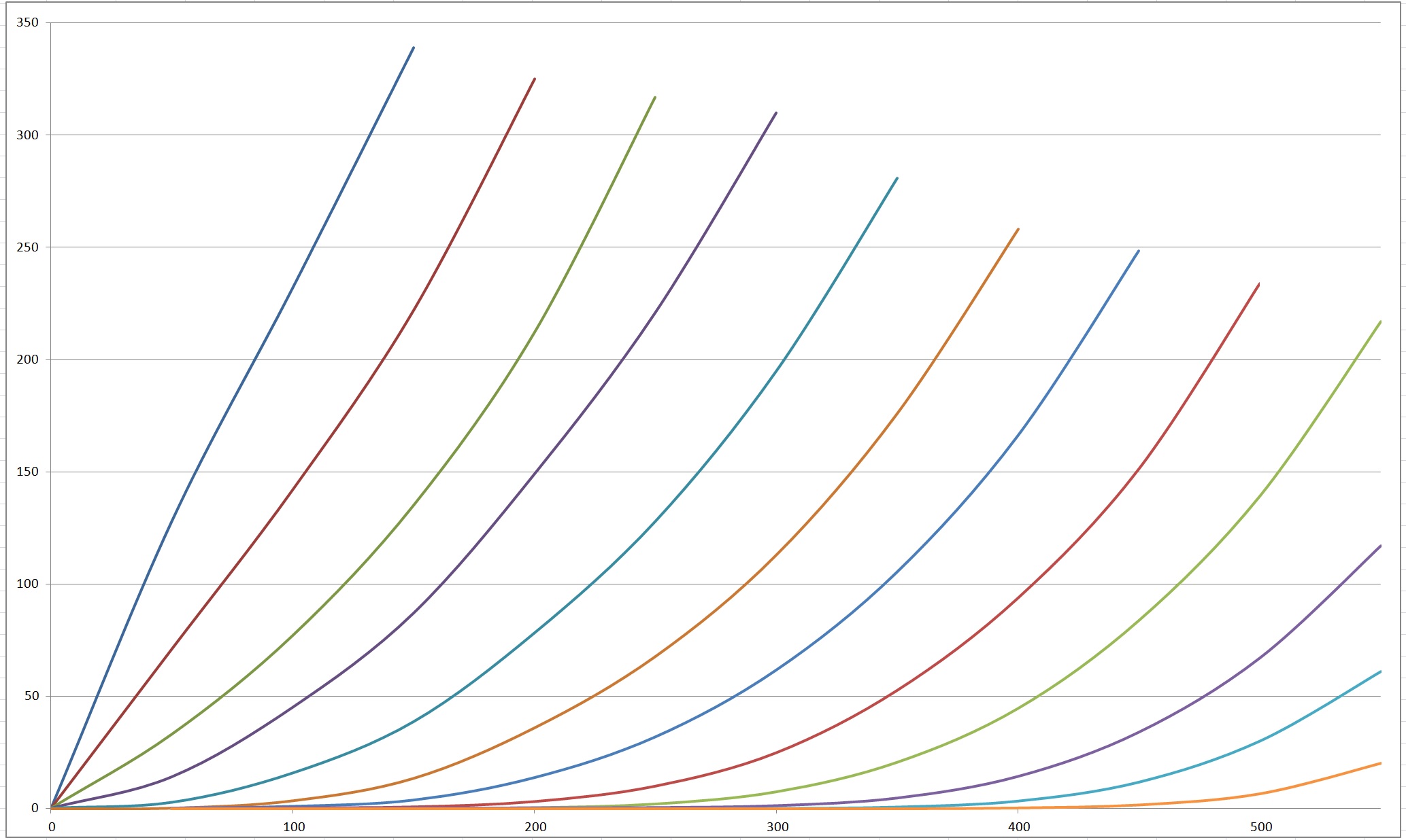

I have worked on that idea off and on for several years and it's finally beginning to show some promise. Here are the curves plotted manually for a $1 TV sweep tube. I was taking measurements with cheap meters while turning knobs on analog power supplies, hence the slight error in the position of the purple curve 4th from the left. Why mess with UL when you can "make" triodes like this out of $1 sweep tubes!
