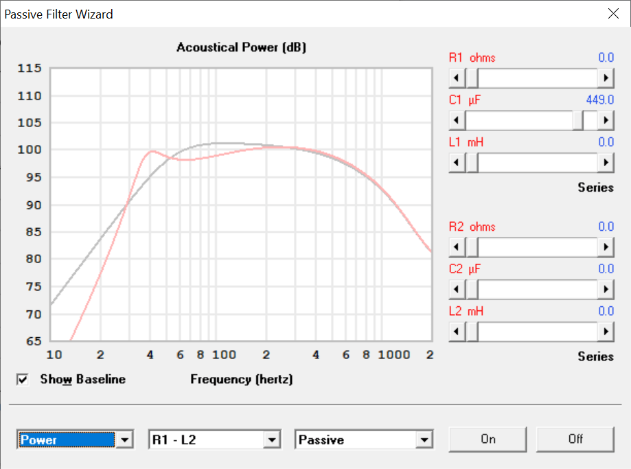

"3rd order" capacitor boosted alignments probably work best with high-ish qtc sealed boxes.- but you could try the magic 450uF for 8 ohm cap to see and hear what happens - it can push the woofer quick to xmax - the "boost" occurs from the combination of lowered Z at the peak area pulling more current and driven by an ~ constant voltage source - so would do about nothing with some zero feedback tube amps
If you know / measure your woofer's parameters and box volume then you can use hornresp - Filter Wizard - "passive" to calculate the "3rd order" sealed box'.

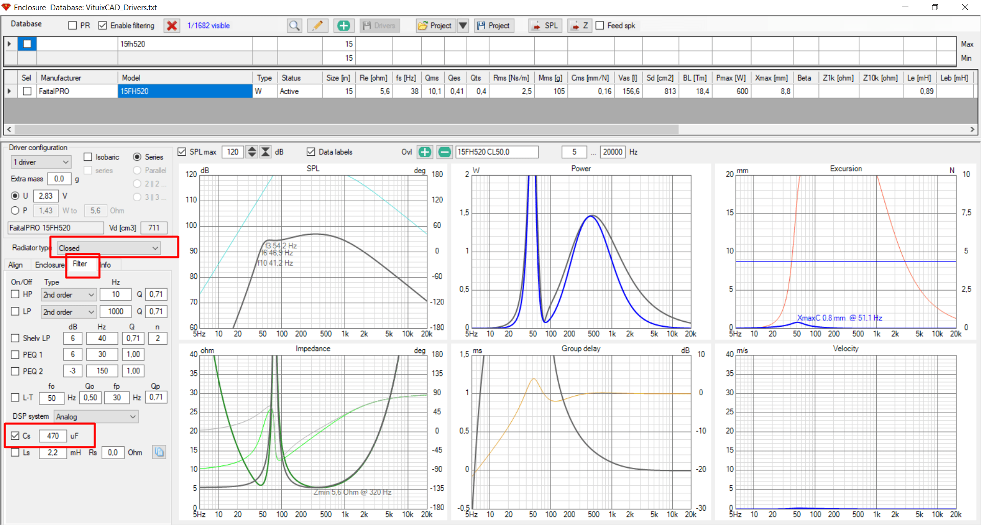

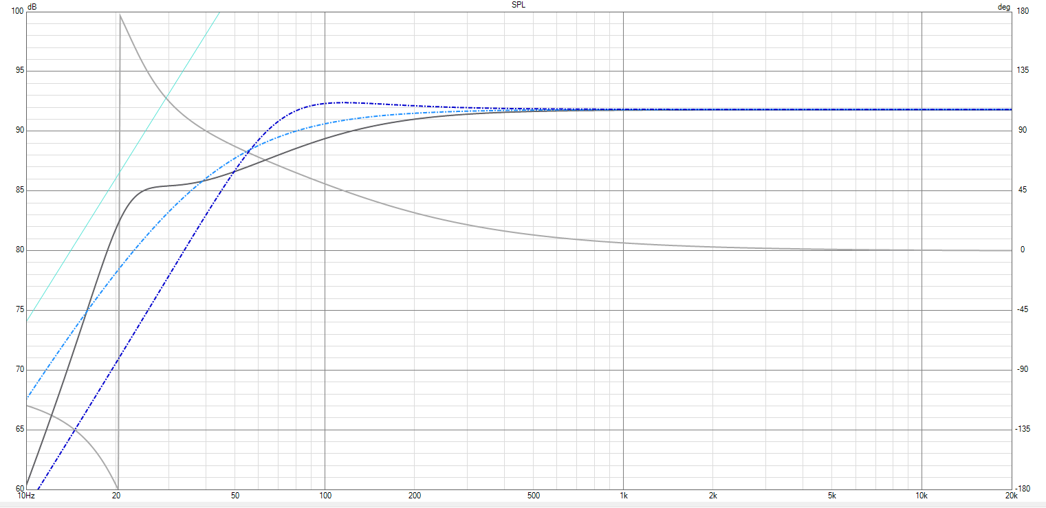

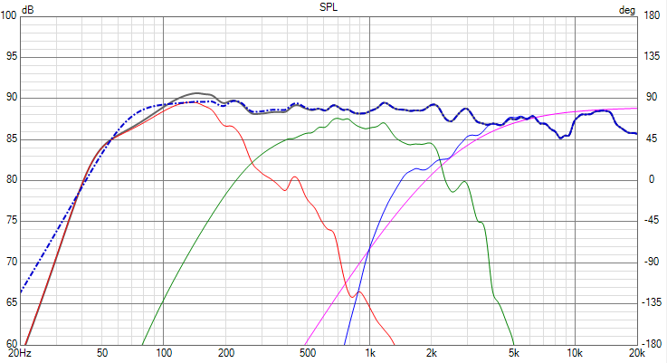

I've tried simulation in VituixCAD as @tmuikku suggested. Here is the result.
The light blue line is Q = 0.5. (Original design)
The dark blue line is Q =1.0. (Assume to be target)
The black line is Q = 0.5 with a 1,500uF capacitor in series.
It's likely that it might not follow the theory because the response was boosted at below 40Hz. Above 40Hz was slightly reduced. I'm not sure if my interpretation is correct. Please advice me.

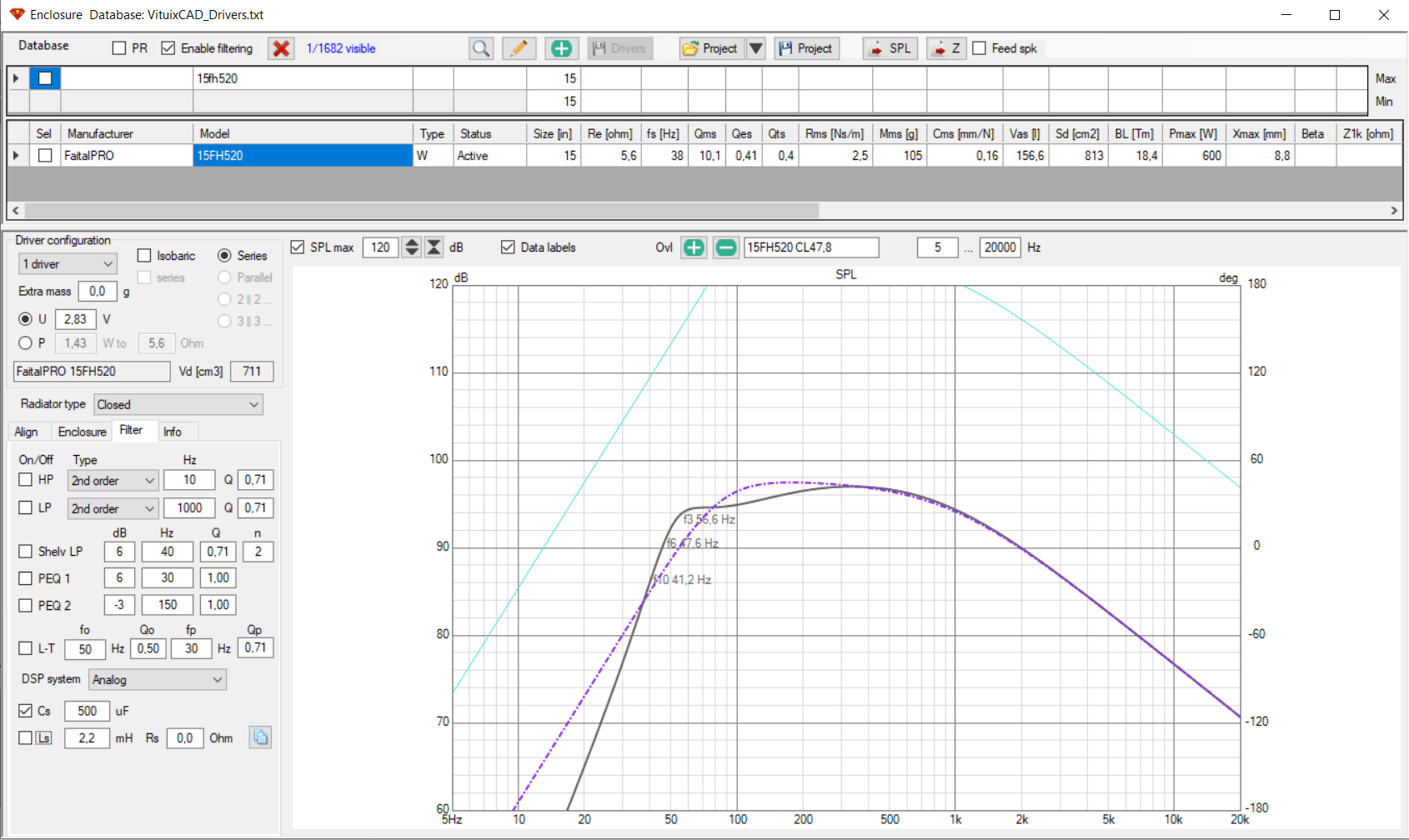

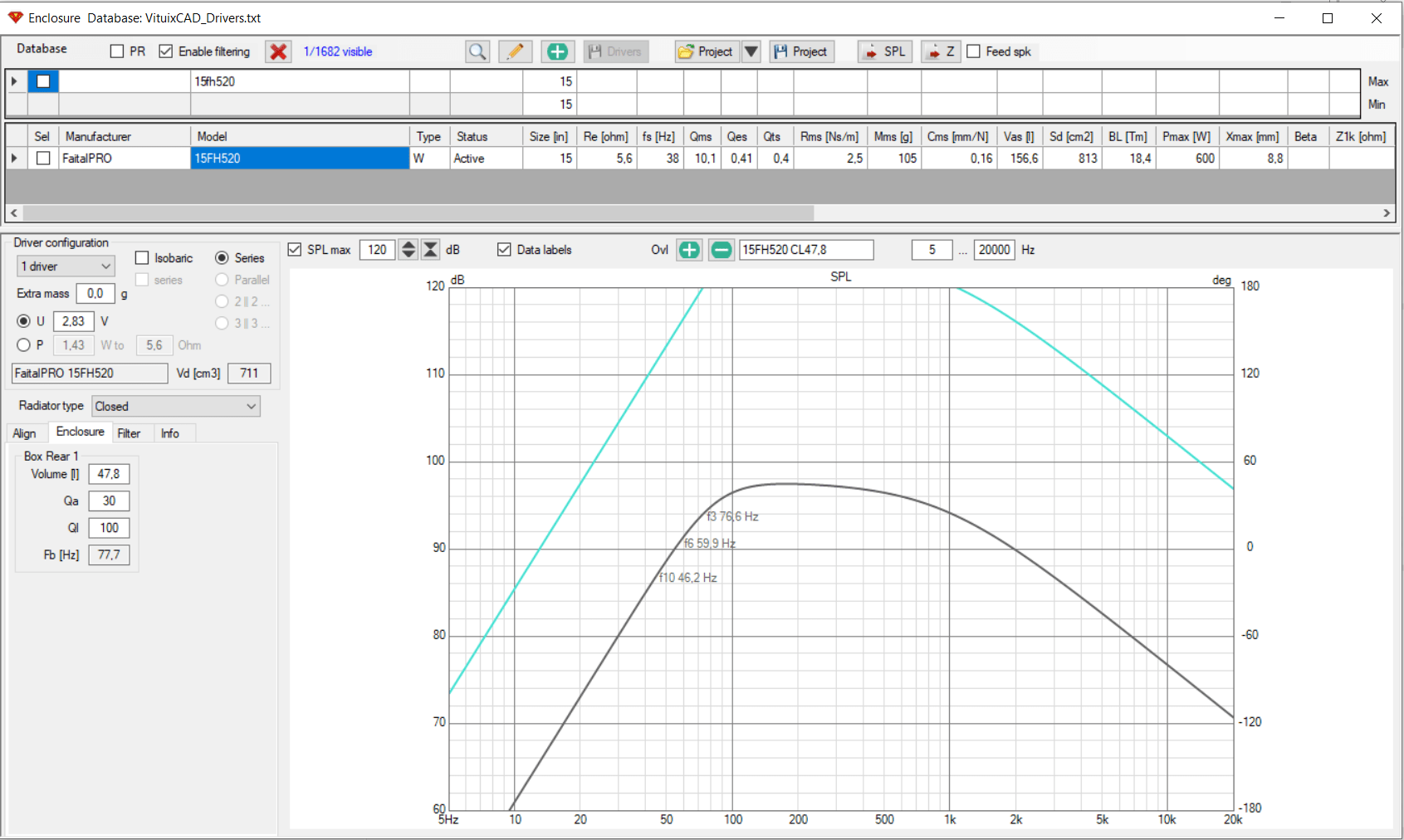

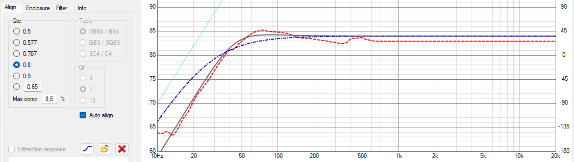

Just vary the Cs value and you see how it works, and if it's useful to you. The smaller the capacitor, the higher the impedance at some particular frequency.
What the series cap allows to do is use somewhat smaller enclosure. If you want to match some target response, adjust both the cap and enclosure size. If you want to keep enclosure size constant, then you must change driver and the cap to meet a target.

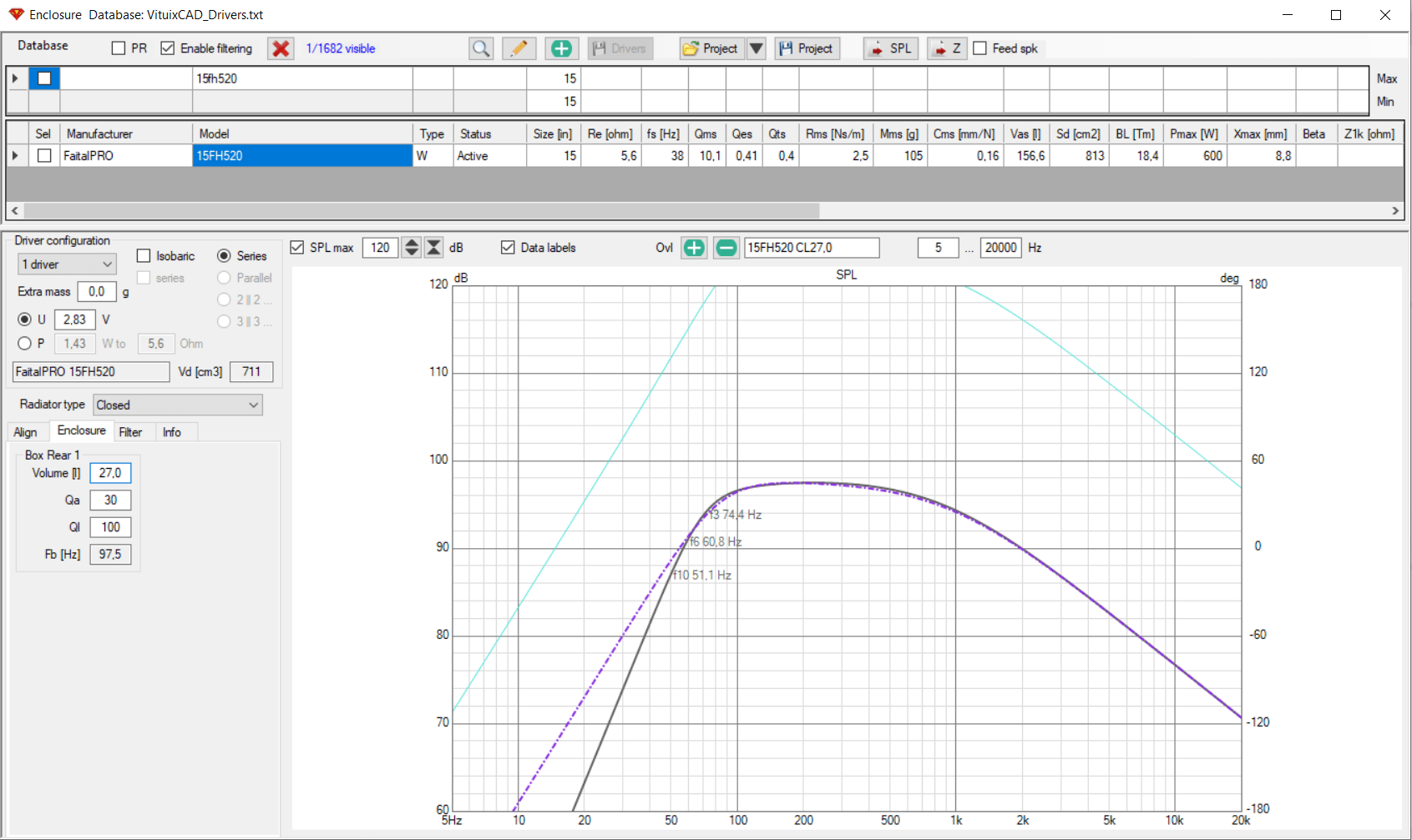

Some random example:
a driver in 47litre closed box has system Q of 1
Adding a cap "extends" the lows a bit
Or, I could almost halve the enclosure size with added capacitor to reach similar response as Q1
Whether series capacitor is useful depends on what you want to achieve. If you can use any sized box I don't see why you'd need a series cap, for example. You could build a magic box though, a capacitor allows you to vary your system response, an EQ 😀 Don't tell anyone it is an EQ.

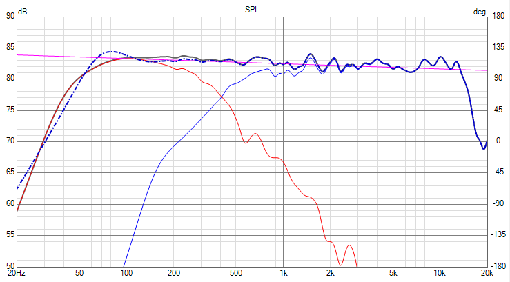

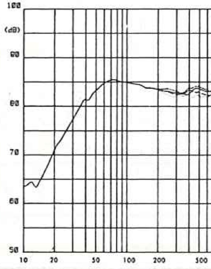

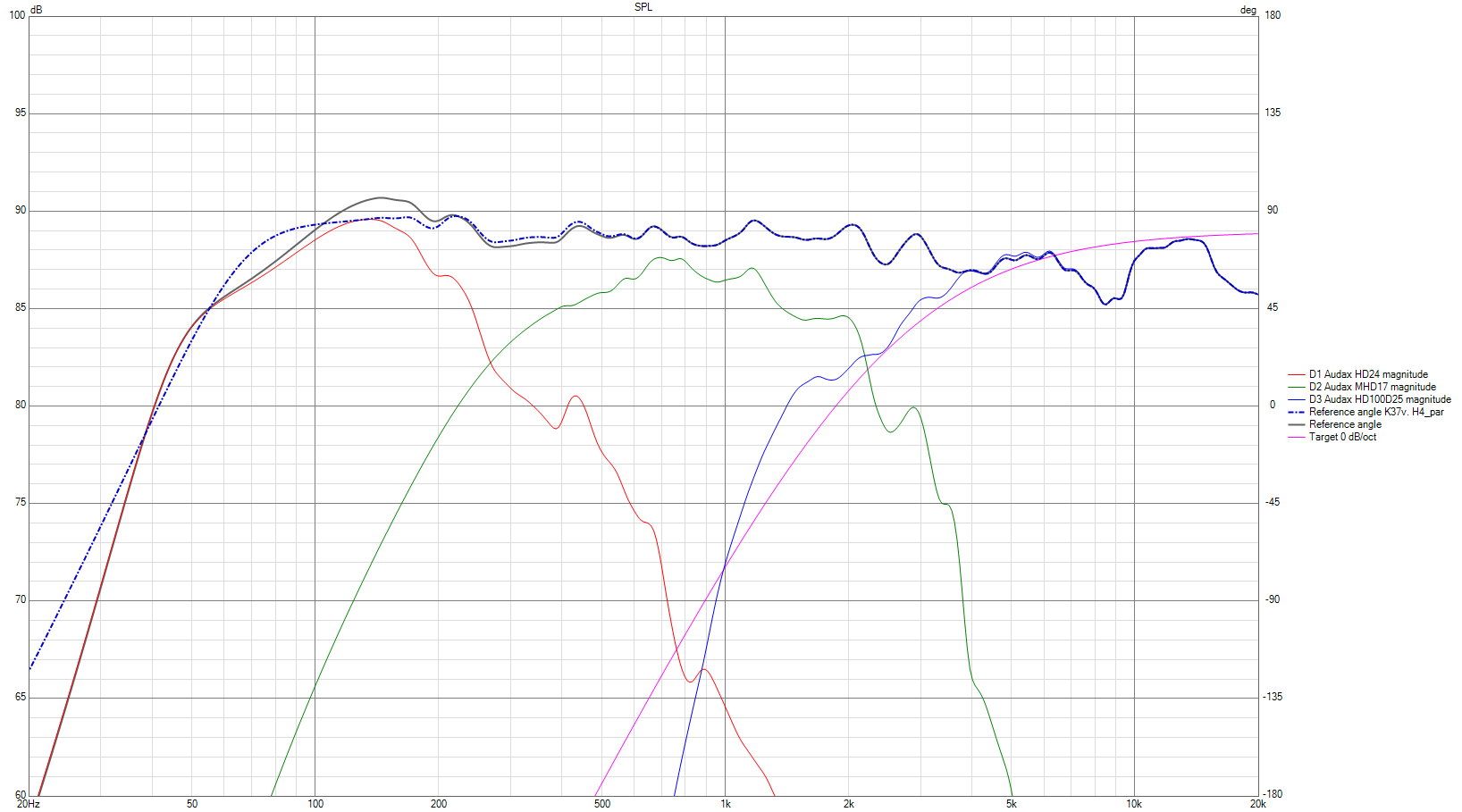

Sometimes the series cap trick works, sometimes does not and the results are not optimal for any value you try because there is interaction with the box volume and the speaker impedance.
This is my first ever speaker in the '80s, an Audax HD24 driver in closed box, a typical system (like yours). You can try any value you want and this is the best you can get with the cap (solid line).
The trick has also been used by Kef in the past. In this case the FR it's better with the cap (solid line).
