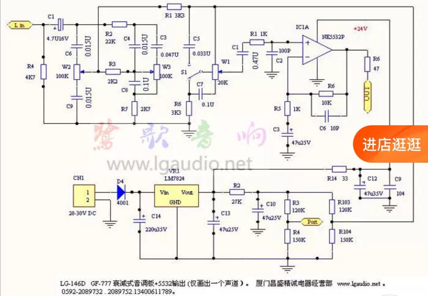

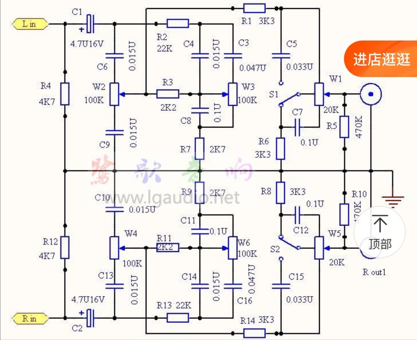

Here is one more I recently added to my collection of schematics to try.
I found this on this forum buried in another thread.
https://www.rfcafe.com/references/e...s-control-electronics-world-december-1963.htm
Believe me. 95% of all loudness circuits don't work. Probably because people don't know what it's about, even Yamaha has some circuits in their devices that work poorly. It's a tough subject. The circuit in https://www.rfcafe.com/references/e...s-control-electronics-world-december-1963.htm isn't bad, but it's also pointless because the pot offers no signal offness.
Could you point to the other 5%, (the good ones )95% of all loudness circuits don't work.
Excuse my ignorance, what's "signal offness"?. The circuit in https://www.rfcafe.com/references/e...s-control-electronics-world-december-1963.htm isn't bad, but it's also pointless because the pot offers no signal offness.
I was planning to build that very circuit and still am. It will need a buffer before and after. I don't quite catch why a separate sub control is needed though. The lower frequencies are automatically covered, It is easy to simply bypass the loudness with an DPDT.Believe me. 95% of all loudness circuits don't work. Probably because people don't know what it's about, even Yamaha has some circuits in their devices that work poorly. It's a tough subject. The circuit in https://www.rfcafe.com/references/e...s-control-electronics-world-december-1963.htm isn't bad, but it's also pointless because the pot offers no signal offness.
I owned a Yamaha receiver in the late 70s that featured the circuit I am trying to recreate. At that time you set a reference volume level and had the loudness correction at minimum. Thereafter you left the volume alone and used the loudness to control the "volume".

That looks good! Simple too, and no unobtanium parts.
It will need a buffer on both ends.

In China a taobao store called Lu-ge (osprey song) has a huge selection including about a half-dozen loudness circuits. Some are based on Sharp GF-777. I have one and it sweetened the trebble (as some speaker XO did) without noticeably losing transparency. The passive version with defeat switch may lose too much gain if there's no preamp.

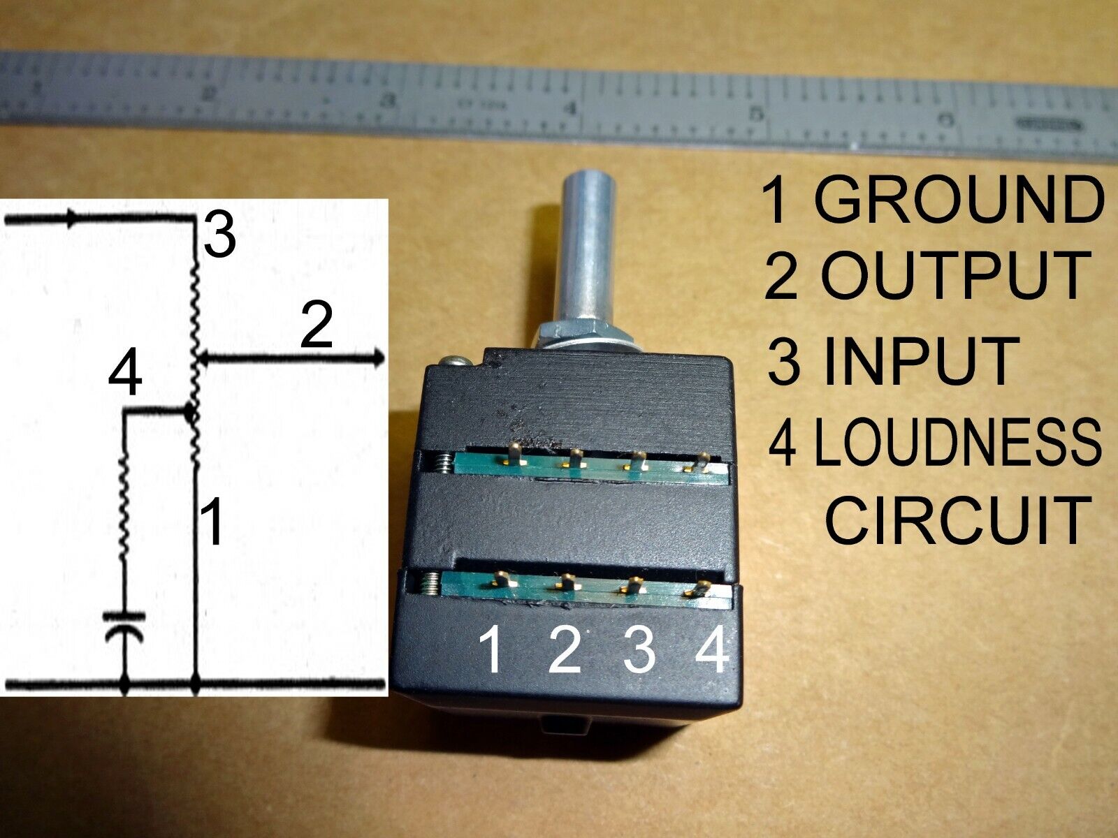

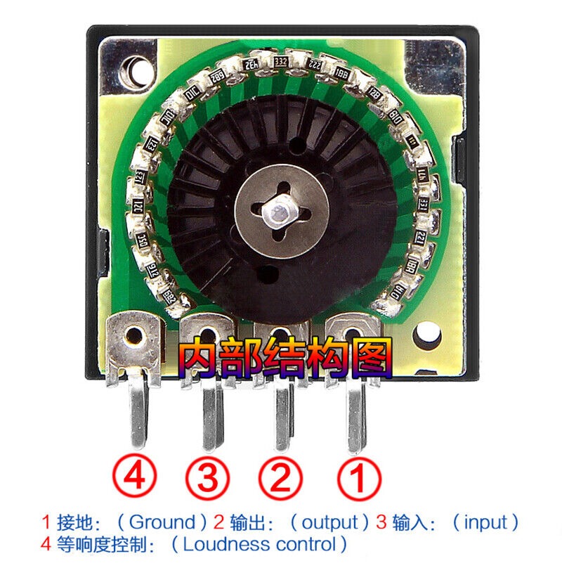

I want to know the manufacturer of this potentiometer - it isn't Alps. Maybe still available from other suppliers.

one of the pots (NOBLE) under
https://www.sup-audio.com/html/potentiometers.html
and
https://www.hificollective.co.uk/potentiometers/noble-potentiometers.html
https://www.hificollective.co.uk/catalog/noble10k-noble-dual-potentiometer-p-1080.html
show 4 pin for each channel - unfortunately the pins 1+5 are not connected (N.C.).
But here is a 4-pin Version from NOBLE without N.C. pins (203Y250Kx2):
https://www.worthpoint.com/worthopedia/noble-203y250kx2-volume-potentiometer-4623828104
https://www.bodazone.com/items/284855853017

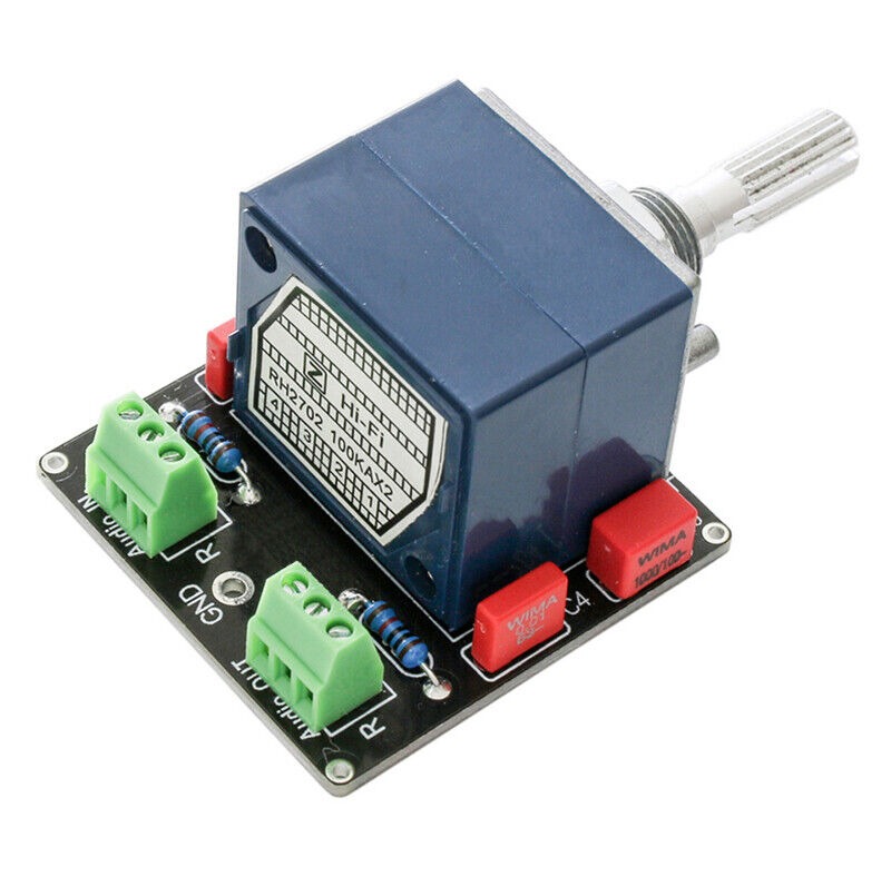

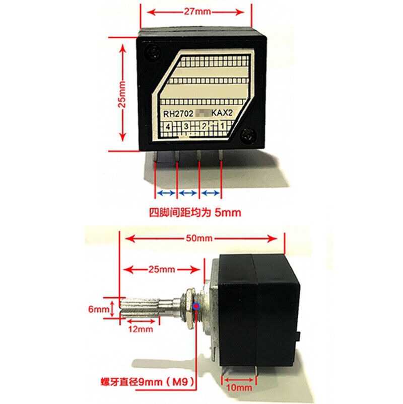

The RH2702/PH2702 looks good at first glance, but it seems to be an ALPS counterfeit:
https://www.diyaudio.com/community/threads/alps-rh2702.345112/
