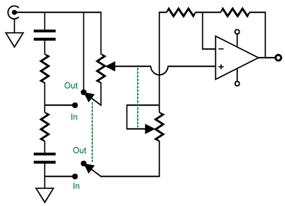

Broskie wrote about his idea of a "high end loudness control" --> https://www.tubecad.com/2021/08/blog0542.htm
Wow. That looks spot on. I trust given Broskie's expertise, that the circuit below would be a good one to try to build. I might be able to figure out a point-to-point assembly of his diagram with switches. I'm guessing that I'd need to do this three times. One for L, one for R and one for the Sub. The trouble is, I don't know exactly what to buy.

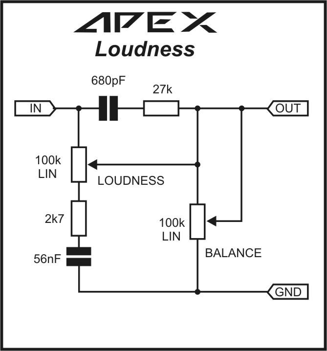

If anybody has a collection of loudness circuits pls share. Is there a universal standard which explains what the perfect loudness circuit does.

I worked on this problem for a while, emulating circuits from commercial units and trying an active summing circuit. The only suitable circuit I found was quite traditional and used old school potentiometers made of unobtanium. However, you can switch an array of networks between the fourth post on those potentiometers for a very useful circuit. Adding a second volume control after the loudness plus buffer(on the back of the unit) to adjust the gain structure makes it work even better.
