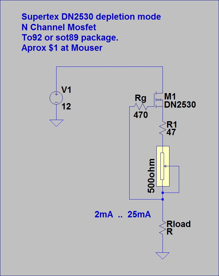

I would like to build a variable constant current source for experimenting with various stage topologies. I would like something that is variable from say 1ma to more than 10ma maybe as high as 100ma?

A depletion mode mosfet, like the DN2530 or DN2540, will make very good current sources up to about 100mA. See attached drawing.
pb

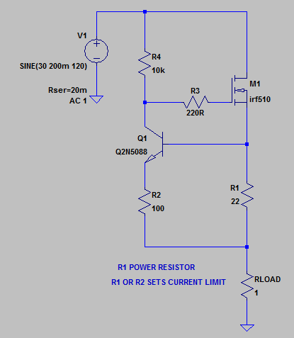

Been there, done that.
You can also do a Howland Current Pump with an op-amp and external power device. An advantage of this is that the input can be derived from a reference. (Even a DAC if you so please.) The Howland does have its disadvantages, such as needing twice the load voltage as a supply voltage and sometimes being hard to compensate.
