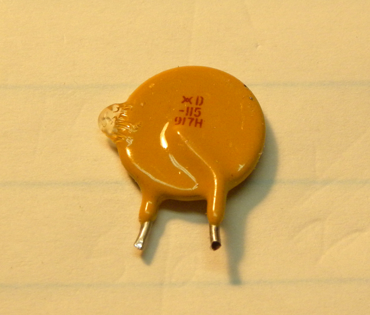

Component not needed
I found some info about the part and it can be eliminated without any consequences.
joemusic.
joemusic.
joemusic.
So you think they put it in there for no reason? Doubtful. It will limit inrush current, and will also have a small resistance after it gets warm.
