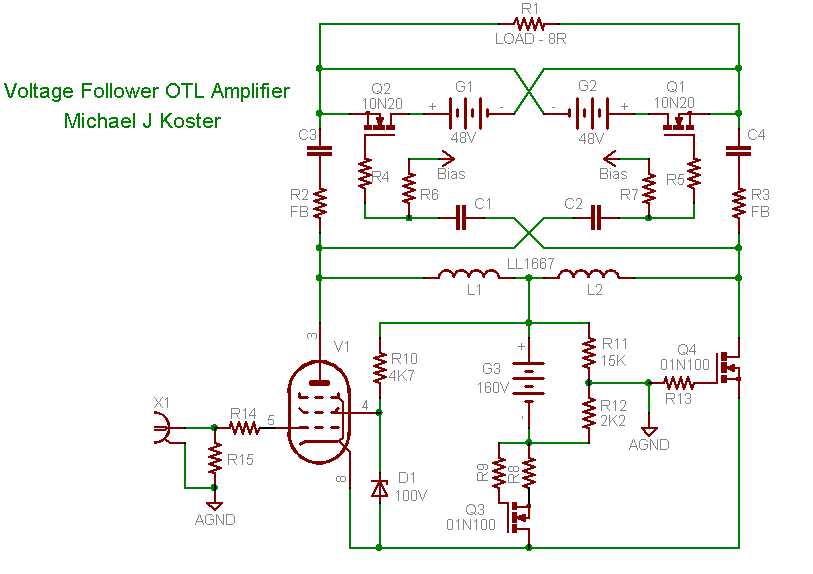

Here's another sketch out of my notebook I've been working on. It may have serious defects as it's only a work in progress...
The output reference and bias control is not shown. Not figured out actually.

Hmm.. operate the pentode in a linear current region and lose the shunt regulator...
Except I don't see any "voltage follower"?

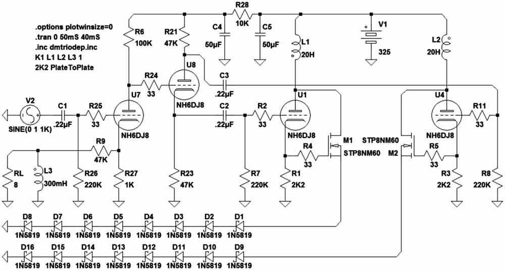

Did you notlook the .asc file I sent regarding 6V6? I had all the bias worked out.
There was just this annoyance with LTSpice locking up on 1ohm change either
way. Somehow I don't think would happen in reality...
The 6V6 Triodes were biased at 30mA (11.5W per plate) and swung +-25mA Class A1.
The 6V6 Pentodes were biased at 20mA (7.5W per plate) swing +130/-20mA Class AB1.
To the tune of about 20W clean 1K sinewave into 8ohms.
There might be a few more peak watts lurking in A2, but the crossing becomes messy
if you operate at excessive volume continuously (Bias pumps itself toward cutoff) ...

I guess you ran out of LED symbols in the Simulator?? Makes a better "triode" curve for the Mosfet maybe?
I considered the Darlington output too, but it doesn't look so easy to make that into a triode/anti-T setup (using CCS tail). If you change U4 to something higher gm, then M2 doesn't get much gate drive signal. Maybe could fix that up by getting rid of the Schottkys on that side or a big cap across them.

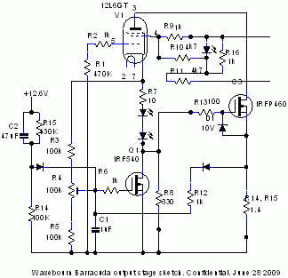

Go ahead, ask me why all the Schottkys?
Because otherwise it would remind my Barracuda. 😀
Cause MOSFET may technically be some kinda
square law device like 6L6? It isn't usefully so
AB crossing at wannabe tubelikeish currents.
Wasn't just cause I didn't have Spice model
for an LED or anything like that... There is
really something almost 6L6 magical about
how Schottky diode crossing curves mate...
Schottky diode stacks shape much cleaner AB
crossing here than MOSFETs by themselves.
Also the circuit was simplified by eliminating
the differential error amplifier. Each class A
triode controls only AB dumper on own side.
Each Triode's alternately has negligible current
influence when its dumper completely cuts off.
So makes a big difference the AB transition
smoothly hands over control of Mu from one
class A triode to the other.
