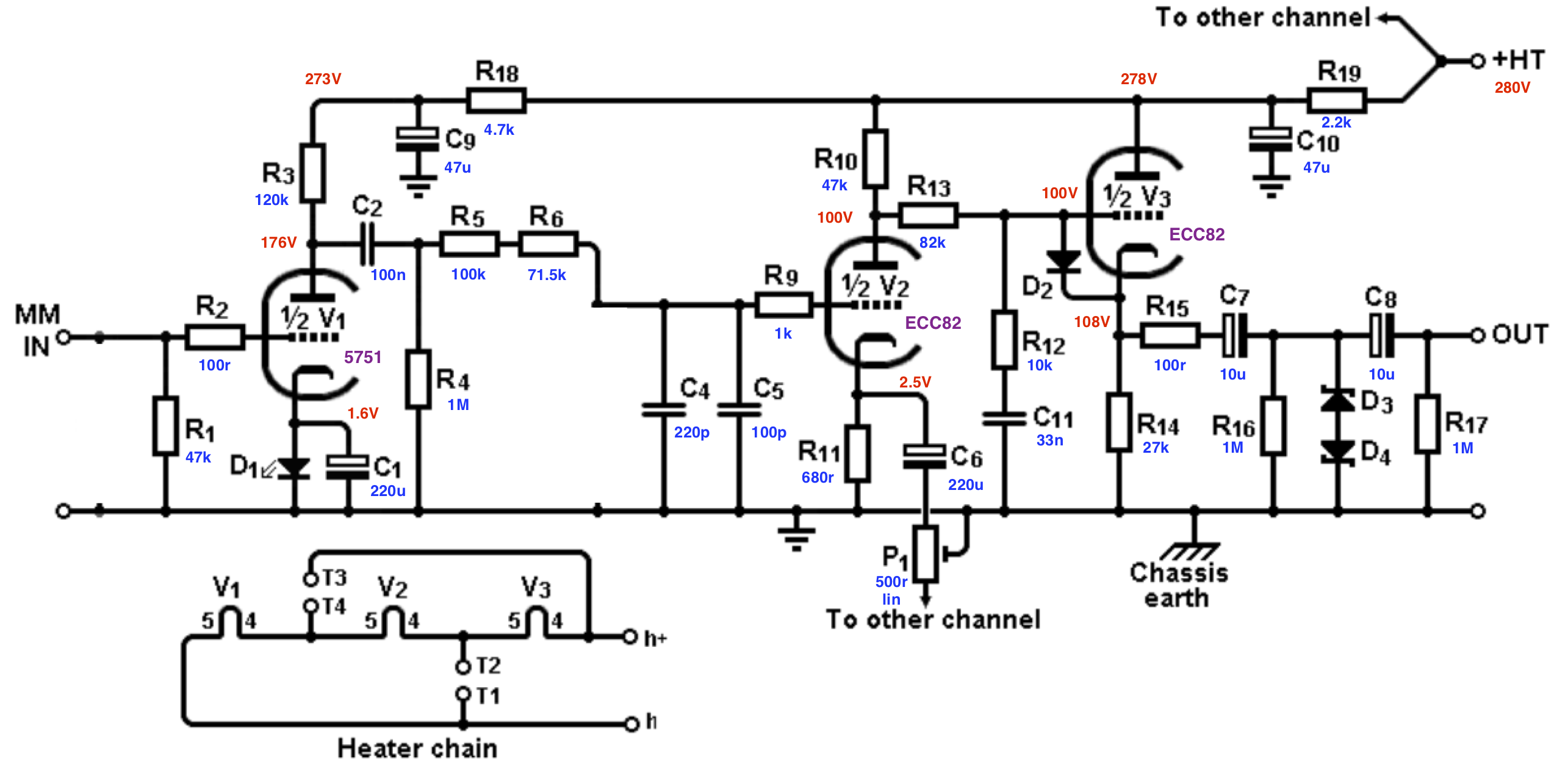

I build this phono preamp from valve wizard:
The Valve Wizard
When I finished the build I connected to my amp and I notice that the left channel sounds louder than right channel. Okey, time to connect an oscilloscope and insert 1khz signal, and yes, the left channel sounds louder than right channel. I try to adjust the internal trimm, but its not enough, I check all the components over and over, I change the tubes, for new ones. The only way I can adjust more or less precisely is if I elevate the heaters to 7v and down the HT to 200 or 220 vdc.
I have paralell heaters
RIAA split
V1 and V2 ECC83
V3 ECC82 I tryied a ECC88 to
And ideas?
V1 and V2 aren’t matched, but I supose that the prupose of the trimm is for it...
Thanks.

Likely it's just that the tubes vary in gain. There's no nfb to normalize their gains. Try measuring the 1kHz gain of each tube stage, disregarding the RIAA network to see where the gain difference is, first or second stage. If you have plenty of gain,
try removing the cathode bypass capacitors and see if this makes the gain similar enough between channels.

Here are my voltages for comparison. Not sure they're much use. I used a 5751 in the 1st position and ECC82 in 2nd & 3rd. Pretty much identical readings on both channels. I had to do a minor adjustment to get channel balance.

So I will use your method of numbers. (Clockwise from the top of the socket 🙂.
Pin 2 should be very similar to pin 7 on each valve. That's the cathode (3 and 8 from below).
Pin 4 should be very similar to pin 9 on each valve. That's the anode (1 and 6).
So what looks wrong?

V2
1: -1.078
2: 0.400 should be much higher 2 to 5 volts ?
3:
4: 138.8
5: -4.06
6: 1.956
7:????
8:
9: 141.1
V3
1: -1.010
2: 29.56
3: 30.07 this should be the same as you have on pin 4 of V2 so ~ 140v.
4: 248.8
5: -4.06
6: 1.980
7: 26.20
8: 26.78 this should be the same as you have on pin 9 of V2 so ~ 140v.
9: 250.6
So check what you have on V2 pins 2 and 7 again.
Then look why you do not have 140 volts on the grids of (pins 3 and 8) of V3.
Once you have fixed that, the voltage on pins 2 and 7 will go up to about the same too.
Alan

I have had a look at the build guide now.
So you have installed the links in T1-T2 and in T3-T4 for parallel heaters?
What heater voltage are you inputting to the board?
6 volts or 12 volts?
From the correctly numbered table in post #10, you only have 6 volts between any of the pins 4 and 5.
V1
4: 2.046
5: -3.90
V2
4: 2.063
5: -3.89
V3
4: 2.103
5: -3.80
As you are using ECC82 and ECC83 you should have 12 volts and be using a 12 volt supply...
(6 volts would be fine for ECC88 / 6N1P types.) Alan
