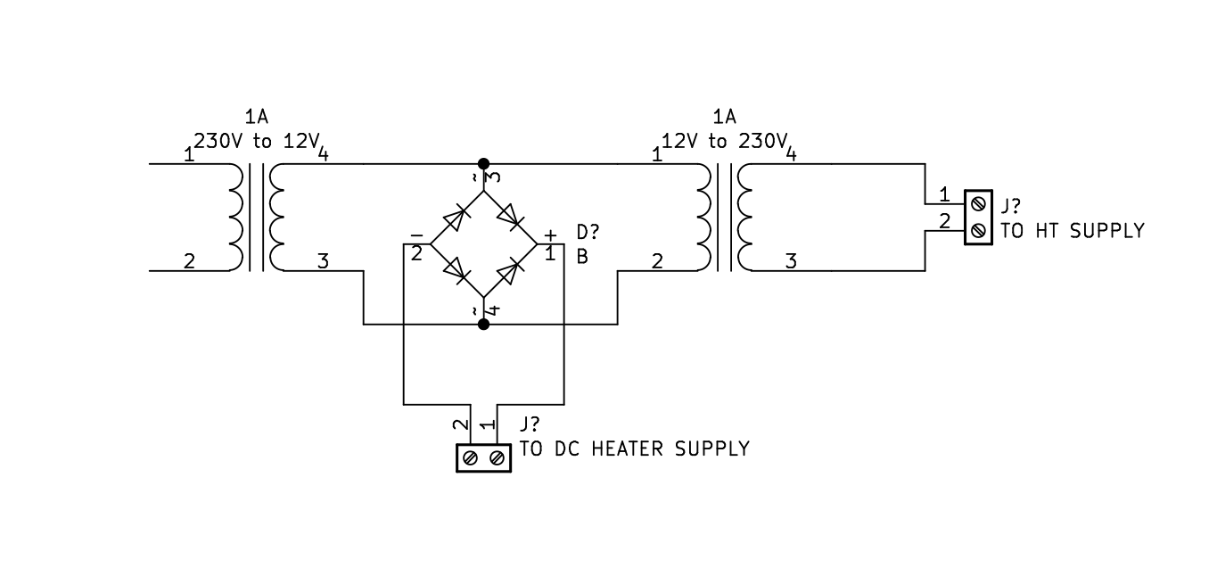

I think that I got it,
I've noticed that I haven't voltage on pin 3 of V2 ( cathode ? ), so I swapped the V2 tube until I've found one with more or less the same readings on pin 3 and 8. And now I've balanced output.
osci — imgbb.com
It's possible that Brand new tubes are faulty?!!??!
Anyway, you can tell me if the other voltages are correct?
Thanks a lot!!
Yes I've installed the T1-T2 and T3-T4 links. My heater supply is 6.3v. I change V3 for a ECC88.
And this are the new readings of two channels.

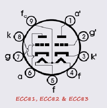

There is still some confusion here.
Look at the circuit diagram again, see heater chain, only pins 4 and 5 are used on the board. When using pins 4 and 5 with ECC82 and ECC83s you must use a 12 volt heater supply. Using a 6 volt supply in this configuration only half heats the filaments... and leads to very odd behaviour.
See the valve layout and there are two 6.3 volt filaments in there joined in series at pin 9.
The ECC88 or 6N1P valves have their filaments joined in parallel and they are 6.3 volt valves.
Do Not mix ECC83 family and ECC88 family valves on this board.

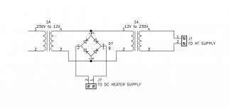

Anyway, I found two little toroid transformers into a box, 230v 12v 1amp.
I can't wire this two Transformers this way?
And of course, use two ECC83 and one ECC82 in paralel with 12v supply.
schematic — imgbb.com
Can I wire these two Transformers this way?
I'm learning, thanks.
You can wire them like that,
BUT there will not be enough 'power' to supply both the heaters and the HT supply. Here is why:
The heaters need 5.4 Watts (12v x 0.45A = 5.4 Watts) and the HT needs 7.5 Watts (250v x 30mA = 7.5 Watts) That is 12.9 Watts.
Your transformers are only 12 Watts (12v x 1A =12 Watts or VA.)
Also there are power losses using back to back transformers so say 80%.
You would need 2 Amp transformers (24 Watts or VA) to be safe.
