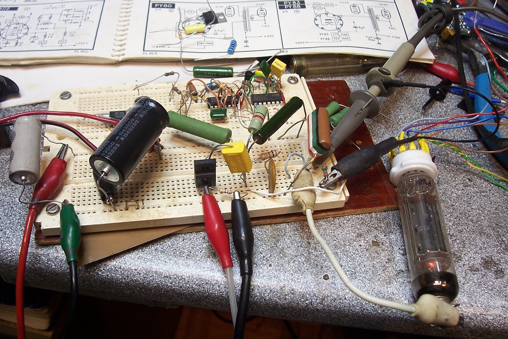

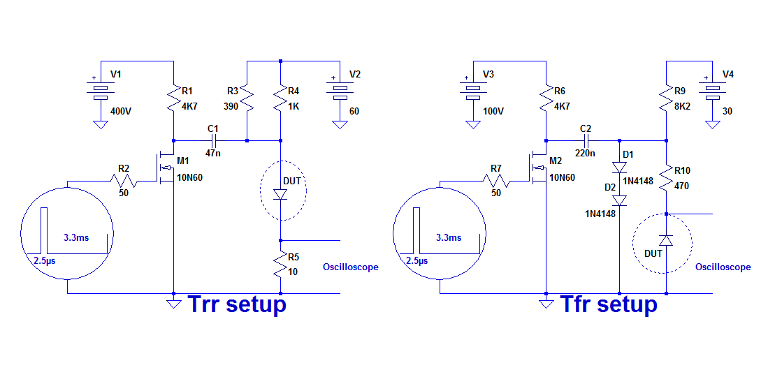

Here are the test results.
These are the test setups for the reverse and forward recovery behaviour.
They might look odd, and could probably be improved, but I didn't want to twist my mind too much for a one-off, and I wanted everything to be GND-referenced, to ease the connections and avoid potentially dangerous situations, both for the circuit and myself.
To minimize the dissipation, the circuit operates at a very low duty-cycle, and both version are using the same basic engine.
To get a good luminosity, the scope has to work in digital mode, which explains the lack of smoothness of the trace

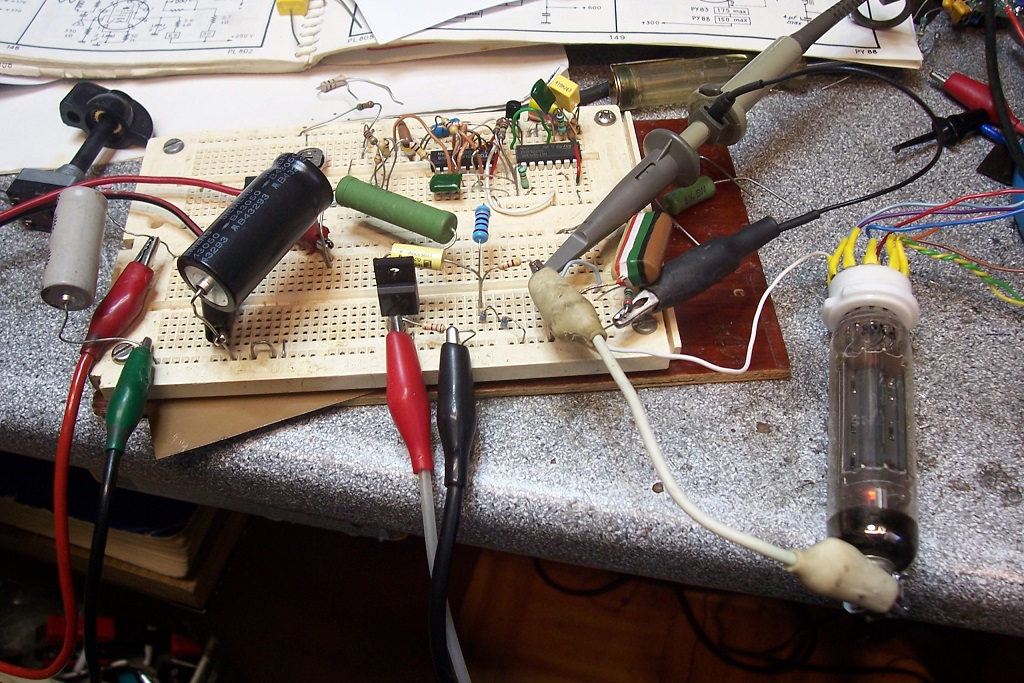

This is the physical implementation of the Trr setup:
And this is the Tfr:

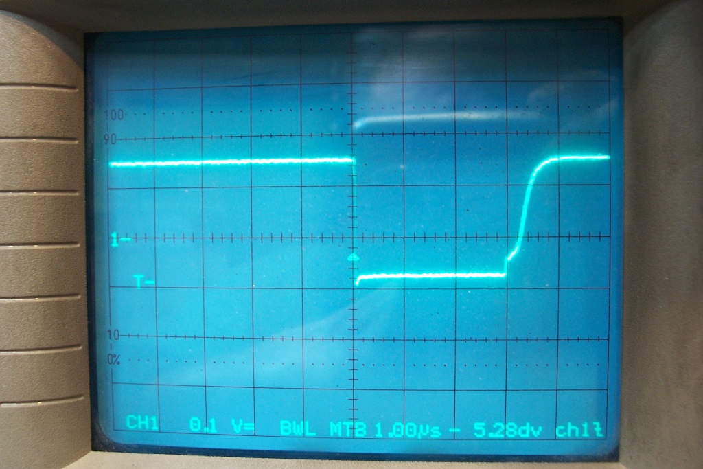

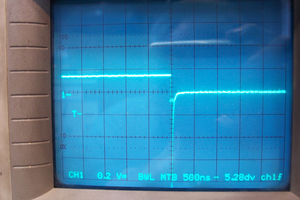

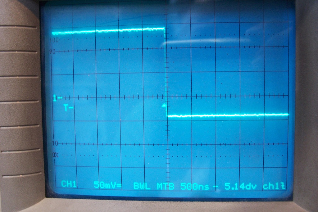

This is the Trr profile of the PY88: the recovery instant is at the center of the screen, and the horizontal center is the zero current.
The diode is switched from a forward current of 150mA (50mA/div) to a reverse bias of 300V. The only limiting measure is the 10ohm measuring shunt:
This is the Tfr profile, same conditions except the conduction starts in the center of the screen, and the Vf is negative (~12V) (the positive part is clamped by the 1N4148's to avoid saturating the scope's input):
Both are practically spotless, and I suspect that the small overshoot is caused by parasitic couplings, not the PY88

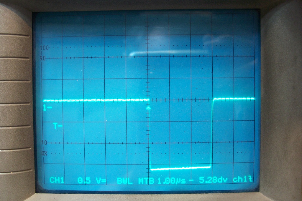

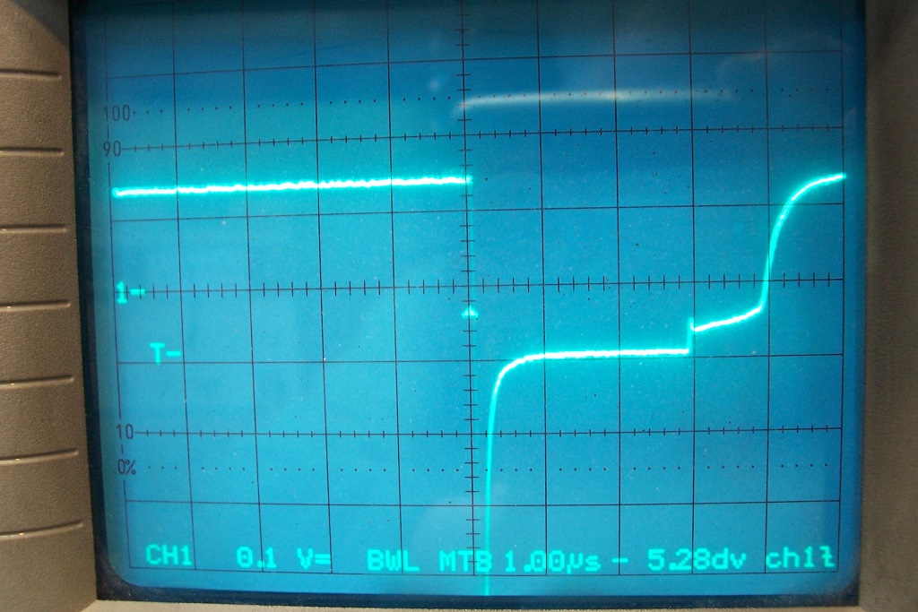

This is the Trr of the UF4007. Note the change of the vertical scale, which is not even sufficient to completely catch the huge recovery spike.
Tfr of the UF4007: a significant overvoltage is present:

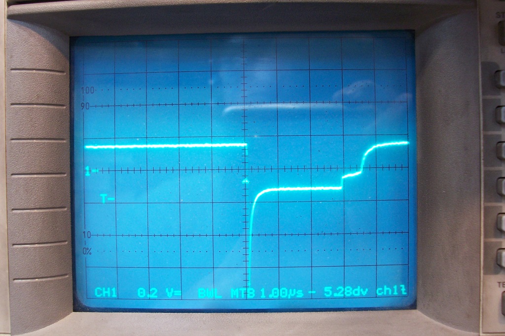

For comparison, this is the Tfr of a BYV27-50: the 20x times lower Vrrm makes a huge difference. The result is almost perfect:

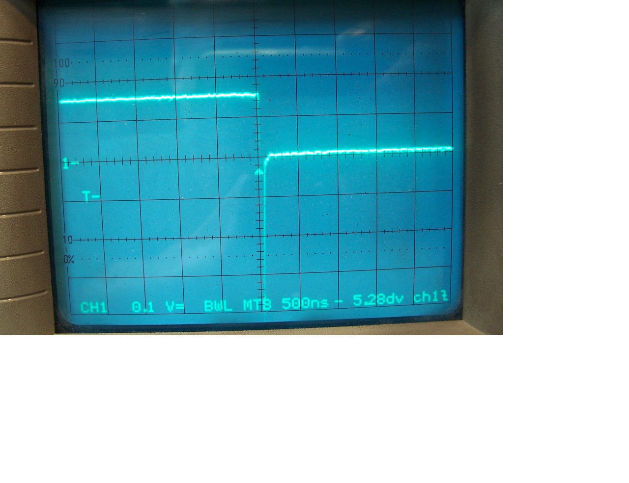

A BA159, another HV diode is in the same league as the UF4007, just worst:

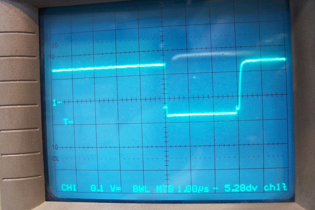

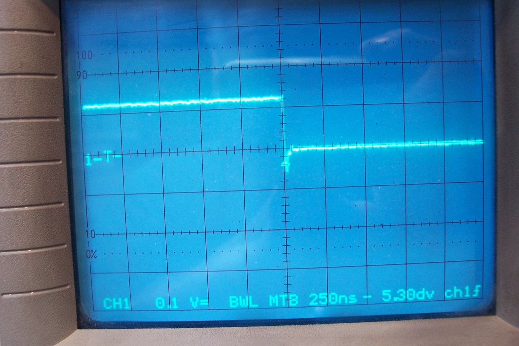

This is the Trr of an hyperfast diode, RHRP860:
-See next post, the 10 files limit is reached
Much better than the UF4007, but not as perfect as the PY88.

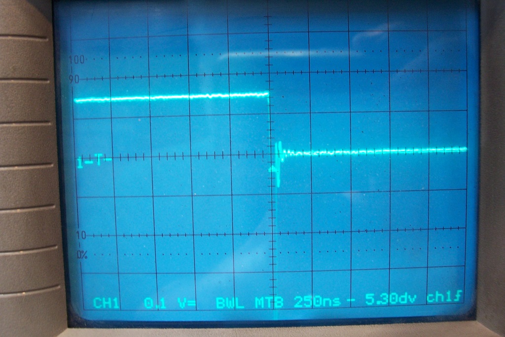

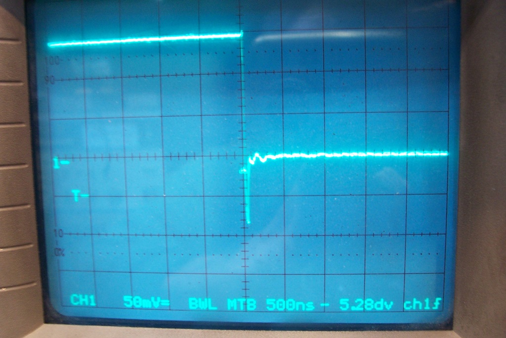

I have tested the 100V schottky: it is a B10100 made by ONsemi.
I have adjusted the reverse voltage to 100V, and If remains at 150mA.
This is the Trr:
A short, but large spike is visible. Almost certainly caused by the diode capacitance (~670pF).
For comparison, here is the PY88 again, in exactly the same conditions:
Now the Tfr behaviour:
This one is absolutely spotless.
For comparison, the same for the PY88, measured previously:
Thus, the reverse recovery behaviour of the tube remains vastly superior.
Note that the schottky is a relatively large one: 10A.
With a device having an If comparable to the PY88 (200mA for example), things would look a lot better, but the ~15pF of the PY88 (unheated) will be difficult to beat.
