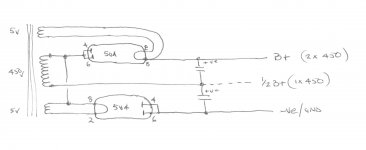

Gents,

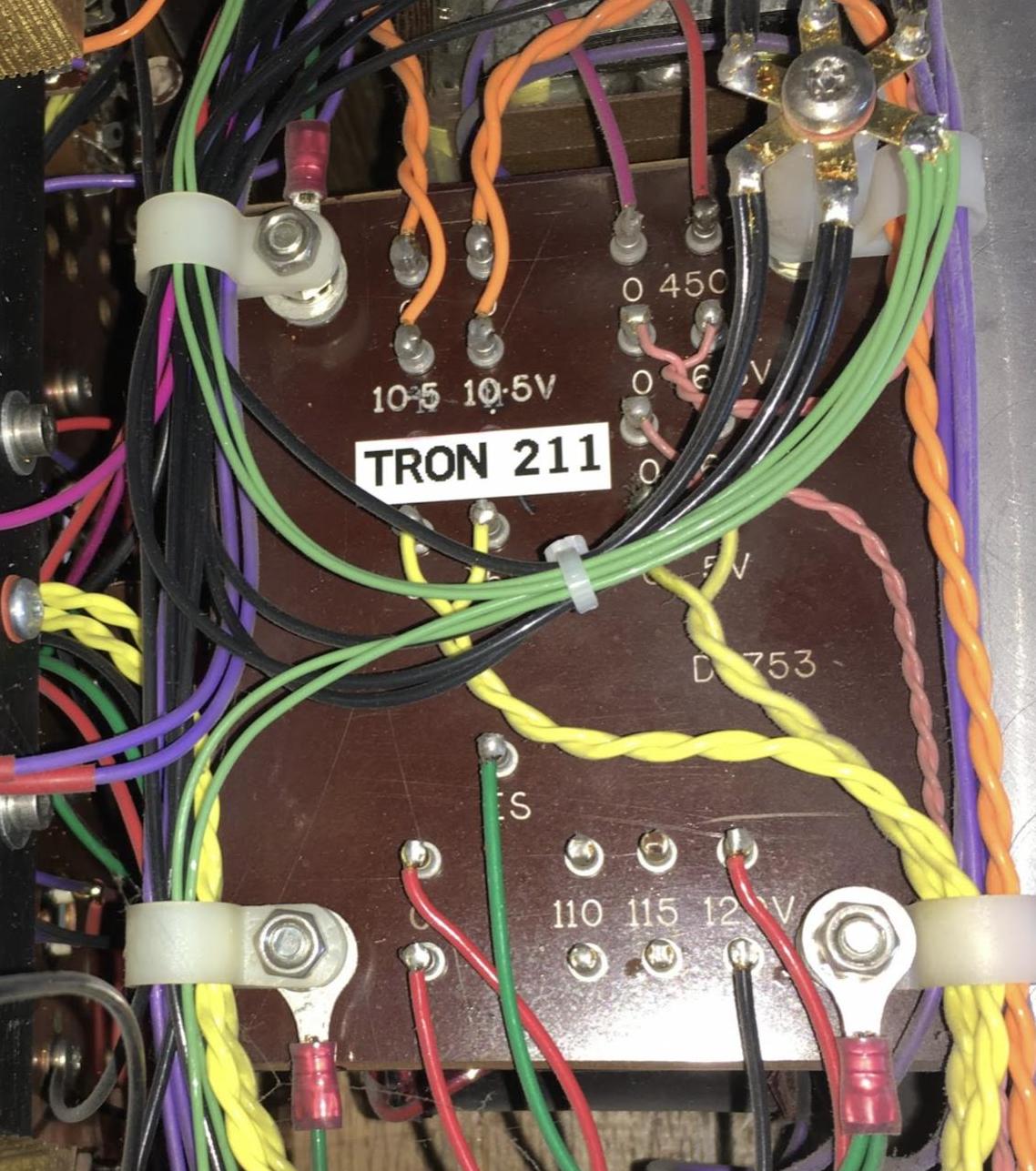

I am trying to understand more about my 211 amp, and it has two 5u4GB rectifiers, and on the main transformer only 0 450v apparently no centre tap. ......I think...
Could it be a voltage doubler circuit maybe?
Is there a good way to see how the circuit works without a strip down, as a lot is out of sight.
Can I learn anything by taking some measurements from the 5u4 valve base etc.
211 is at ~1000v, so yeah I know it's dangerous poking around!
Just trying to learn things, no real reason other than initially trying to understand if my driver valves are diode or valve rectified.
Thanks,

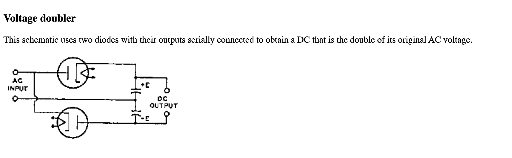

saw this circuit, but not sure I understand it :-(
[/url]
AC has both a positive and a negative sign each 1/50 second. On the positive cycle, the upper diode conducts and charges the upper capacitor. After that (0,01 second) period the lower diode charges the lower capacitor. So, each 0,02 seconds both caps receive their energy boost.
You could (should) connect an extra capacitor to the +E and -E terminals of #5 drawing. The bended line represents the cap negative terminal. In your amplifier you most likely find both cathodes in parallel for each 5U4, so they withstand higher loading currents.

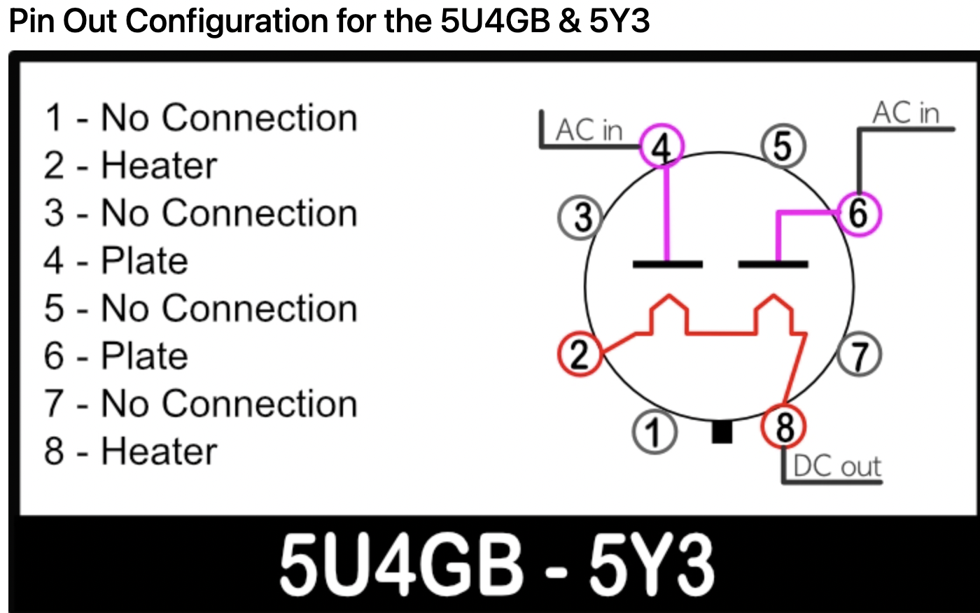

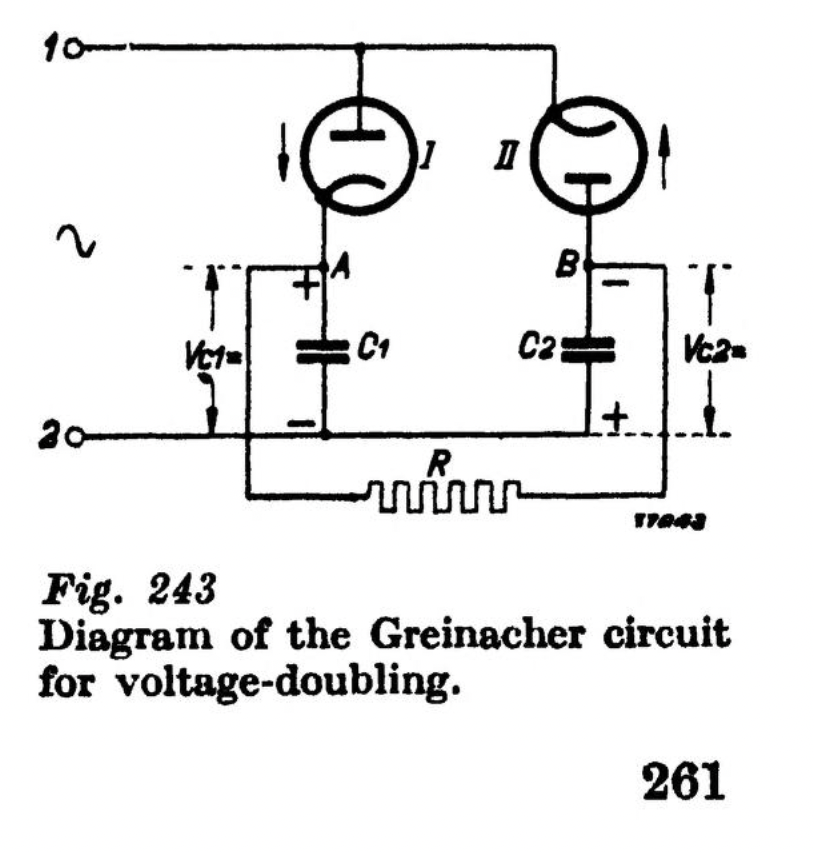

So can I assume for the pins on a 5u4GB like this picture then 2+8, and 4+6 are connected together and then on Page 261 like the image attached that rectifying valve I has pins 4+6 connected to AC+ve and on rectifying valve II that pins 2+8 are connected to AC+ve?
and what happens to the heater AC 5V; seems very confusing to me!!
(don't worry I am not going to blow myself up quite yet.....the only reason i want to find out is to understand my amplifier)
Sorry this is all based on logic with no knowledge :-(
Because you have only one HV transformer and two rectifier tubes, there must be two separate 5V heater supplies for the rectifiers. The heater forms the cathode while the 'plate' connection forms the anode. They only conduct one way.
Yeah there are two 5V taps for the 5u4gb rectifiers.

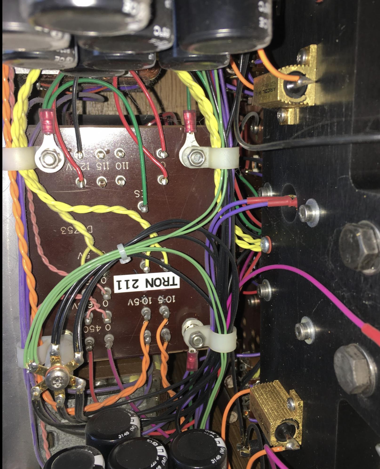

This is an image of the transformer, that I can see.
What I am trying to understand is where the 6C45 driver valves are getting their rectified B+ from.
Thanks so much 🙂

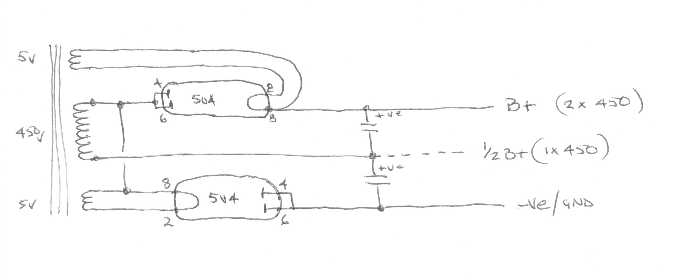

Hi tonescout,
No you will not cause any harm with the rectifiers 'pulled'.
The driver valves will have B+ straight away if there is a silicon rectifier in there, so a very quick test.
I suspect it will be much simpler, there are only 2 wires to the 450 ac volt transformer tap.
So the 211 B+ is from the doubler as you have found, the the driver B+ could be from the half way point in the supply (the junction of the first 2 smoothing caps) or conventionally from resistors dropping the total 900 volt B+.
Using the rectifier valves preserves the slow(ish) start for the 211 and drivers too.

Ok - great I will confirm.

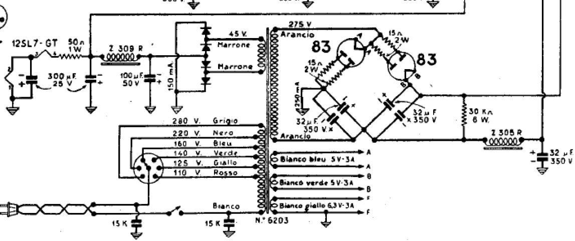

Here is a twin tube voltage doubler from a Geloso G275A, with seperate screen and plate supplies for 807s.
I think the trick with the 12SL7 heater supply to provide the bias is very neat.
