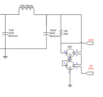

choky, 27mA per tube.
here is the schema of what i used before to peg the voltage of the driver tubes (around 10mA @) to 255V.
i'm sure you can suggest improvements. 🙂

choky said:
I don't wanna to step on anybodys toes here,especially on fdegrove's ,but series reg is long time ago not my cup of tea;
what I like,and use ,is any sort of shunt reg.
gass tube only,gass tube with resistor in parallel,gass tube as voltage ref with additionall shunt element,whatever...
in strictly line amp psu purpose,usually is plain one gass tube /per channel or even for both channels -hard to beat overkill,especially when combined with at least one choke in preceding stage(s)

do not worry about grid supply-any decent mains filter will do adequate job.
anyway-if you are in trouble-you are in trouble with any preamp,regarding mains pollution
12B4 stage can be made with shockingly good PS,still cheap(?!) or non-complicated
simple?
all good things are simple,but not simpler than needed (choky reinventing boiled water here)
regarding JAN 12B4,that you'll choose-where,how much etc.

this 12B4 schmtc looks good,but I can say that Mark's look promising ;
anyway-start with plain resistor in cathode and later you can try CCS
this PS supply schmtc looks exactly what I'll do,except that I must put on paper currents through VR tubes etc
like I say-before-choose which variant you will make,then say something about available xformers and chokes ,and then we will make few PSU proposals
