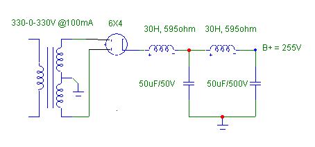

hi mark, were your choke values selected based on availability? i think you should for something like 5H 60mA units.
secondly, if I remember right, the 20mA is for a single channel, so you need to put in 40mA in your current load for a stereo.
lastly, if you find it difficult to find appropriate chokes, i'd suggest a 10uF-1K-100uF-1K-100uF-1K-100uF. i've used this successfully in one of my preamp and has no visible ripple on the scope (unless my scope is broken )
Thanks for the input arnold.arnoldc said:hi mark, were your choke values selected based on availability? i think you should for something like 5H 60mA units.
I picked the chokes due to availability, yeah. I could get some stuff from DIYparadise as I'm ordering some stuff soon but it's quite expensive with postage.

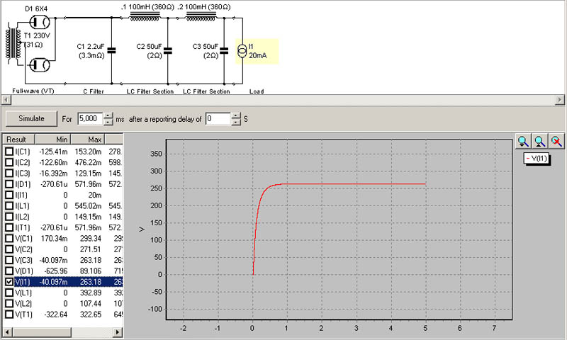

I'm going to have to rethink my design seeing as it's now a 40mA load..
The 10uF-1K-100uF-1K-100uF-1K-100uF didnt seem to work according to the software
Am I on the right track though?
Commited said:
I had a play around with a simple design for a power supply..
It gives me the 260V I need.
Opinions? I can build this for quite cheap
recheck ohmic values for your caps;
bigger caps usually have less impedance than smaller ones
re-read PSU designer help few times
mark, it is important for you to feed the estimated DCR of your power transformer into PSUD.
also, if you use 260V for my CRCRCRC, you'll get the error because the secondary is too low for the load.
if you're really stuck with 260V, you may want to use SS rectification instead (FR107 should good).
