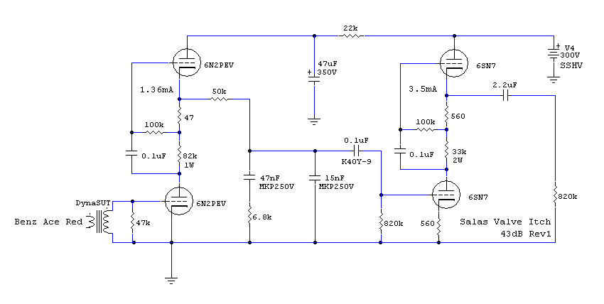

Hi all,
I would like to build an Itch, plus a line stage / pre amp to go with it.
Maybe a 6sn7 based line stage as I am buying the parts for the itch.
Is it a good idea to add another gain stage to the itch or build a separate line stage?
1 x psu, SSHV and itch with line stage,
or
1 x psu, SSHV,itch
1 x psu, SSHV line stage
Any recommendations for the volume control, I am using a passive pre with an Alps pot.
Not too expensive or complicated please?
I have the partridge 997s in a separate box, sounding fantastic. But will probably fit them internally to shorten the signal path.

I would use separate regulators for the phono and line. Making it integrated or not its just a matter of personal choice, but no AC carrying cables where the phono's housed, transformer(s) & rectification+big filter caps in a separate box remain a must. I would not make a 15-20dB gain line stage. 10dB max. There are no PCBs for the Itch of course, special project for buss bar detectives, only 3 prototypes in existence counting Fran's and no completion news revoli's, too hot for a PCB and a good reliable future anyway. As for heaters the more you separate stuff the less interactive but the more complex and big it gets. It already needs 2 heater PSU's, one 1/2 B+ floating, the other grounded. Its NOT an easy project, takes some persistence, especially to debug possible grounding issues etc. 800-1000x gain for an MC cart from SUTs & valves, hot shunt regs, cables, you get the picture. Fran's build had a good step by step presentation, problem solving, comparisons, conclusion, read it as an example.
I'm using a 6SN7 aikido pre with mine and am very happy. That might be a good starting place... and there are PCBs available for this, in fact there are kits with all you need except transformers at the tubecad site.
EDIT: I just went back and re-read your post. If I understand you correctly you are wondering if you need a pre with gain instead of your passive..... probably not is the answer I think. But maybe watch the input impedance? Salas/others may be able to better advise you here.....
Personally, I'd build the pre as a separate unit - its easier to build this way, and allows you to move it around and use it in other systems. All of the stuff Salas has mentioned too...
You could use separate windings for the 2 heater supplies, but I used 2 separate transformers because I got some cheap from farnell in a sale (€3 each!)
Volume control: can't get simpler than a gigaworks pot from ebay, excellent performer at very low cost. Better than an alps blue.... I know they look cheap and don't feel like a goldpoint, but the ones I've used have lasted well.
Caps: I'll go look and post back later - there have been so many!! I think I now have all K72P-6 for the RIAA, FT3 for coupling (I think) and MGBO 2uF for local PS. If you hav e a read over my posts in that thread you'll see the evolution!
No kit for the itch - I don't think it really lends itself to a PCB too easily and you'd hand wire it easily enough. There is a shunt kit I think from Quanghao in the vendors area, and I think someone has one up for sale in the swap meet at the moment. I used mouser for the SSHV, heater components and itch components, russian ebay sellers for the caps and 6N1P (sockets too) and langrex (ebay again) in the UK for the rest of the valves. You'll need heatsinks etc for the heater regulators and of course the shunt.
As Salas said, it is a reasonably complicated build. Its very high gain for valve stuff, so expect to spend some time sorting out hum, and when you get past that, swapping caps etc. But the result is rewarding!!

OK here's the main details of my build:
HV Ps:
260V secondary, and I think specc'd about 80mA should be enough for demand + shunt
SSHV, wired on a perf board putting out 290V. I had this Tx as a salvage from something else. Don't know the exact spec, but it doesn't heat up although isn't very large.
Heaters:
I used 2 x 9V sec transformers using the 317 reg supply as recommended by Salas. I happened to get a deal on some from RS supplies at a few euro each, the RS number was 504-644. They are 75VA each, and are probably oversized for what is needed.
Heatsinks + hardware:
You will need a decent enough heatsink for the SSHV, and the 2 x heater supplies. Also 6N2P x 2, 6N8C x 2, octal sockets, nine pin sockets, step up Tx (partridge 977 sound very good), chassis x 2, connectors for umbilical, IEC for mains plug, switch, maybe LED indicator, RCA jacks etc. The regs are all in one box and do throw out a good bit of heat, so use a chassis that has some ability to breathe. I used a mix of different wire, but mainly silver in teflon, shielded where possible from navships on ebay
Power supply from earlier in the thread:
Itch circuit from earlier in the thread:
All the transformers are in one box which is connected to the main phonostage (containing everything else) by umbilical. There is high gain in the amp so beware that you will probably need to be patient and work through hum etc etc. If you can filter and read my posts from earlier, and the links to other sites, its well worth your while. Very good info on grounding to be had here.
So the capacitors:
Main output caps: I used some PP 2.2uF 600V ones I had lying around and eventually I bypassed these with some russian 0.1uF 600V FT3
Power decoupling: this is on the sch as 47uF 350V, I ended up using some 2uF 500V russian MGBO caps here
coupling cap: 0.1uF K40Y-9 is on the sch, I used 0.047uF K72P-6
RIAA: I tried silver mica but ended up with K40Y-9 for both the 0.047uF and 0.015uF. These sounded best to my ears.
I also tried some 6N2P-EV but the ordinary 6N2P I had sounded better.
I used 2 different Russian sellers for the caps and 6N2P:
Alexer1 and uralspirit. I used Langrex also on ebay for the 6H8C. The partridge step ups are very good value on ebay by seller dr-tron. The other stuff I got from mouser, radionics, farnell or salvage.
Even though I started with a fairly big chassis, those bit russian caps and the regs+heatsinks fill it up pretty quickly! Pics as it currently are below.
Ask any questions, I might not be able to answer, but if I can I will 🙂
Fran
Naah, no good anymore, rather confusing on first look without had read, those come from different protos arrangements, lets revise up to what's adopted up to now and synchronize them schematics a bit.
This is the last schematic?
Now we have all that is needed to build the Itch.
Thank you Salas and Fran.... Great work.
Those schematics have all final details, yes.
