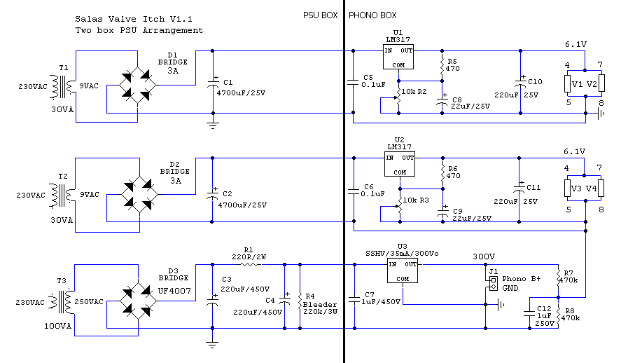

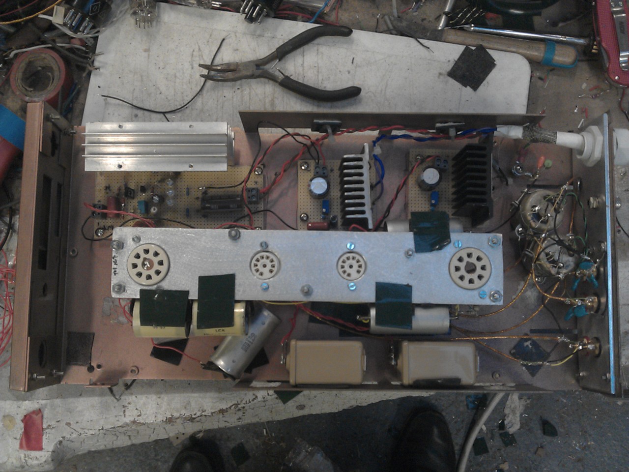

OK here's the main details of my build:
HV Ps:
260V secondary, and I think specc'd about 80mA should be enough for demand + shunt
SSHV, wired on a perf board putting out 290V. I had this Tx as a salvage from something else. Don't know the exact spec, but it doesn't heat up although isn't very large.
Heaters:
I used 2 x 9V sec transformers using the 317 reg supply as recommended by Salas. I happened to get a deal on some from RS supplies at a few euro each, the RS number was 504-644. They are 75VA each, and are probably oversized for what is needed.

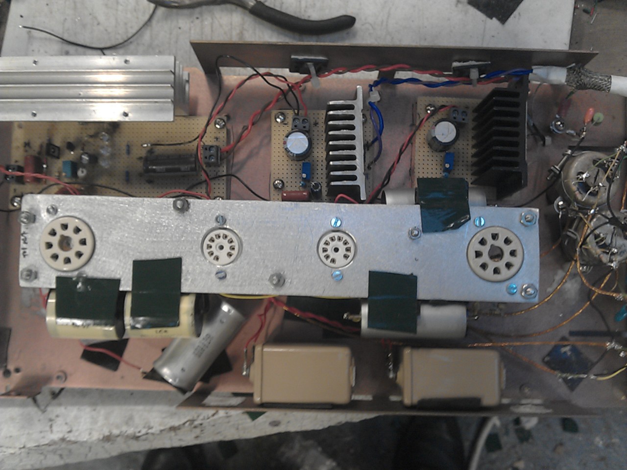

Heatsinks + hardware:
You will need a decent enough heatsink for the SSHV, and the 2 x heater supplies. Also 6N2P x 2, 6N8C x 2, octal sockets, nine pin sockets, step up Tx (partridge 977 sound very good), chassis x 2, connectors for umbilical, IEC for mains plug, switch, maybe LED indicator, RCA jacks etc. The regs are all in one box and do throw out a good bit of heat, so use a chassis that has some ability to breathe. I used a mix of different wire, but mainly silver in teflon, shielded where possible from navships on ebay
Power supply from earlier in the thread:

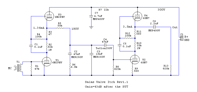

Itch circuit from earlier in the thread:
All the transformers are in one box which is connected to the main phonostage (containing everything else) by umbilical. There is high gain in the amp so beware that you will probably need to be patient and work through hum etc etc. If you can filter and read my posts from earlier, and the links to other sites, its well worth your while. Very good info on grounding to be had here.
So the capacitors:
Main output caps: I used some PP 2.2uF 600V ones I had lying around and eventually I bypassed these with some russian 0.1uF 600V FT3
Power decoupling: this is on the sch as 47uF 350V, I ended up using some 2uF 500V russian MGBO caps here
coupling cap: 0.1uF K40Y-9 is on the sch, I used 0.047uF K72P-6
RIAA: I tried silver mica but ended up with K40Y-9 for both the 0.047uF and 0.015uF. These sounded best to my ears.
I also tried some 6N2P-EV but the ordinary 6N2P I had sounded better.

Even though I started with a fairly big chassis, those bit russian caps and the regs+heatsinks fill it up pretty quickly! Pics as it currently are below.
Fran
Naah, no good anymore, rather confusing on first look without had read, those come from different protos arrangements, lets revise up to what's adopted up to now and synchronize them schematics a bit.
