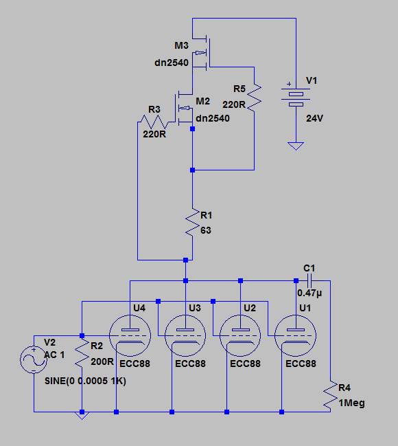

I looked into it a bit and I think it could be running just at 10mS in total as it is, with such a Jfet CCS about 6mA is to be expected. So something like 1.5mA per triode. Half the transconductance of a 5mA 2SK170GR for the whole composite pre pre in other words. 5mA per triode can boost to 20mS for 3dB better SNR. DN2540 can provide and its actually a good CCS down to a 20-25mA minimum level. Two in self biased cascode is even better high Z vs. Freq.

Those are depletion mode NMOSFETs work as -2VGS(OFF) JFETs. They should work stably when you got VGS*2 to spare across them.

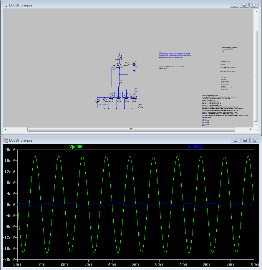

Looks like working, I set up a quick sim while we were posting. 1mV pk-pk input. Looks alright for output? R1 got to be a rheostat mode trimmer.

Should go up around 15-16V plate with 5mA per ECC88 if the sim model is any good. Is that a problem? Looks normal it should bias up a bit with more current used.
That's magnificent. 🙂

Will provide double the gm it used to have in this current now. Hope it stays put. After you will set 20mA with a VR1 (each DMOS sample has variation) better substitute a good fixed resistor for permanent reliability and better current noise.
P.S. If the combo can use even more current without instability and the plate voltage is still good for the chosen PSU at a yet valid curves point, test by lowering VR1 for more Ip & gm before fixing it for good. Max gm allowable is of course welcome for the low noise head amp purpose of that circuit. It will not go under 1nVrtHz easily and 1/F should be rather boiling when fed from such low source resistance, but anyway, good enough for using common tubes. Can select samples.
