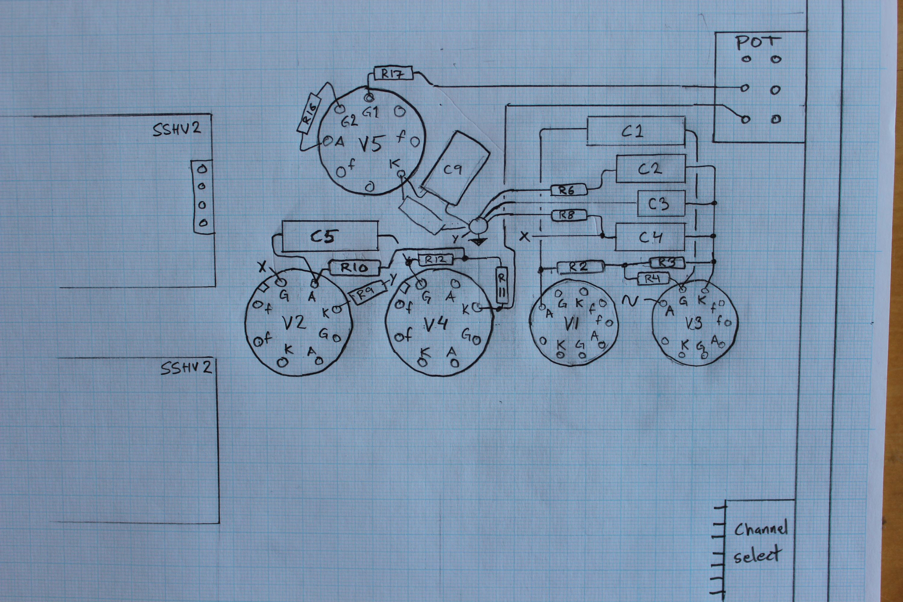

I looked into it a bit and I think it could be running just at 10mS in total as it is, with such a Jfet CCS about 6mA is to be expected. So something like 1.5mA per triode. Half the transconductance of a 5mA 2SK170GR for the whole composite pre pre in other words. 5mA per triode can boost to 20mS for 3dB better SNR. DN2540 can provide and its actually a good CCS down to a 20-25mA minimum level. Two in self biased cascode is even better high Z vs. Freq.
The Itch itself could push its input transconductance a bit also if there is raw DC spare for 320V B+ and R3 became 330 Ohm in combination. Little thing, but it could be better driving its EQ network in the highs. To maybe avoid double up experiments and more Miller for Stajo.
Single, you can't do double mono since the twin envelope valves functions are intertwined between channels.
One bottle is the bootstrap CCS part to the other bottle which is the gain part in the mu followers. Since you got to heater lift the upper part it can't be a single bottle per channel with its innards playing different roles.
Yes but the triodes are still separate in each bottle. Thats why I scetched as I did, with one triodehalf per side (only one channel is drawn).

The heater lift refers to one B+ and its common to both channels CCSs. The envelope elements are close together too, don't know if double rails could really mean good separation gain. Rather mixed enough already.Yes but the triodes are still separate in each bottle. Thats why I scetched as I did, with one triodehalf per side (only one channel is drawn).
The space between the cathodes and filaments (which are interconnected) are often just a thin oxide layer. Thats where the closest interaction is. But all the electrodes are still electrically separated.

Alright, if you plan to spare the space and expense for separate rails...
I dont know yet, just reasoning. Initial tests will go from one source. I dont know if the upper small triodes likes to be connected to 6V6 anode loads either.
