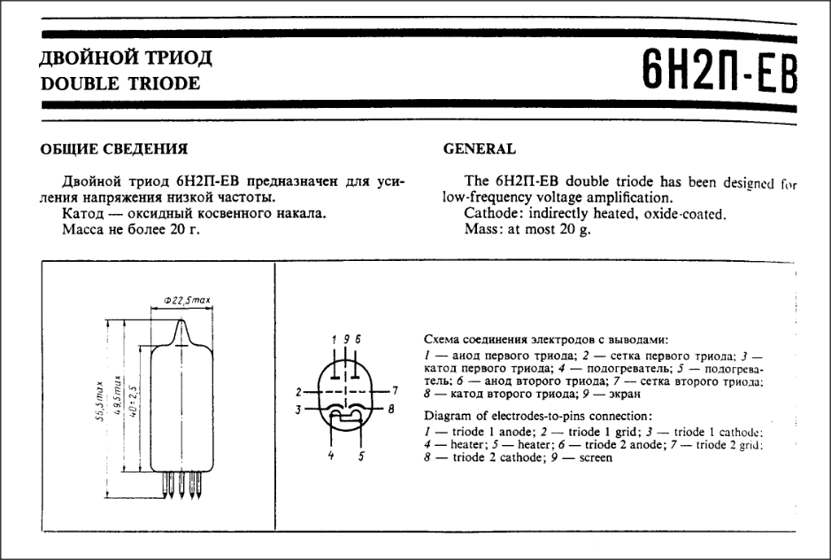

Salas handing the Itch I broked the glass of one 6N2P-EV and when powered "on" lits blue so I have to change, because 6N2P-EV Voskhod & Sovtek 12AX7LPS have more or less the same price on ebay the question is can I use the Sovtek? is better the Sovtek?

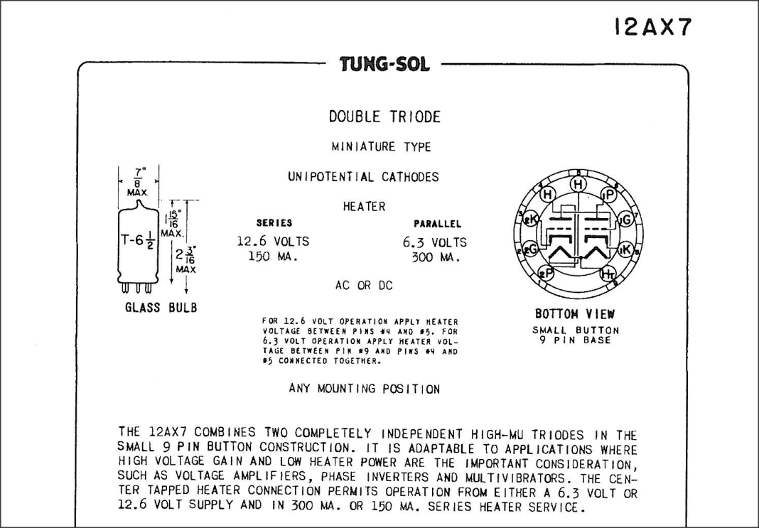

One is a 6.3V valve the other one is a 12.6V valve as you see.
So to heat the 6N2PEV you give 6.3V to pins 4,5 and pin 9 is a shield that goes to ground.
When to heat the 12AX7 with 6.3V you short 4,5 and you put that voltage between them and pin 9.
There is no shield and no low grid leakage spec provision. So you could possibly need the diode trick if you will try with 12AX7/ECC83.
