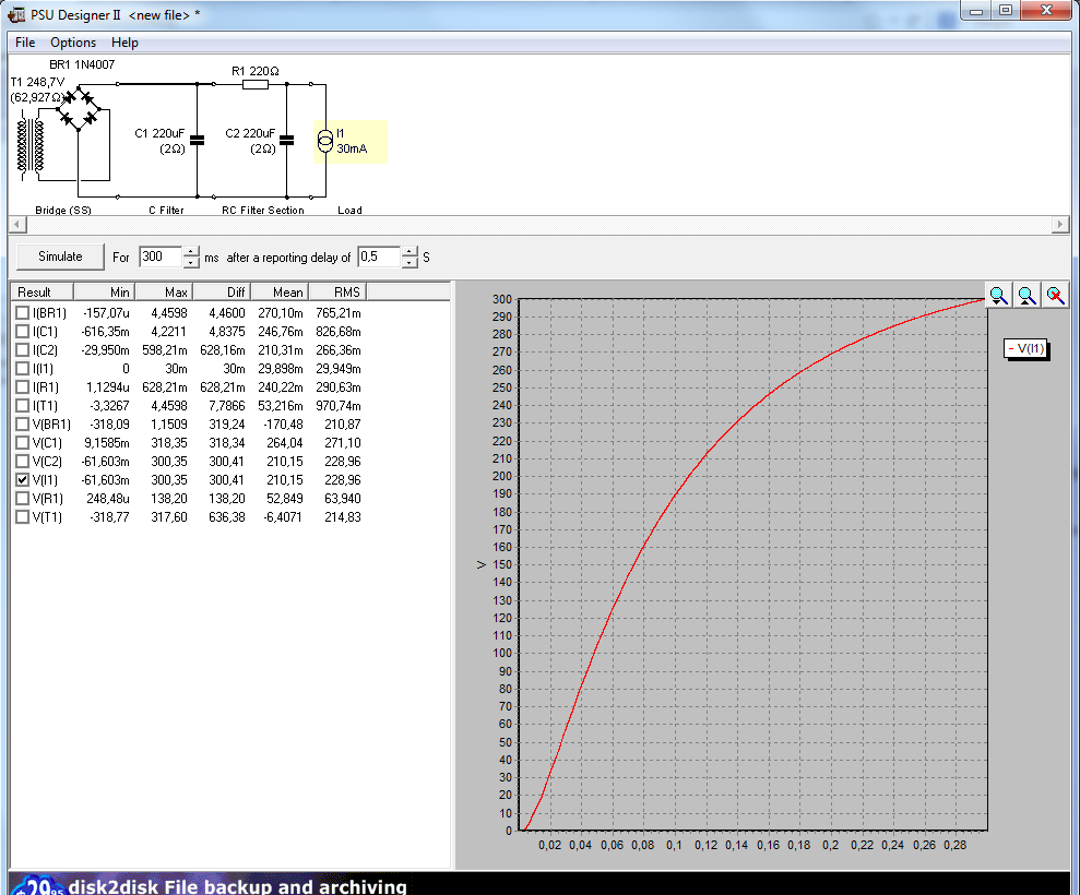

By setting delay and measuring time you can "zoom" into the startup phase to look for if the caps are sucking energy from the transformer that starts ringings.
I dont see any such tendencies here. Of course this has to do with many factors like the speed and size of caps etc. Inductors in the filter chain can also start interfere with caps and trannys in a bad way to show this edgy behaviour under startup.

I ont' understand why the voltage at the load varies depending the ms and the delay?
I presume that you by "voltage at the load" meen V(I1) in this case. It shows minimum value and maximum value over the voltage over load (I1). Third column "Diff" is "Max minus Min voltage over load".
If you set the measurment with a delay long enough so caps has charged and startup phase is over then "Diff" is "ripple under run".
If you set it with no delay "Diff" is "Zero to Max voltage" which is not very interesting if youre looking for ripple.
Does that make sense?
Yes I wanna say V(l1) as voltage at the load.
Diff is only ripple at the start up or is continous ripple when run?
I made some pix for you. Maybe those say more then words. Look at measured time and delay at every picture and how the curves and measures change.
Its all the same circuit, just different measuring time and delay.
