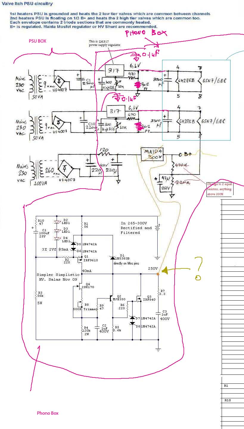

Thanks for the input. your reply brings me to my next question. What do you mean by upper tier and lower tier tubes?
I apologize, most of my building experience has been using a pcb so I'm still trying to learn.
If you look at the schematic in post #31 there are two tubes near B+ and two tubes near ground. Since two heater regs on different elevation were used in those builds, they shared one 6H2 and one 6SN7 between channels for the upper side since each bottle's got two triodes, and one 6H2 & 6SN7 for the lower side.

Can you glance at my scrawl attached just to make sure I have interpreted what you are saying correctly. I am planning on using the power shunt and hopefully have captured this correctly, plus as you advise will move some of the PSU circuitry to phono box as shown.
Secondly I have been looking at the heat sink requirements and trying to work out how many need in total and where. The 317's need them, without being too scientific about it these looked like they would be big enough? AAVID THERMALLOY | Semiconductors | Sockets and Heatsinks | Heat Sinks | Transistor Type Packages up to 48°C/W |6296B. They are rated 4.7 '/W whatever that means.....
I think there are some more heatsink requirements in the power shunt but not sure where or how big. Judging by the pics posted in this thread another one of the above sinks may be needed?
I am no expert and just need to be cautious that I am not being stupid!

Your draft is correct, just don't use the 3300uF since your heater regs will be inside the phono, use 100uF. The 4.7C/W sinks for the 317s look big enough. Now for the B+ shunt reg: Give it 320-350V in and 300V out. Set it at 35mA. 10mA will go to both phono channels total. 20V-50V(in-out)x0.035=0.7-1.75W. Using the same type 4.7C/W sink for the input CCS Mosfet will up 8 degC from ambient mostly. Well. Things are different for the output Mosfet. Has to dissipate for 35-10=25-3=22mA (3mA is for the Jfet and BJT inside) times 300V. 6.6W constantly. That will up 31 degC on the 4.7W/C type. Think of a hot box inside (tubes, heater regs, closed) plus that. Maybe 70C or more in the end on that sink. No. At least double that sink's size for the IRF840. Example. Use 105C elcos for everything chemical caps inside the phono.

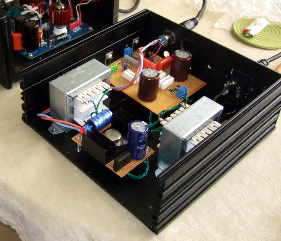

No looking further, that link leads you to the right one. Here is an example I made once for giving +HV & heaters juice to a tubes phono, taking the place of its stock tubes regulator box. Has the perfboard build shown in the link. 320VDCin will suffice for 300VDCout. Use 1N/UF4007 1000V PIV diodes in the rectifier bridge.

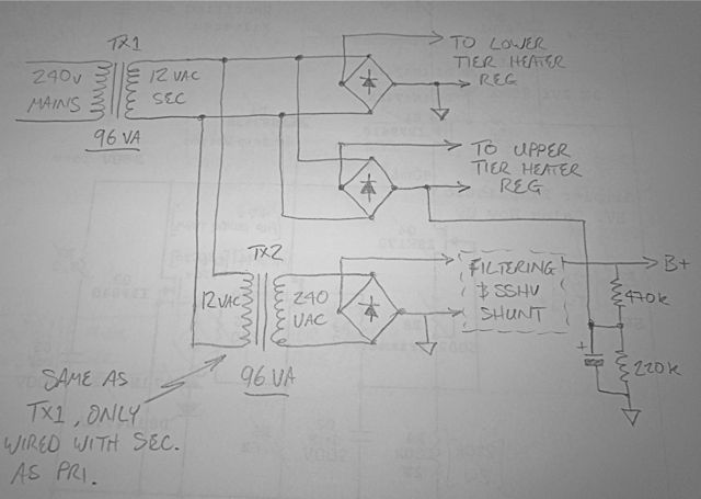

I'm having trouble sourcing a suitable transformer for the HV shunt. I pretty much need a 240v primary / 240v secondary as I'm aiming for the 300vdc reg output, and the original power supply sketch in this thread calls for 100VA.
A few questions:
- 100VA for the HV transformer seems large compared to what I am able to commonly find available. Is there a specific reason for this rating or can I safely go smaller without too greater sacrifice?
- Some power supply designs I've seen achieve low voltage for heaters and high voltage for B+ by using a step down Tx, say 12vac secondary, then a similar Tx wired in reverse to step the voltage back up. Would such a scheme work here (or anywhere)?
- Two 9vac transformers have been specified to supply the LM317 heater regs. Are the two needed as the regs don't share a common ground reference, or could 1 Tx be used so long as there are two rectifiers?
I can source cheap 96VA multiple output (6-12-18-24-30 Vac) transformers in metal enclosures with fuse and power lead. Could I use them in the configuration shown in the attached diagram?

What you saw it was a description of how that PSU was made with transformers stuff that were available and not strictly a specification. Anything 30VA will be more than twice what a single 40mA CCS setting shunt reg will consume at those voltages. About transformer tricks I don't know much to guide you. Looks logical your plan, but I prefer others who have done such may comment. I just say use whatever easily available that will give you the proper voltages and currents. Use two 220K resistors in that schematic for 1/2B+ heaters lift in the newer phono circuit values changes. Fuse to the transformer's rating and be careful with high voltages.

Hi Tani
I have used 'back-back' transformers for valve projects and they work fine to get your HT.
To judge the final output voltage can be tricky, but more is generaly best, and OK for regulated circuits.
Think of the primary/secondary 'ratios' ie 240v/12v = 20:1
Then if you add a reversed 12v/240v = 1:20, you get back to 240v again.
If you calculate the ratios, you can work it out for any volt combination.
In my recent valve mic project I used a 9v & 15v, as the 'ratios' worked out good for my HT volts.
The thing to watch out for is the current rating of the 2nd transformers reversed windings.
The first transformer must have high enough VA & volts for heaters (I used 9v here, as this is fine for 317 style reg (12.69v @ smoothing caps).
The reversed transformers rating is slightly different, as 1amp/12v secondary rating, means primary is only rated at 50mA/240v etc.
So don't get caught out with a low rating there.
I try to allow for my actual wall voltage (230v),
Ratio of back-back transformers,
Diode drop (hardly worth considering at HT voltages),
Volts at my smoothing caps will be approx 1.41x final transformer ouput voltage.
This method has been disputed, but unless your running a difficult load, like an arc welder, it's always worked fine for me.
I believe Salas's shunt can take quite a high input, so I guess aim half way between this and the 'Itch' HT volts. BINGO.
Hope that makes sense.
Cheers
Simon
