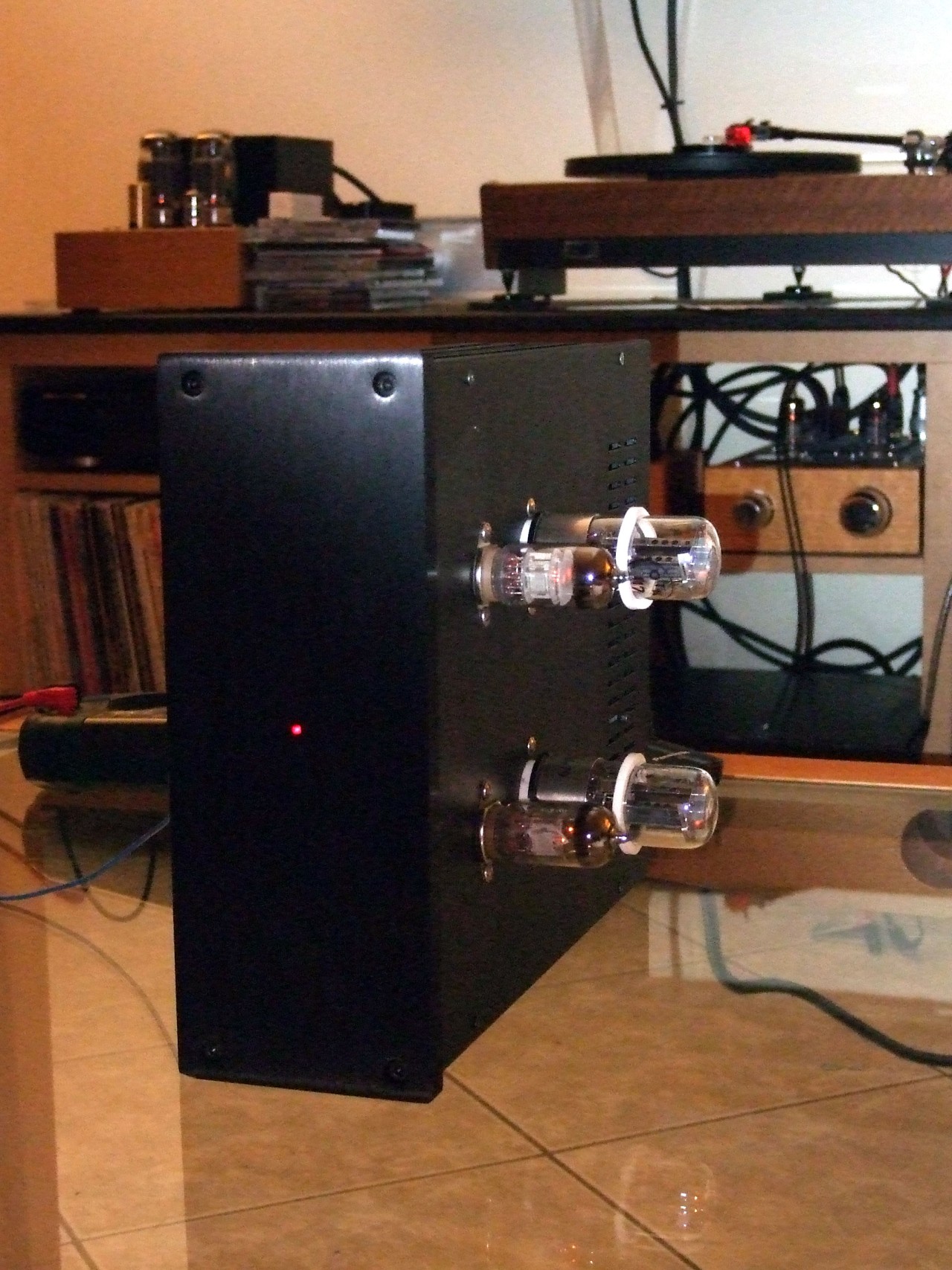

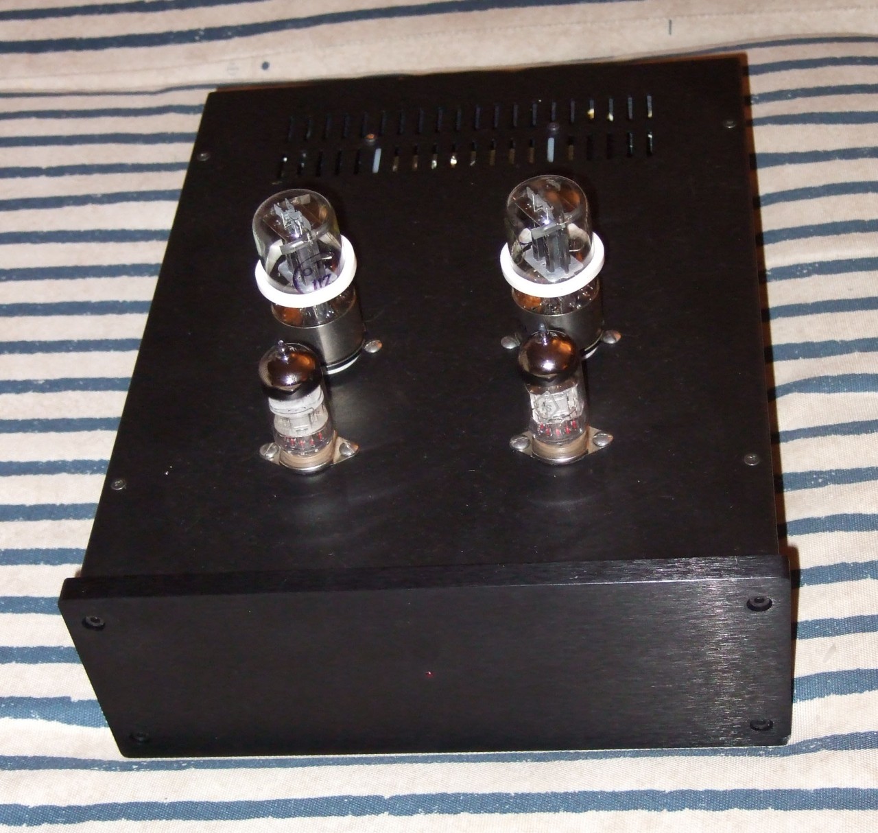

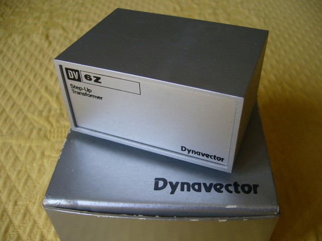

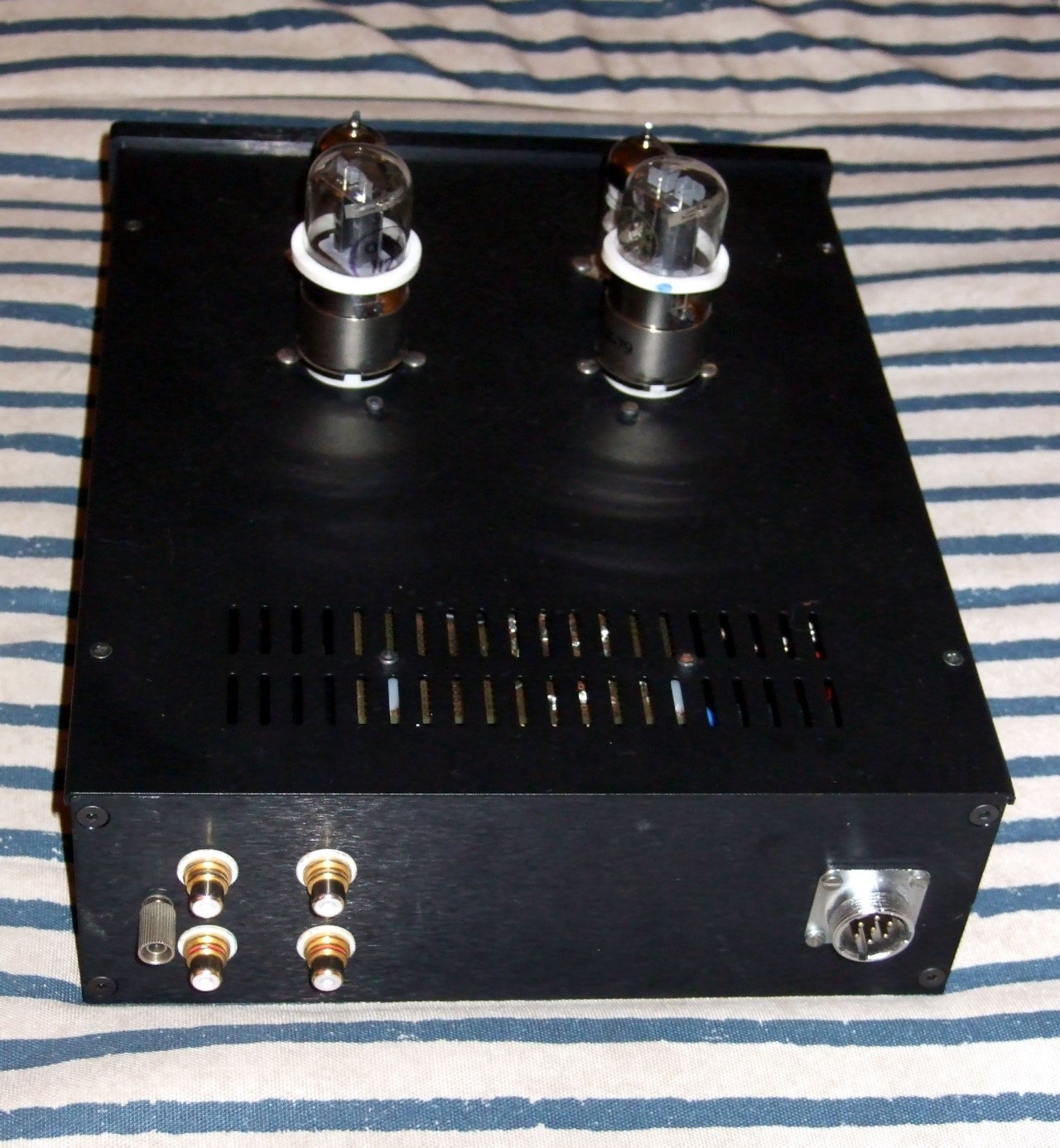

It has a Dynavector DV6Z step up taken out of its original box and put inside as the silver cylinder in the pictures. Also a Simpler Simplistic HV and two filament regs in the same box. Another box houses the transformers and the rectification/filtering. Feeds DC lines to the regs through a cable to that multi-pin connector which can be seen in the back panel and underside pics. The PSU is like in post #3. Changes are my HV shunt reg instead of the Maida, and equal value resistors in the heater lift network since the upper cathodes sit higher in this revision. Either the tube model's Rp/Miller played a role or the SUT shapes response, but we took out the extra 1nF Silver Mica across the *15nF nominal MKP Arcotronics Riaa caps after we measured its filtering curve with pink noise. Listening before & after confirmed. It hits 0.08% with 2mV input without the SUT, second harmonic only. 0.1% with 0.5mV and SUT. We just swapped the output Melz 6H8s between channels and a couple of 6N2PEVs for the lower tier input valve and got 0.33dB channel gain agreement. Noise floor in both cases starts at -80dB at 20Hz and falls to -120dB at 20kHz following a Riaa like attenuation shape. That is for 0dB=1VRMS calibrated. Sounds really quiet for a valve phono. Plus you can hammer it and get zero microphonics. Actually Michael had it fallen from 1.5m height to concrete floor while playing and did not make a sound other than music. Subjectively he is head over hills with it. I find it very nice too. Its better than the first easily. Will listen to more records with it in an audition only mates gathering soon.:note:

P.S. Here is a pic I found on the web so for people here to see what was that cylinder in its former life before I donated it to the Itch.
