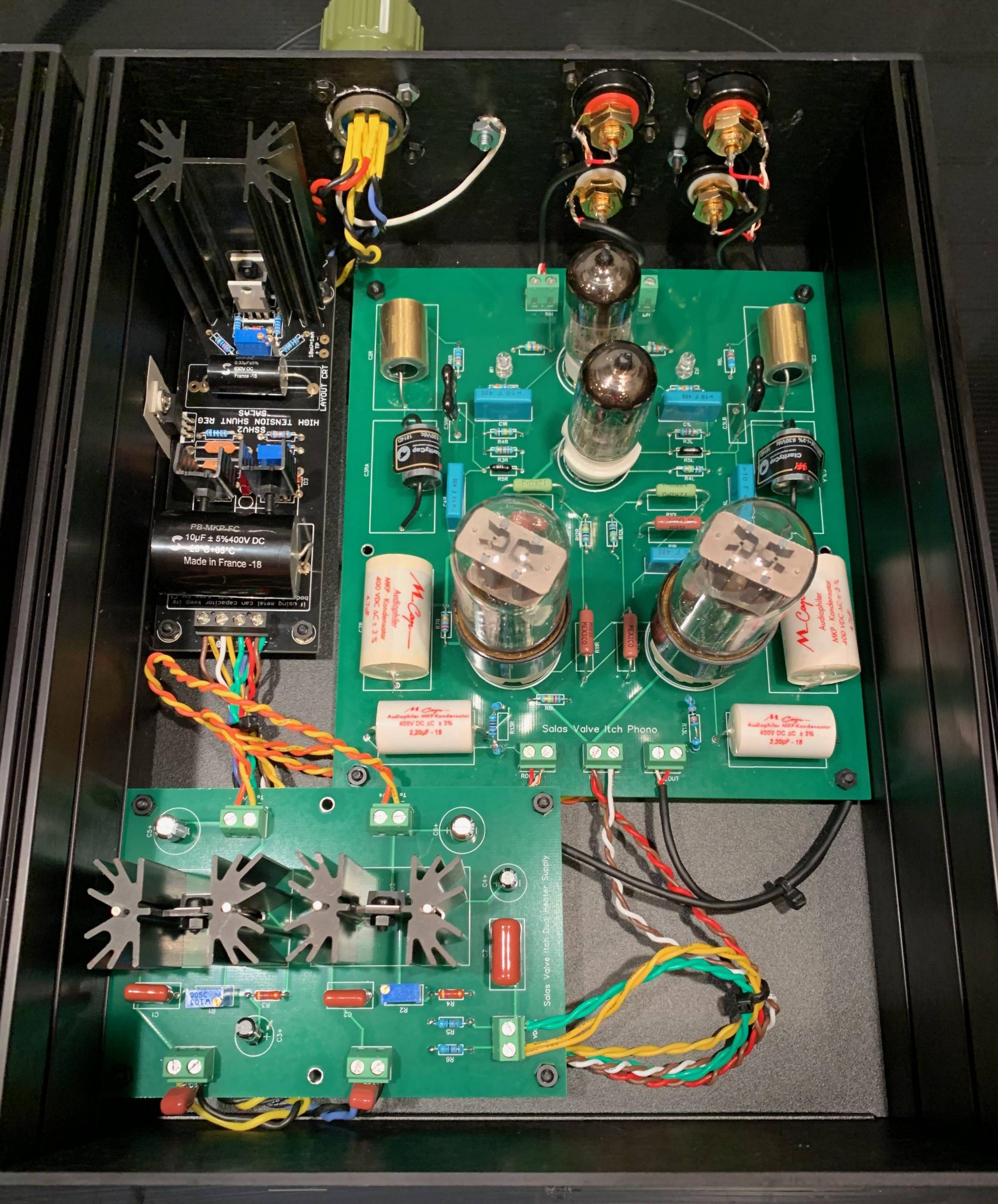

I will start building this design on Jake's PCBs as soon as I receive the boards. In the meantime, I am gathering some parts. It would have been nice to integrate the SSHV2 in the power supply but I have not been able to find a source for the SSHV2 PCB. Does anyone know of a source? Would appreciate any assistance.
Salas thank you for referring me to Tea Bag. I contacted him and was advised to sign up on his subscription list to receive the board which contains many other attractive projects highly recommended to all DIYers. The SSHV2 with its remarkably low output impedance is a practical implementation to any power supply. If like me know have been out of touch with the forum or are new to the forum, look up SSHV2 and sign up on Tea Bag's list to receive your board(s). I searched the web to source an SSHV2 PCB but it seems like everyone who at time point carried the board is out of stock. Seek Tea-Bag!

Is there instruction how to correct original heater PCB to include Salas recommendation regarding grounding?

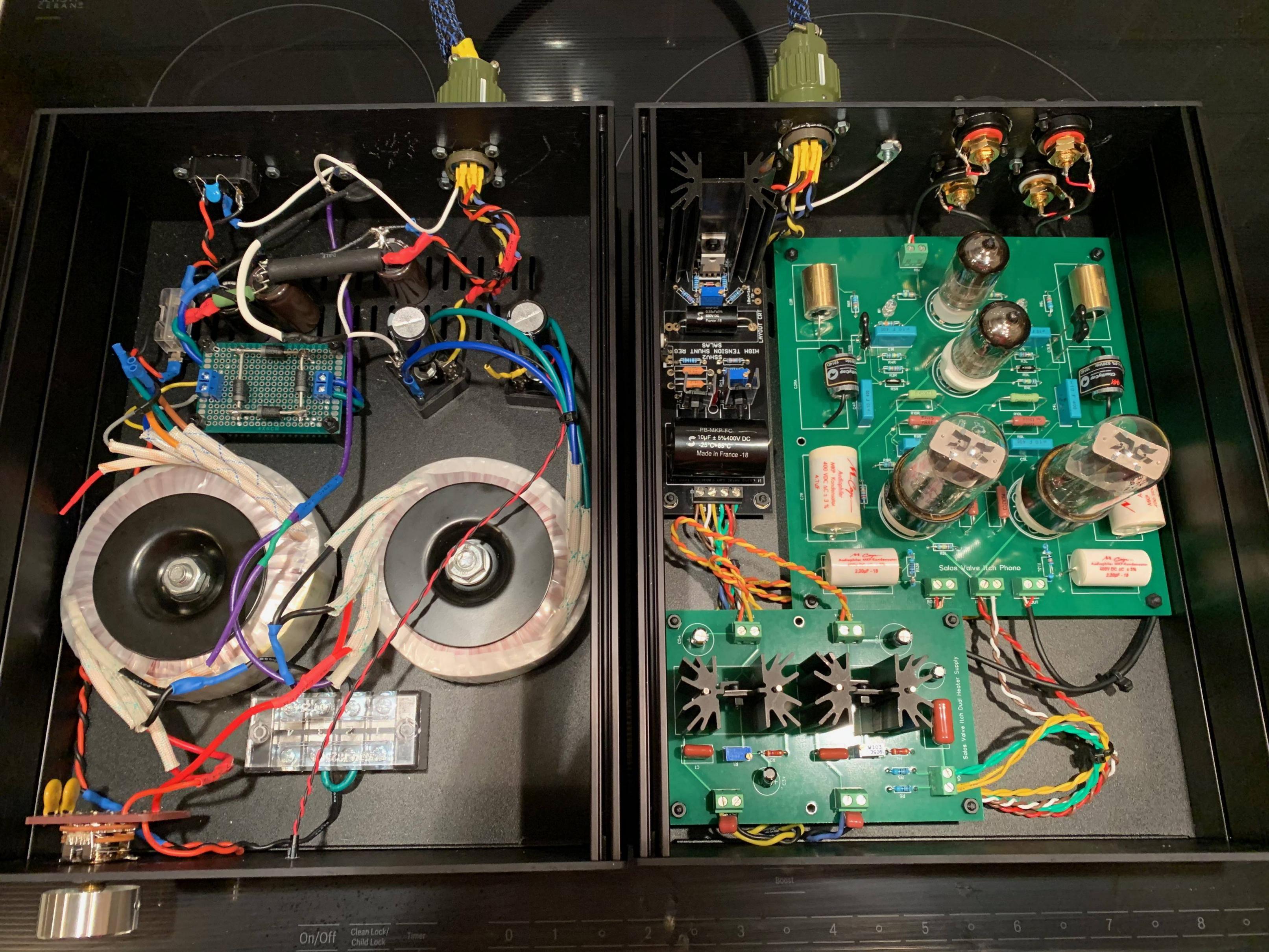

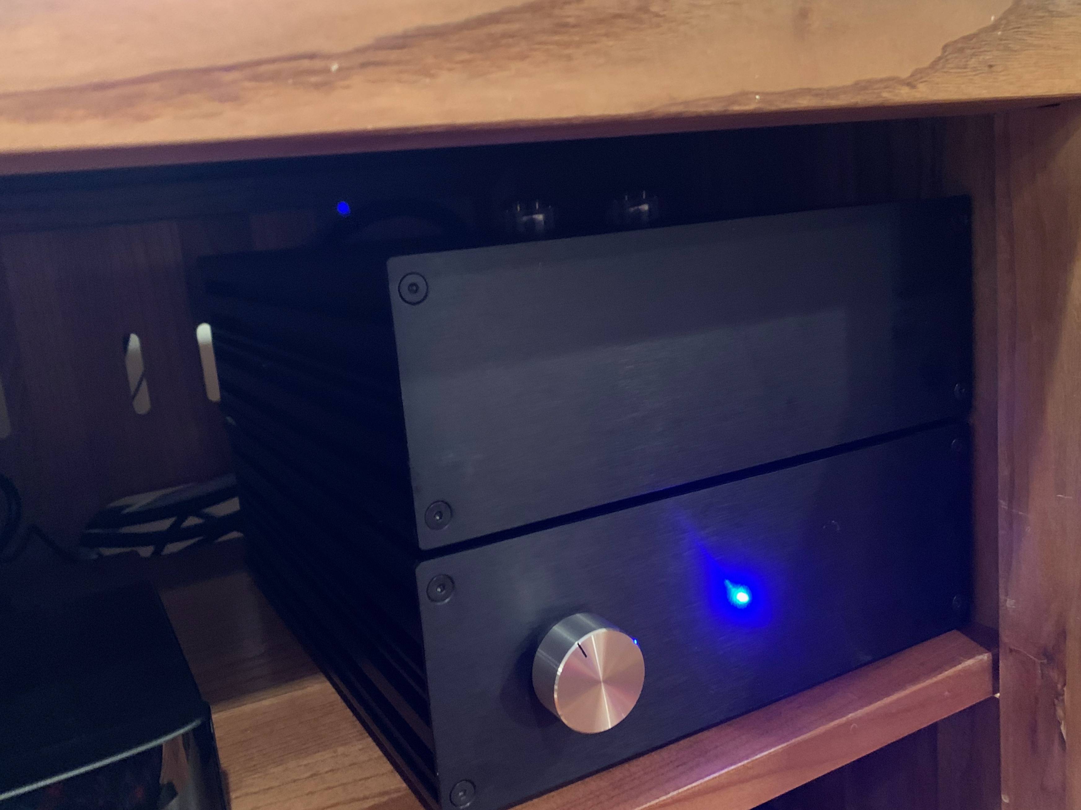

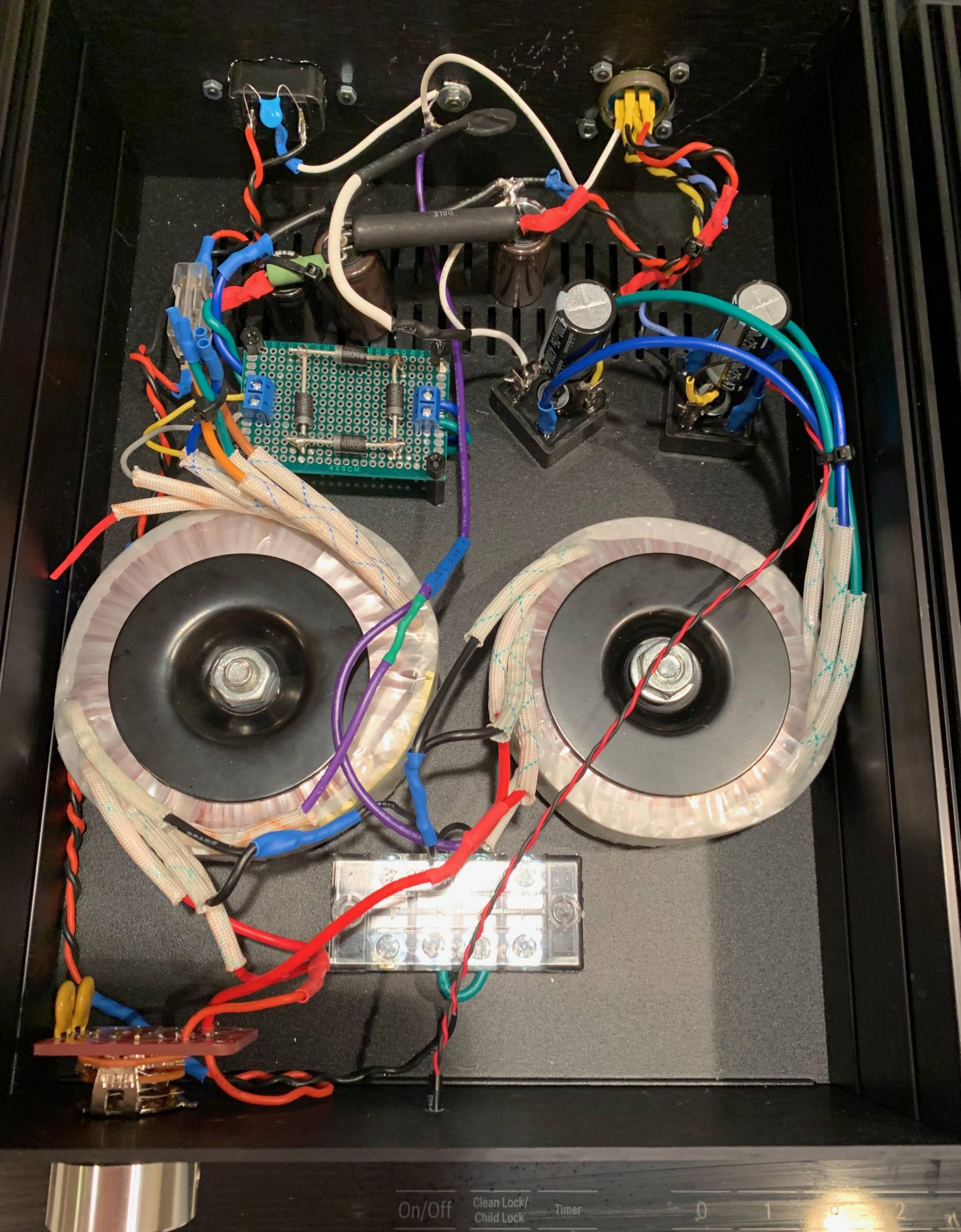

Finally done with this build! It's remarkably quiet -- I'm very pleased. Just giving first listen now. Impressions to come..
Congrats. Do the big valves pop out through the top in a 2U case? Did you measure the channel balance?

He said it was a graphical mistake in his schematic but ok in the actual board I think. He will confirm this or not.
Big tubes pop out about 1/2” or so on the 2U. I haven’t measured the channel balance yet. Can you point me to your recommended technique for that?
Elevated heater is working correctly on the board. The V3/V4 positive is 153v to V1/V2 GND.
Congrats for the build. Waiting for your listening impressions.
Divide 0.5V RMS 1kHz sinewave output from a function generator by hundred times first. Make 10k series 100R to ground L-Pad from resistors you have around. Keep the divider small and neat. Use coax. The divided signal will represent a 5mV MM cartridge. Don't get tempted to use the generator directly as source at 5mV because it will be much noisier. Between the 100R and ground send input signal to both Itch channels.
Connect the Itch outputs to a dual channel scope. Compare them. Then do swaps with the valves as I wrote to you in post #3269 and try to match the sinewave outputs amplitude the best possible on the scope's screen.
Direct equivalent noval to 6SN7 is 6CG7 which is 68mm tall vs 86mm tall incl. pins.
Thanks -- I'm actually pretty happy with the 6SN7s poking out a bit.

If it sounds not obviously unbalanced in volume between channels its probably good enough already. But surely check sometime. Because there is no negative feedback loop gain control to guarantee a matching gain ratio for L&R in this design. Channels nearness is based on the μ nearness of the tubes themselves.
