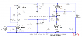

Now I'm using a volume with switch ladder resistor of 100K so the source always see 100K, i'ts in a small box between the Itch and the preamp: could be the source of ground loop?
Salas Itch must be chassis grounded at the input?

Not necessarily where the ground is shown, that's symbolic on the schematic. In high sensitivity valve builds we usually run a thick ground buss and we attach it to chassis at the input end.
You had a quiet Itch for years I think, is this a new build, or the same one developed a buzz?
It started right after you changed the raw DC capacitors from 400uF to 1640uF? Maybe a rectification diode broke from the inrush current, or the regulator developed input side oscillation? Or a new high power on transient hammers it and breaks some of its parts? Check the whole DC chain for broken parts, or if you don't find any, for incompatibility. See what happens if with series resistor between the two 820uF, or with smaller raw capacitance, reg input connector film cap decoupling needed or not etc.

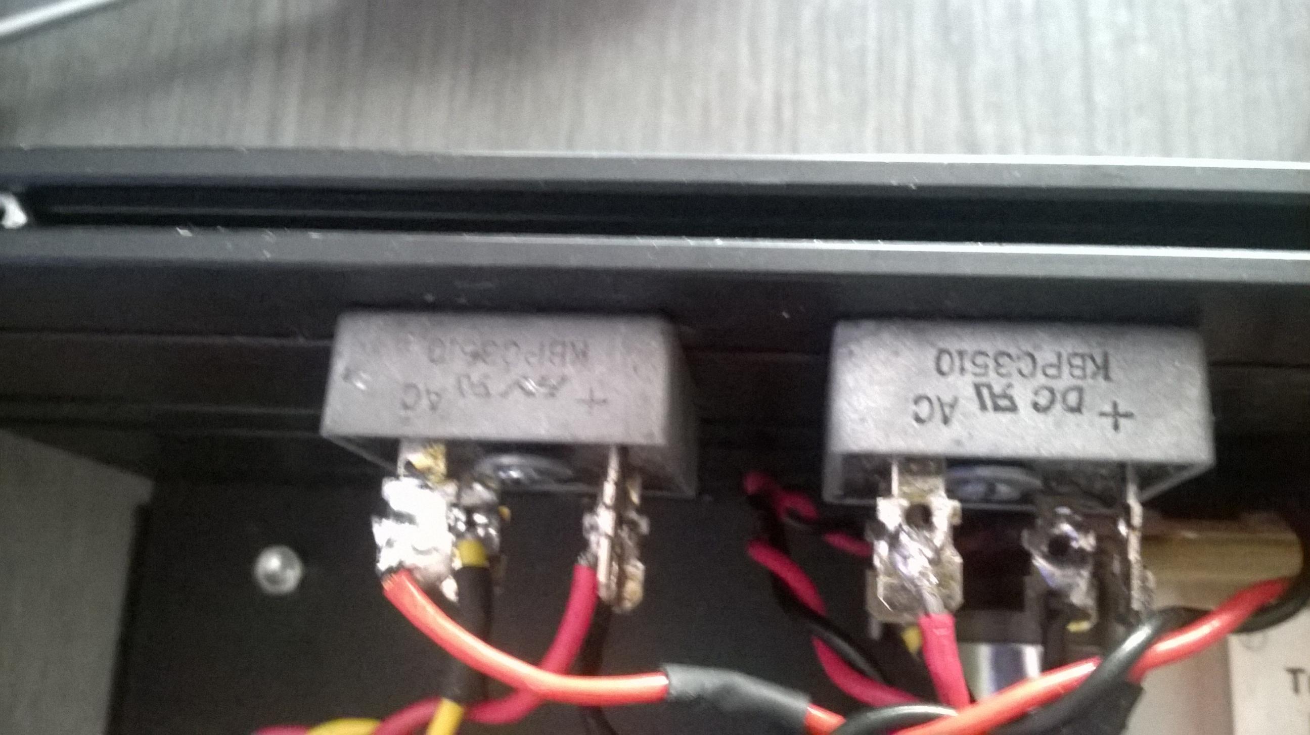

I'm sorry before PSU capcitance wasn't 400uF, was 840uF (2 BG 2 x 100uF each 200uF = 400uF + 1 Elna Cerafine 2 x 220uF = 440uF)
Also changed the two bridge rectifiers for DC heaters, attached pic.

From Itch's input side signal GND buss bar connect a wire to chassis (only one ground wire point to chassis for the whole build). TT ground wire connected to the chassis also with a ground lug thumb screw or a 4mm banana plug. Must make contact to the metal, don't use insulators for the TT ground preamp's chassis terminal.
