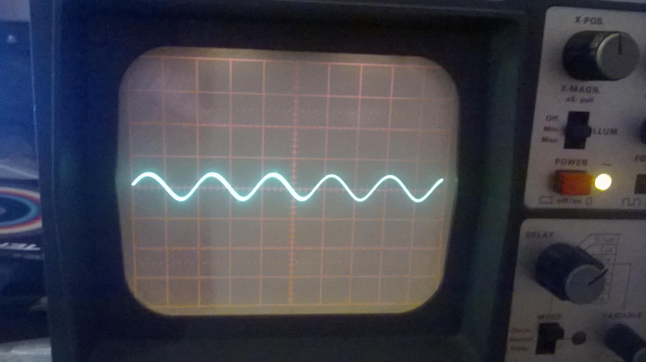

So what Kevin's table tells you for those new figures? Any better pF?
0.4/2.8 = 0.14285 ratio log = -0.84509 x 20 = -16.90196dB = aprox. 110pF including RCA connector, internal wire and Miller input capacitance wow🙂
Now I have 110pF phono stage + 220pF turntable RCA wire & RCAs = 330pF🙂
Have I done well the maths?
This looks like a huge improvement, and I think in line with what Salas predicted earlier in the thread.
How does it sound?
How does it sound?
Put a decoupling capacitor across its DC input connector. Maybe the input wires coming from raw got too long.
Salas what value? Lytic or MKP?
1uF MKP first choice. When it does the wire decoupling job well, only proven on the scope, its a keeper and very good material.
That's about having local reservoir so close to the DC input. What you want as a minimum is not to have oscillations due to long incoming wires inductance as you saw on the scope after the build rearrangements and you cured. Use maybe both if you find it enhances your build subjectively. Reservoir lytic + bypass MKP combined decoupling.
