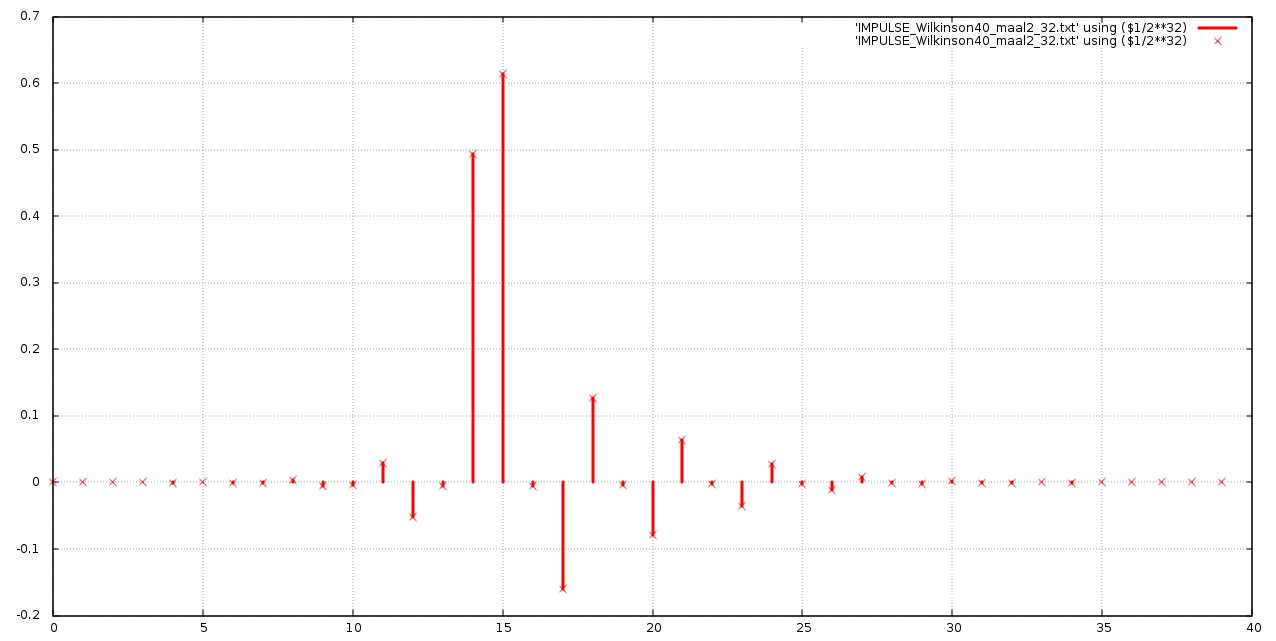

I would like to have an idea what a super DAC does reproduce a burst of 20khz of 1ms. Can you picture a scope image?
I later found a way to interpolate between the ratio of ten and ratio of infinity values from Zverev, but I'll get back to that later.
See the attachment.
No, as I never measured my DAC's response to 20 kHz tone bursts. If I should find the time to measure it, at what sample rate do you want it measured and with or without anti-aliasing filtering? When you switch a 20 kHz carrier on and off with a 500 Hz square wave (my scope has no single-shot function), there will be sidebands at odd multiples of 500 Hz above and below 20 kHz. Normally the anti-aliasing filter would suppress some of these during recording, as otherwise they alias.
The impulse response of the digital part of the original valve DAC in the steep mode is just a long sinc-like response. The analogue reconstruction filter will cause a very small asymmetry, as it smears out the end of it a bit. The response to anything else than an impulse is then the convolution of the signal and the impulse response.
In the apodizing mode, which is only meant to be used at high sample rates, the impulse response is as shown in the attachment, but then with smooth lines between the points and with a bit of smearing out due to the analogue reconstruction filter.
