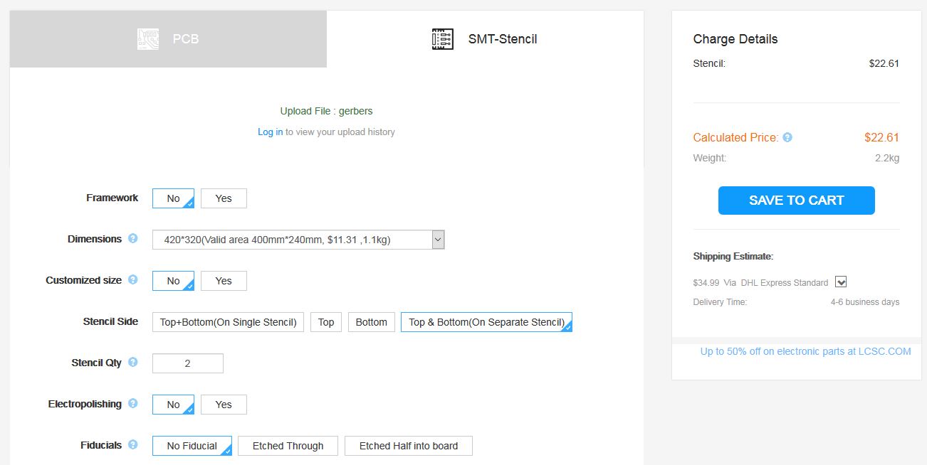

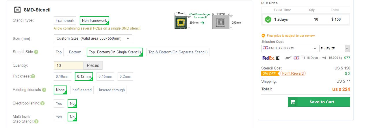

Any chance that we may consider smd assembled from manufacturer and/or smd stencil?
Good to have you on board (I just punned! 🙂 )
Whilst I'm happy to get the PCBs fabricated by our Chinese friends I would prefer to purchase the parts from a supplier of known quality - I provided a DigiKey basket for the SMD part BOM a few posts back.
Marcel thoughtfully designed the PCB so that the pads for the SMD parts are for hand soldering, so a little larger than the standard pads. I can include an SMD stencil when I place the PCB order and you guys will have to pass it around amongst yourselves, which would limit progress, or I can investigate multiple stencils as a costed extra for those who want one? An alternative for those who want to use a stencil with a hot air station or reflow oven would be to buy from JLCPCB - their stencil costs are very reasonable. Before someone asks, JLCPCB aren't an option for purchasing the boards, they would be cheaper than PCBWay but can't do the custom layer stack that is an intrinsic element of Marcel's design.
BTW, if you are thinking along the lines of using a stencil, the larger part of the smd soldering is on the bottom of the PCB.
I have a friend who did my smd hand-soldering and he offers that as a chargeable service - I have aked him for his price per board as I thought some subscribers may wish to take up that option. We did look at using a stencil and reflowing the board but it's too big for his oven.

@ Ray, I think the option for purchasing a stencil would be good.

It looks like a stencil will cost around $25 each if I order with the PCBs (actually probably a bit less as I imagine the shipping cost for a combined order will be advantageous) - check out the screengrab below for info and please advise if any of the options I've selected are incorrect.
The stencil will be large so I imagine will will push up the shipping cost when I distribute the orders.
