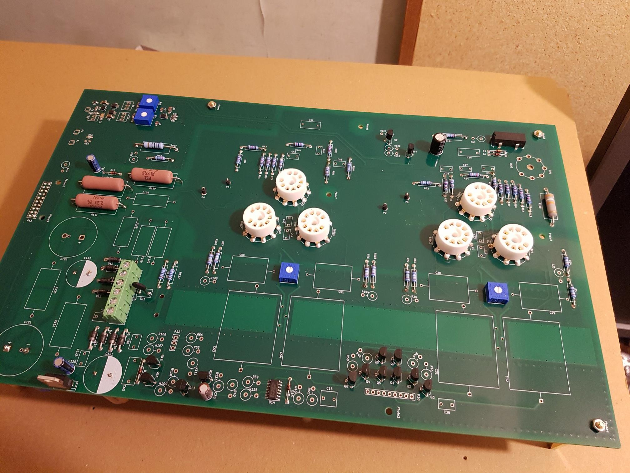

A bit more progress on the main PCB

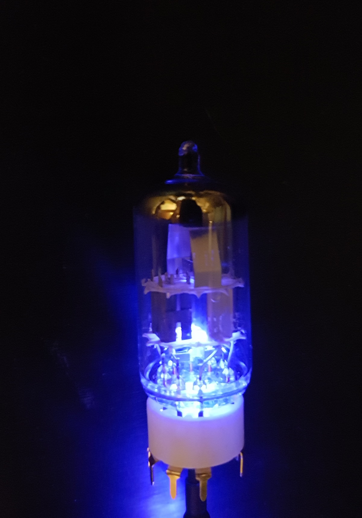

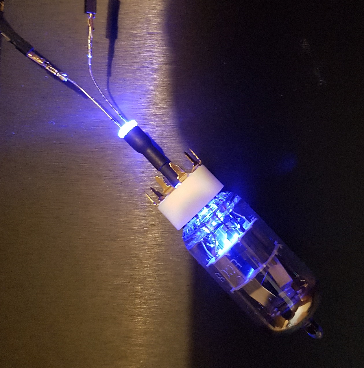

The bling is progressing too...
The light pipe that JPS suggested works well. The hole in the valve socket is a little large for the 3mm light pipe so I had to epoxy it in place. For now I have a 5mm purple LED attached to the light pipe with heat shring tubing but a friend has offered to 3D print some fittings so the arrangement is a bit stronger.

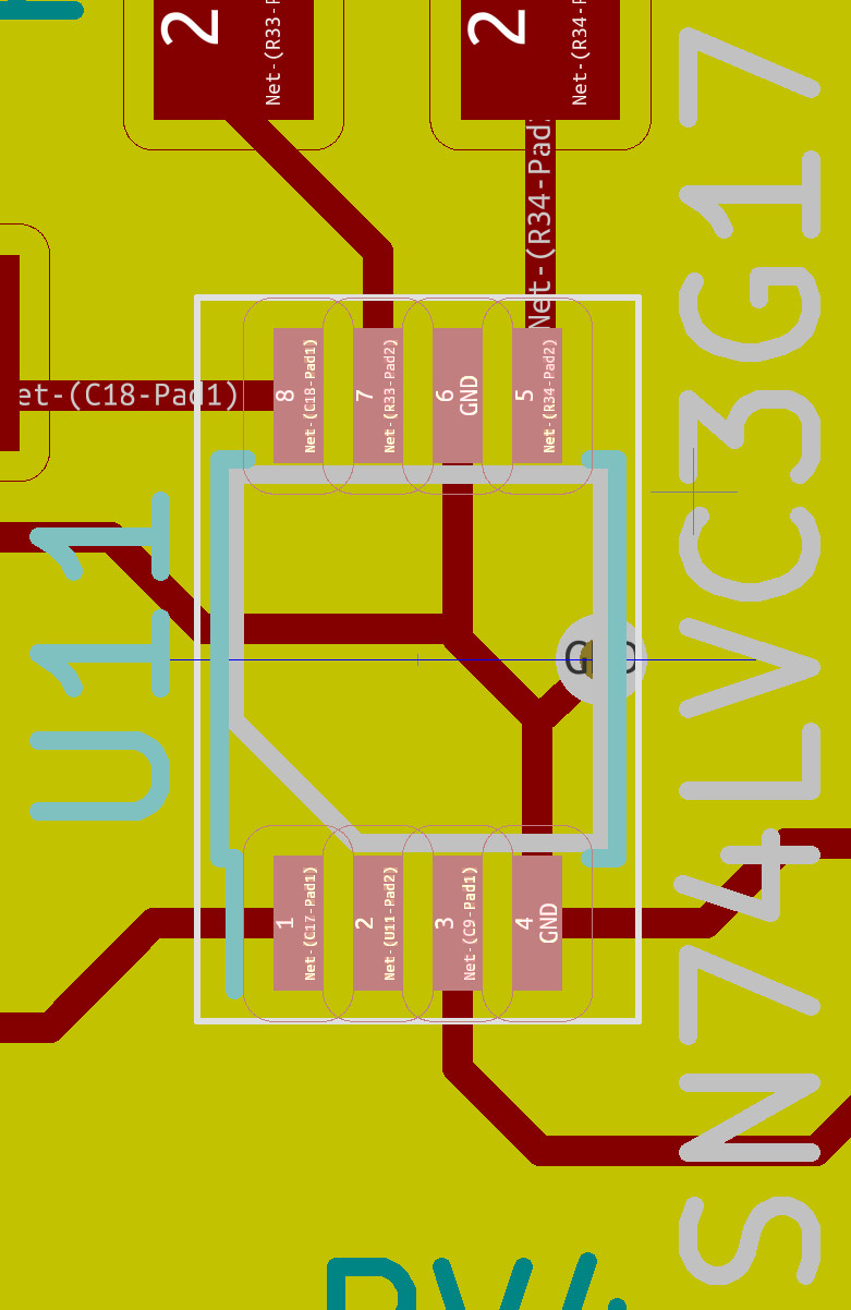

Bridging gaps too far
You have raced ahead there Ray and its looking amazing.

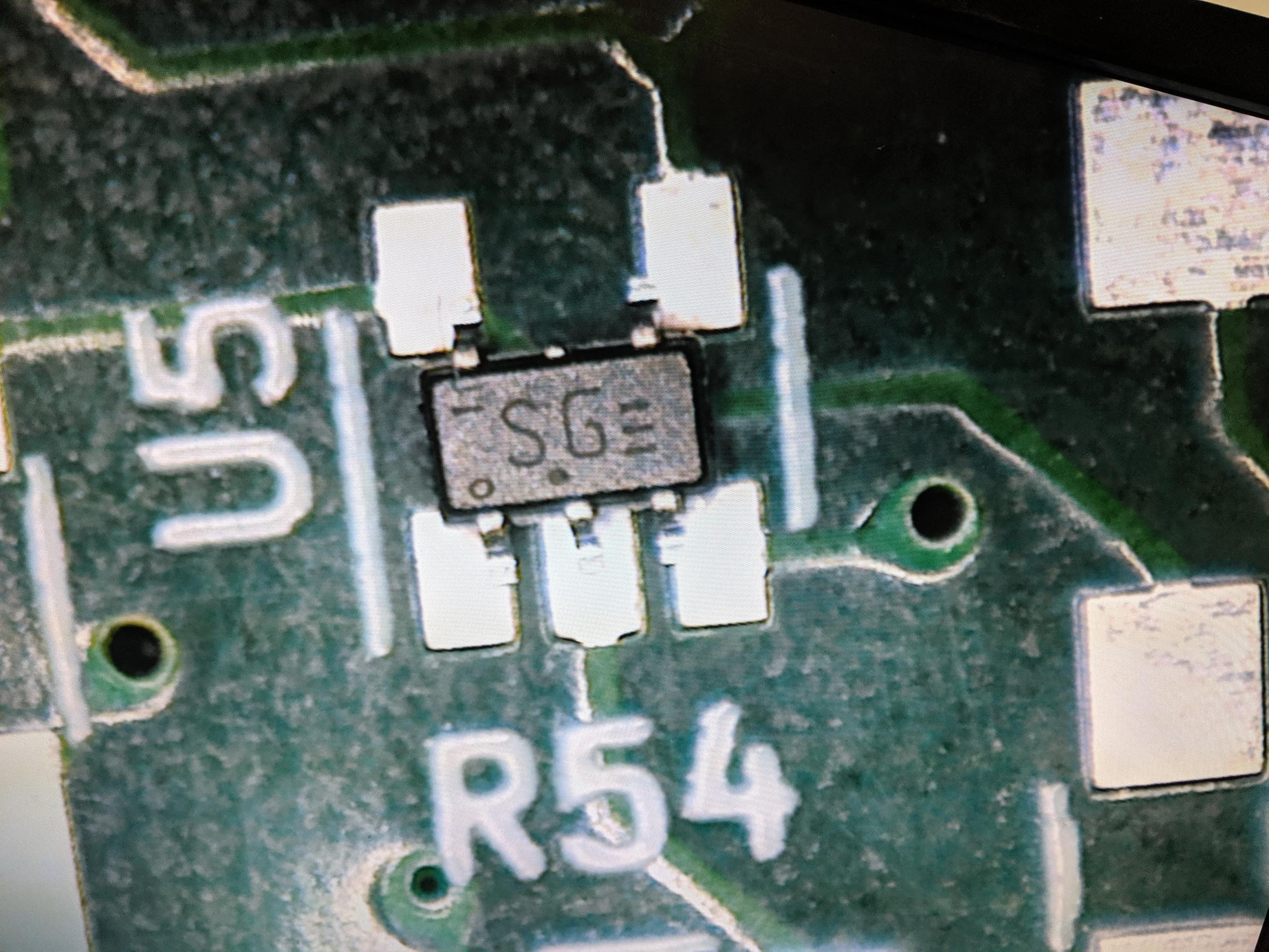

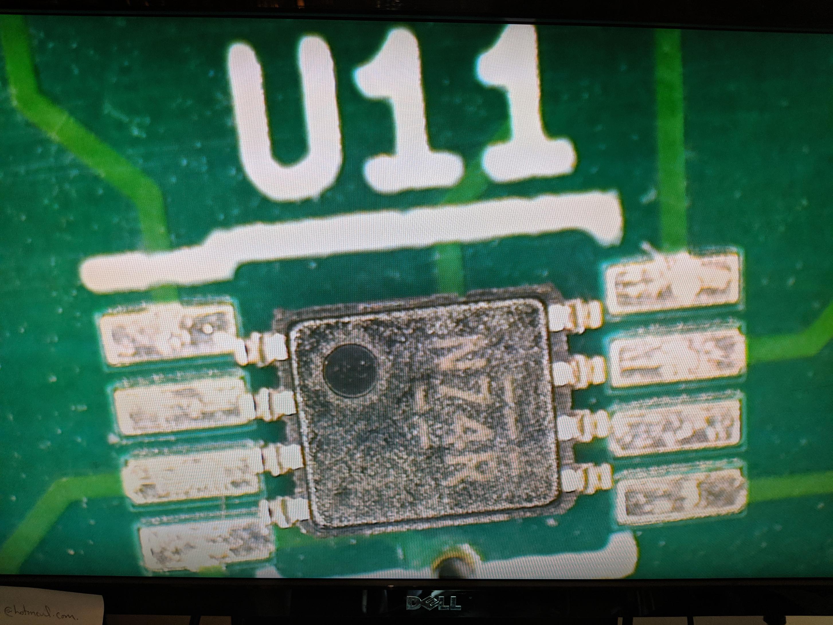

I have been slow to start due to (place excuse in here) however its the first time I doing SMD's but this is looking a little wrong to me.
Am I supposed to be bridging gaps this far....
Oh, that's a shame! Most SMD parts are available in different footprint-incompatible packages, I usually chose relatively large types to make soldering them a bit easier. The BOM list shows what footprint was used for what component. To make the mess complete, many packages have more than one name.
By the way, the BAS70 Schottky diodes come in different packages and in single, double, triple and quadruple versions. What you need is the single version in a SOT-23 package.

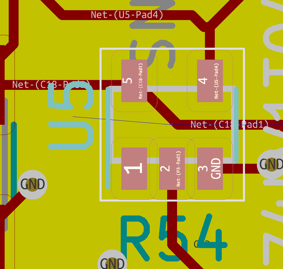

With confidence knocked on these SMD’s, I'm almost sure this is the correct part as there are only two variations and one is the wrong foot print. its U5 74LV1T04 of which I have the GWH variation.
