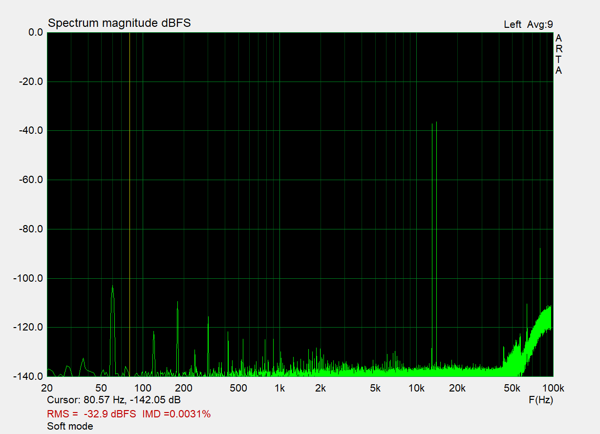

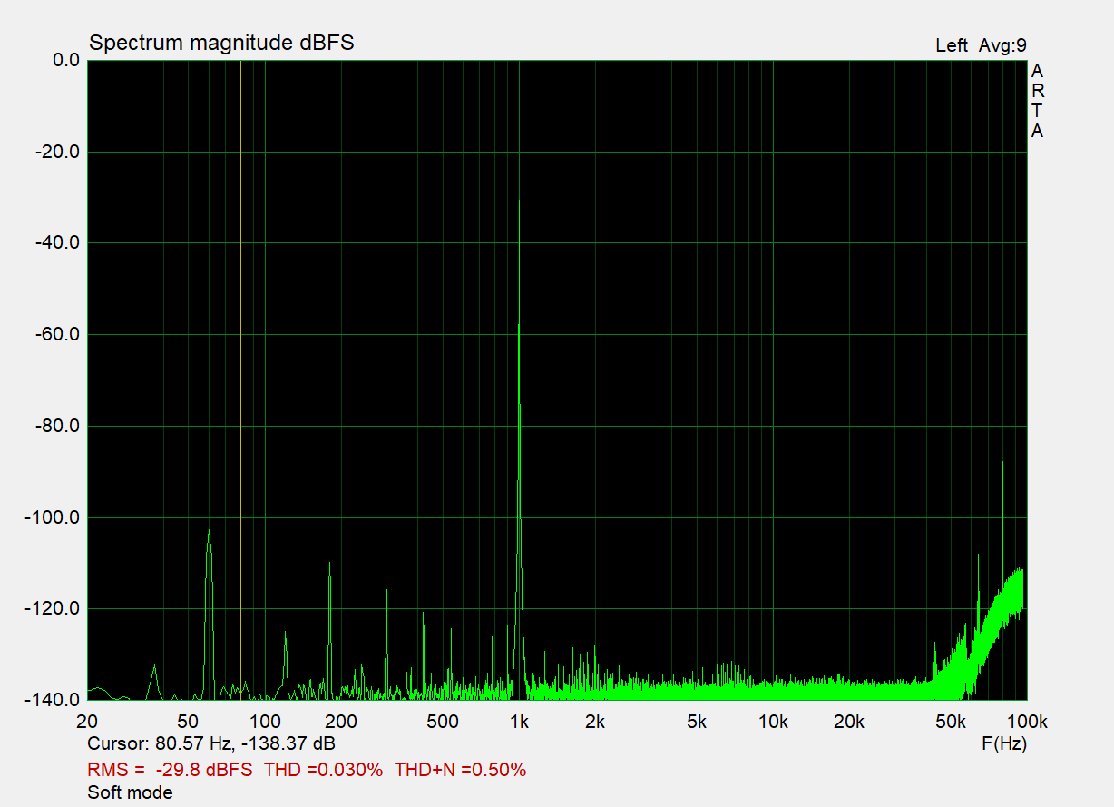

Time for some measurements!
Of course, taking to account that my simple homemade system: I use a PC with a Asus Xonar with some ampop mods for measurements, directly on it, without preamp or suchlike.
The measurement suite is the ARTA, running in W10.

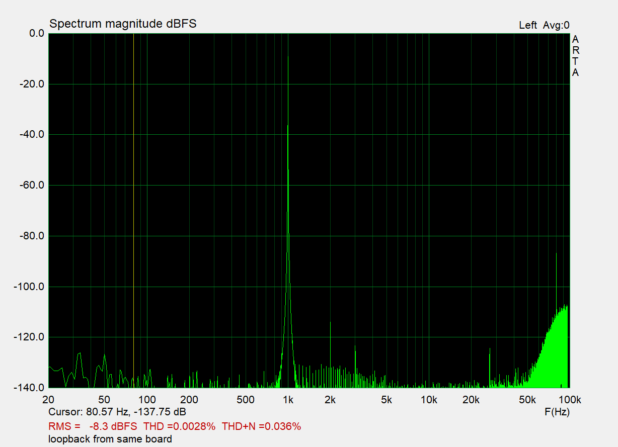

First, the limits of my test system:
With own Xonar loopback:

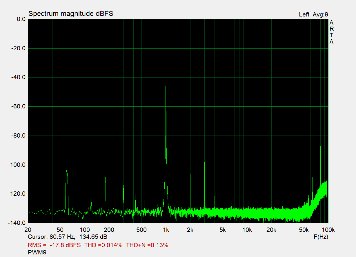

Now, some Valve DAC results:
PWM9, loud mode:
Soft mode:

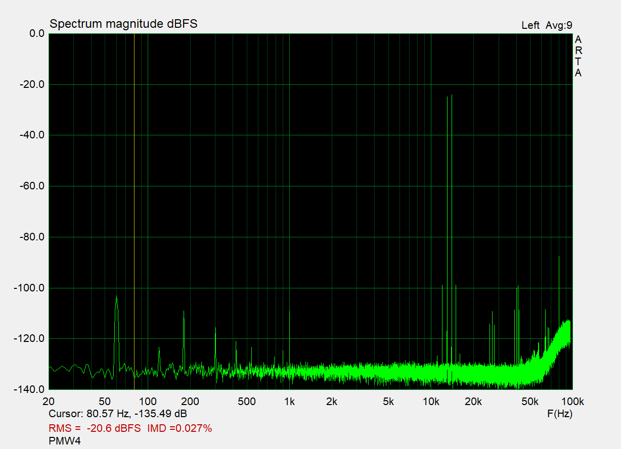

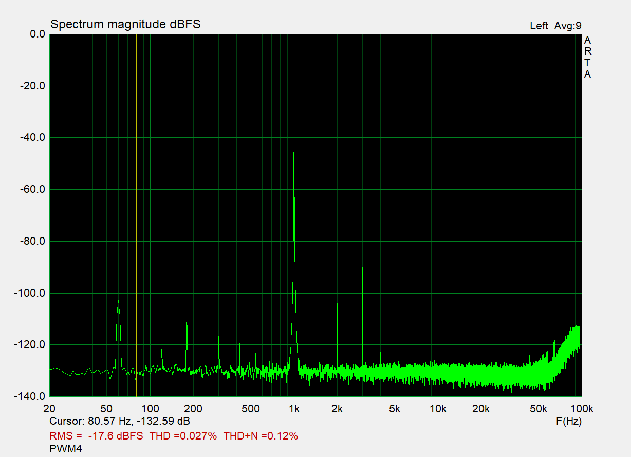

PWM4, loud mode:

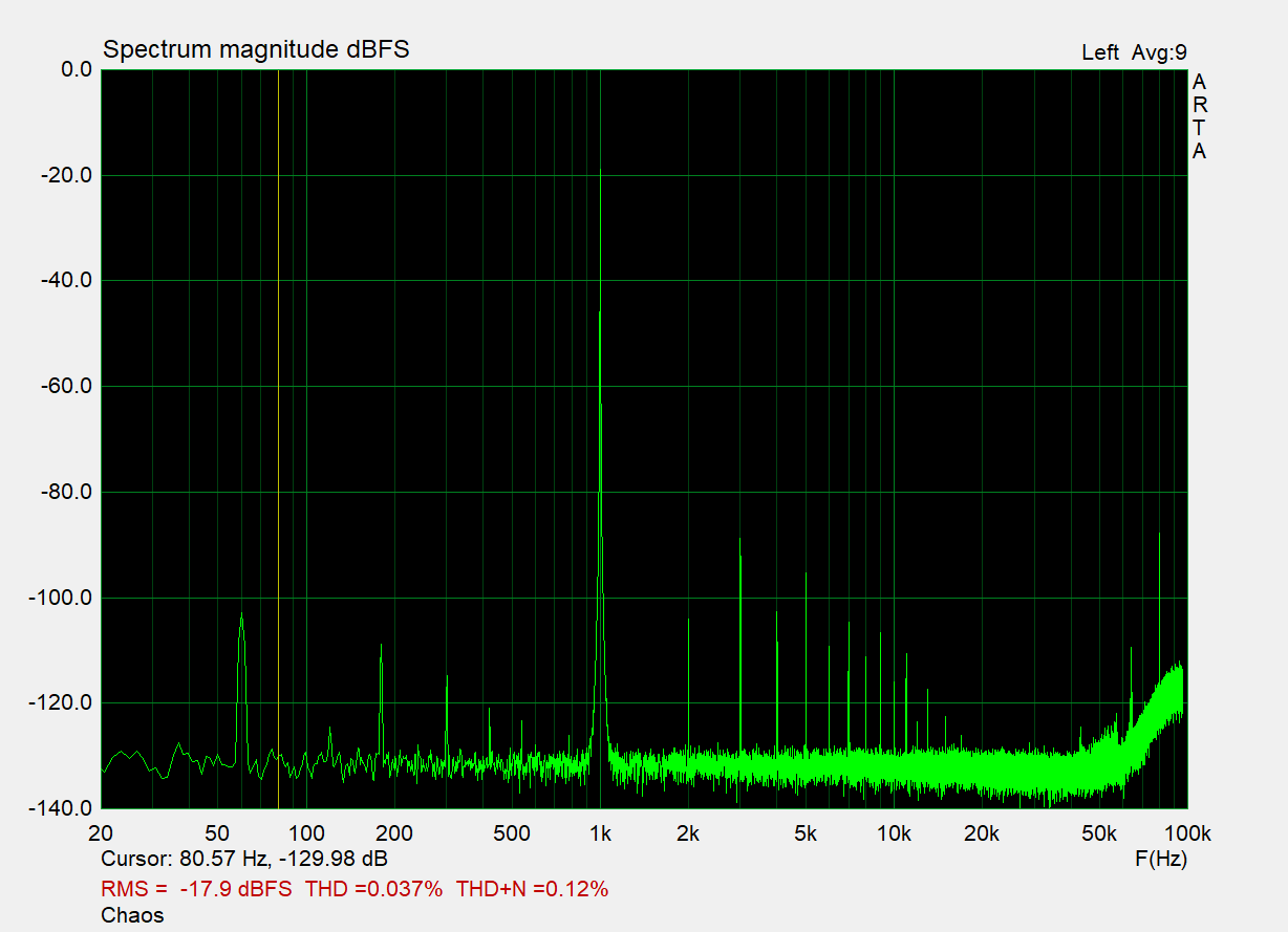

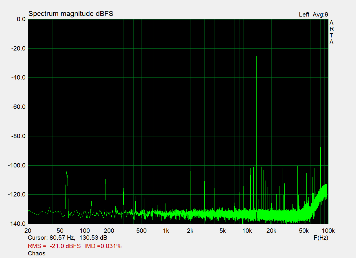

Chaos:
Harmonic distortion vs frequency (PWM9, loud mode, -1dB signal):

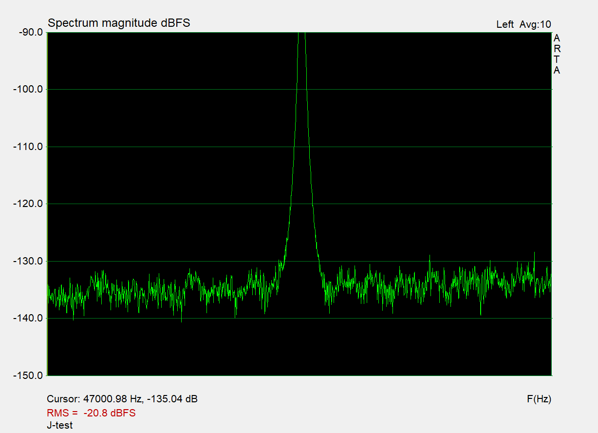

J-Test (24bits, 96kHz):

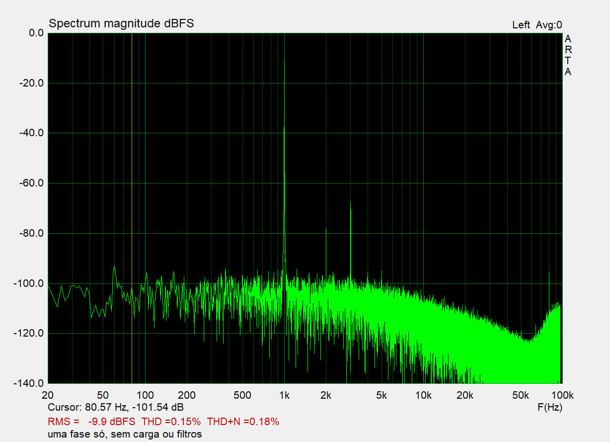

Output without any filter or load (raw):

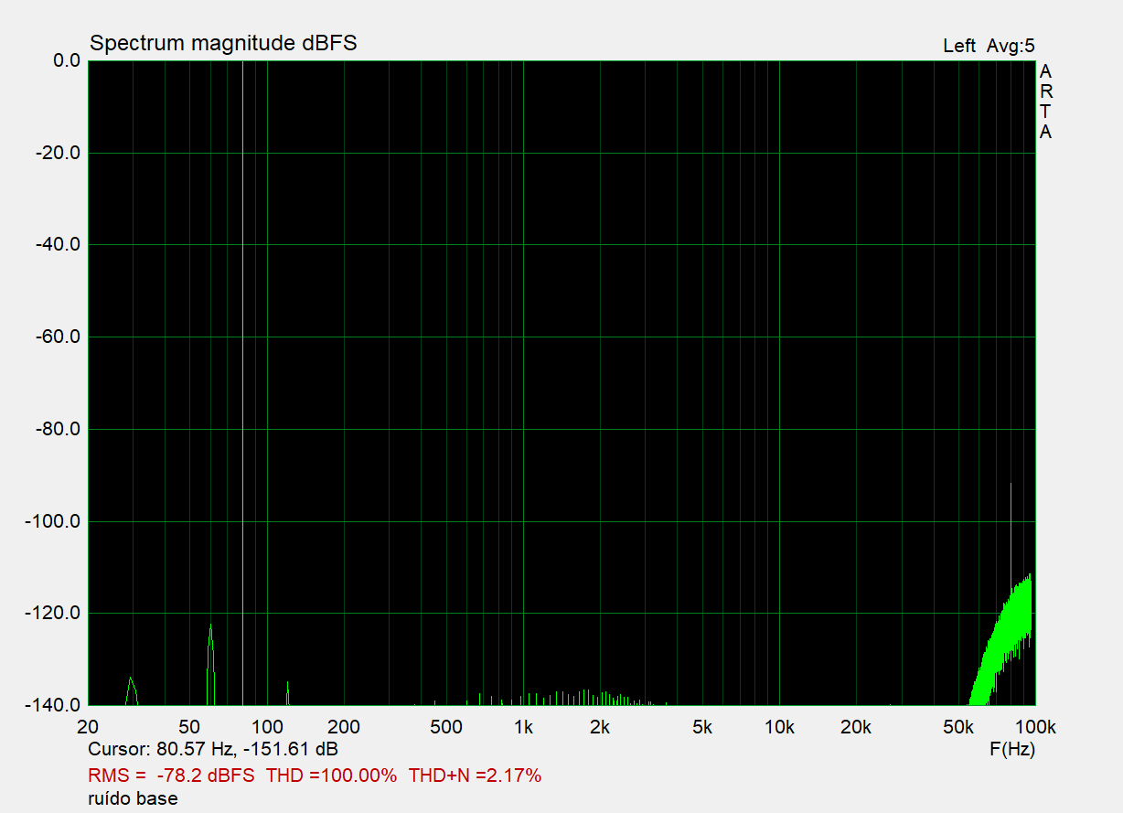

Valve DAC own noise:
Most of this noise is "airborne" due to a lot of bench PSU I'm using for powering it.
All in all, great results for such a simple output using ancient devices!
Very happy with the results.

Thank you for all the measurements! I added a link to them to the opening post.
I knew from my own measurements that the chaotic mode distorts substantially more than the PWM modes, but I could not see the high-order distortion well due to the large resolution bandwidth of my set-up. Interesting...
The only real advantage of the chaotic mode is the reduced out-of-band noise. That is, it has more effective noise shaping, reducing the quantization noise in the first few octaves above the audio band that the output filter cannot suppress much.
I'm happy to have contributed something! 🙂
Interesting about the details about the modes.I knew from my own measurements that the chaotic mode distorts substantially more than the PWM modes, but I could not see the high-order distortion well due to the large resolution bandwidth of my set-up. Interesting...
I can add that even if sounds "the same", I will be happy even so, since is amusing to see this rare appliance with valves working (clock oscillator, demodulator). But is cool to hear it sounding first rate...Good thing I did is to move it to my living room, where my main system sits.

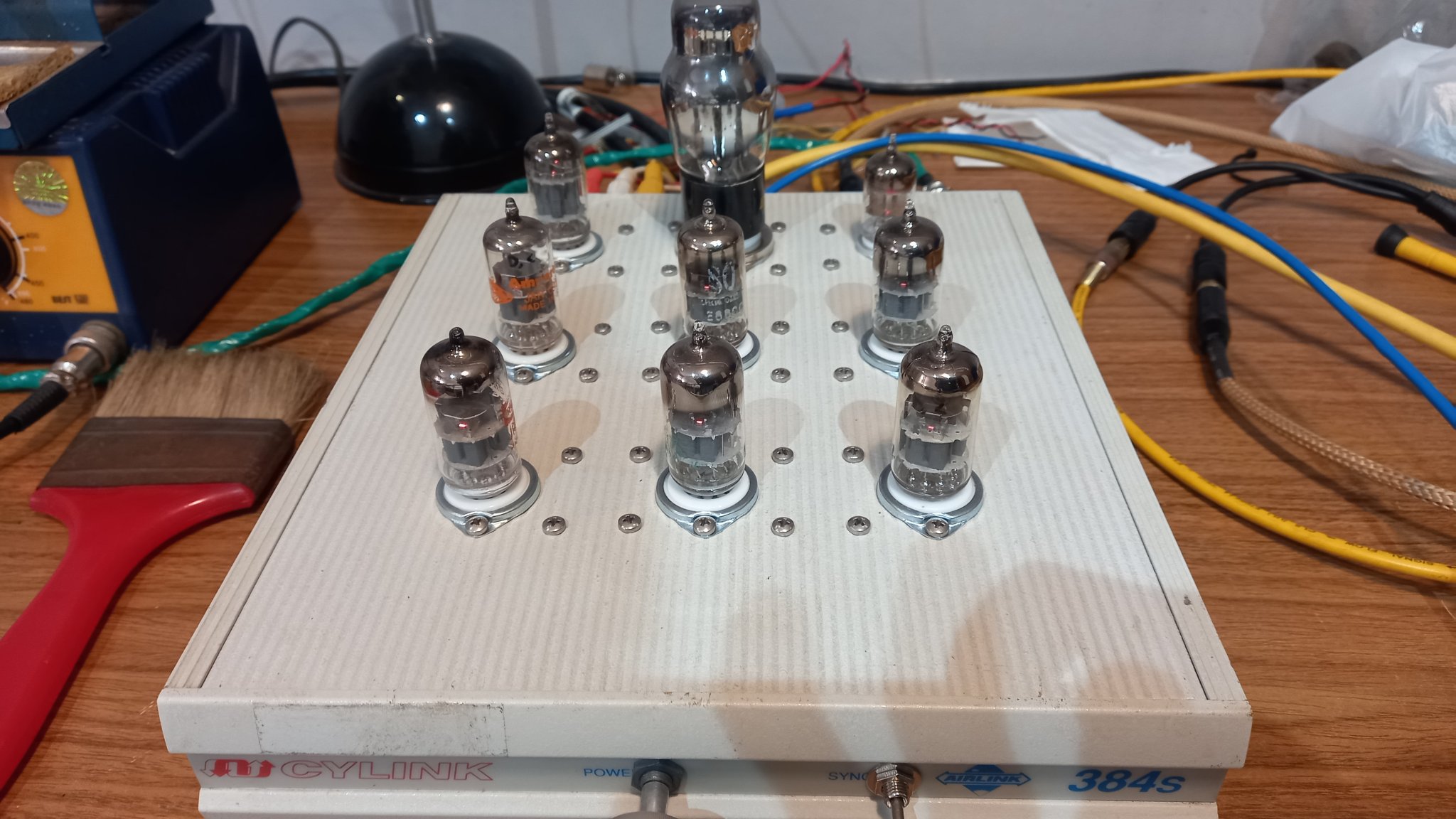

And not all equipment are satisfying to me; for example, I tried some time ago (2 times) upgrade a DAC using the PMD-100 and PCM63, only to feels losing time, since it sounded completely without any life in the music, erasing all details of the music. This one belongs to my spare parts now.
Oops. In ther first sentence in the last post, as usual, I misspelled some word: Where reads: I can add that even if sounds "the same", the correct is: I can add that even if sounded "the same".
Soon will arrive here the transformer for making a valve rectified PSU for it, and I can try to find some cabinet.

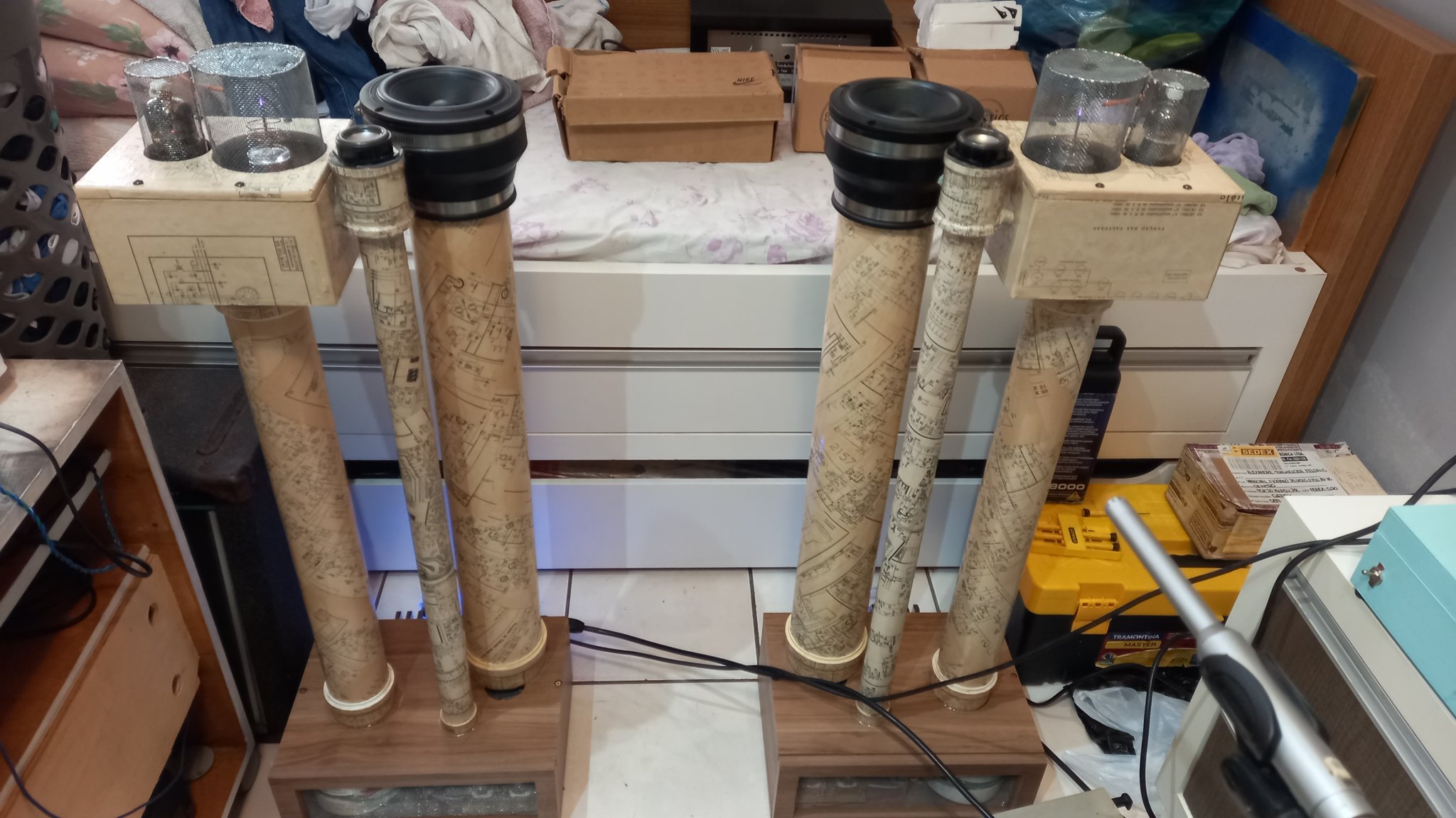

This weekend a visitor listened some 3 of my DAC's: the one from Asus Xonar, the TDA1541 one, and the Valve DAC, using my recently-finished system with plasma tweeter... no magic here, the maximum SPL is indeed limited, but the omnidirectional high treble dispersion is to die for.
Is based on the Linkwitz Pluto system, but with ASP made with tubes/valves... and the amplifiers (well, the bass channel is hybrid).
Photos from testing phase. Exception for the interference response from the plasma cabinet, the response is omnidirectional to deep ultrasonic (good for dogs, mice, cat, bats, etc...).
Results? the TDA1541 blows out the Xonar from mere 5 seconds of track listening, with evident more open and even cleaner sound, and the Valve DAC was the preferred in the end. The TDA1541 is step forward from the Xonar, the Valve DAC are another step, to something great. Then, we listened until the end of listening with the Valve DAC, since the visitor says "NOOO" when I said that I will return to other DAC, hehe 🙂
The Xonar I use for testing, and was included for the sake of perhaps... some "reality check" 😎
This time I don't tried the PCM1704, since it are in another room, and I listened to it comparing between the two, like described in the earlier posting.
With such great result, I'm more curious yet to hear it in my 'phones system. Happy that the power trafo arrived yesterday, and some cabinet are in order.

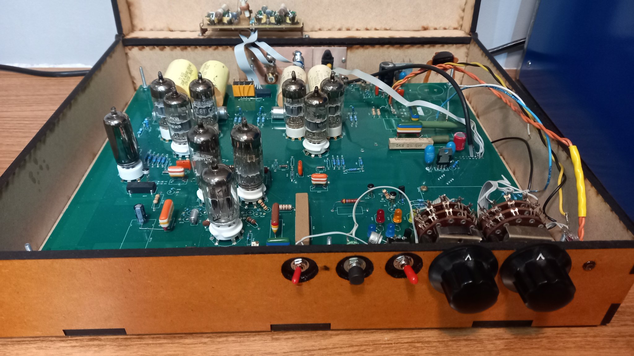

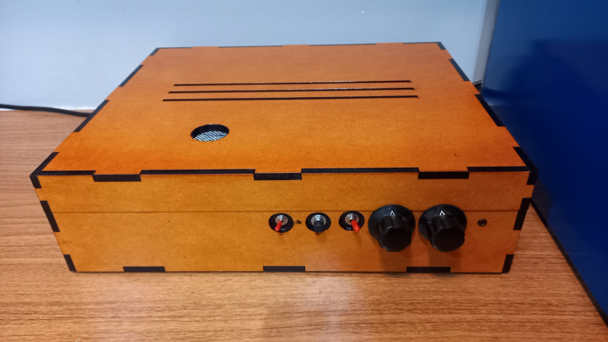

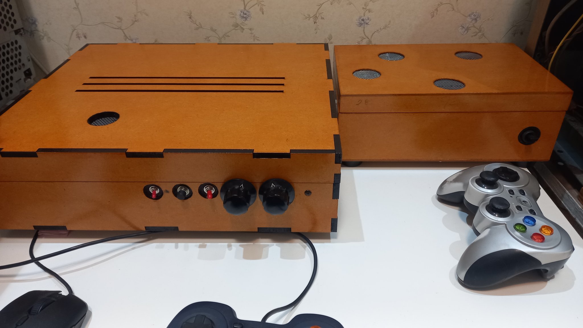

Progress in the main cabinet!
Too bad I make myself manually the holes for the keys, and these become misaligned. Since I forget to draw it when I ordered the cabinet.
I need to retighen the switches for finishing.
Tested and working!
Next week I can start the PSU section.
Tested and working!
I guess I haven't followed enough to understand what you actually built. What's the small PCB connected by ribbon cable? Where's the filter PCB?
The small PCB is a last minute change of filter size I made when I making my BOM list for MOUSER; I decided to try one of smaller cores disponibles (the second in size). For that, I created a new board, since the cores are so smaler than the originals (then I ended not using the original board). But I made a gross mistake: I ordered 10 cores instead of 12. So, for now, for one channel, I used different inductors for last section, but with very close value. Next time when I order something from MOUSER I include the missing cores.
Due to space constraints, I put the board in the cover with these cables, since are flexible for it.
Is a PITA to wind it, especially using very fine wire that I used (something perhaps less than #40AWG). But resulted good; noise is at least equal, near or slight better to original specs (my scope are not so good; is a estimative).
I use only 2 inputs, so a simple switch for it suffices. And for the 3 levels of modulation, I use a commom 2 pole switch with center stop (3 positions) with a "glue logic" to translate 2 contacts to 3 outputs. So I need to use only 2 4-pole switches.
The inputs are a optical S-PDIF and a coaxial S-PDIF.
The outputs are a RCA from one phase, for using it with unbalanced equipment (no trafo for this moment), and mini-XLR for using it with my Stax DIY amplifier (fully balanced).
The function lights remained internal (LED's); only the Ne light for the clipping indicator are on front. Since is easy to open the cabinet.
I also need to organize the PSU cables and put a connector for the umbilical cable, when I work in the PSU.
This are a cabinet from a craftsmanship shop, and not had any finishing, so my wife applied some finishing varnish on it.

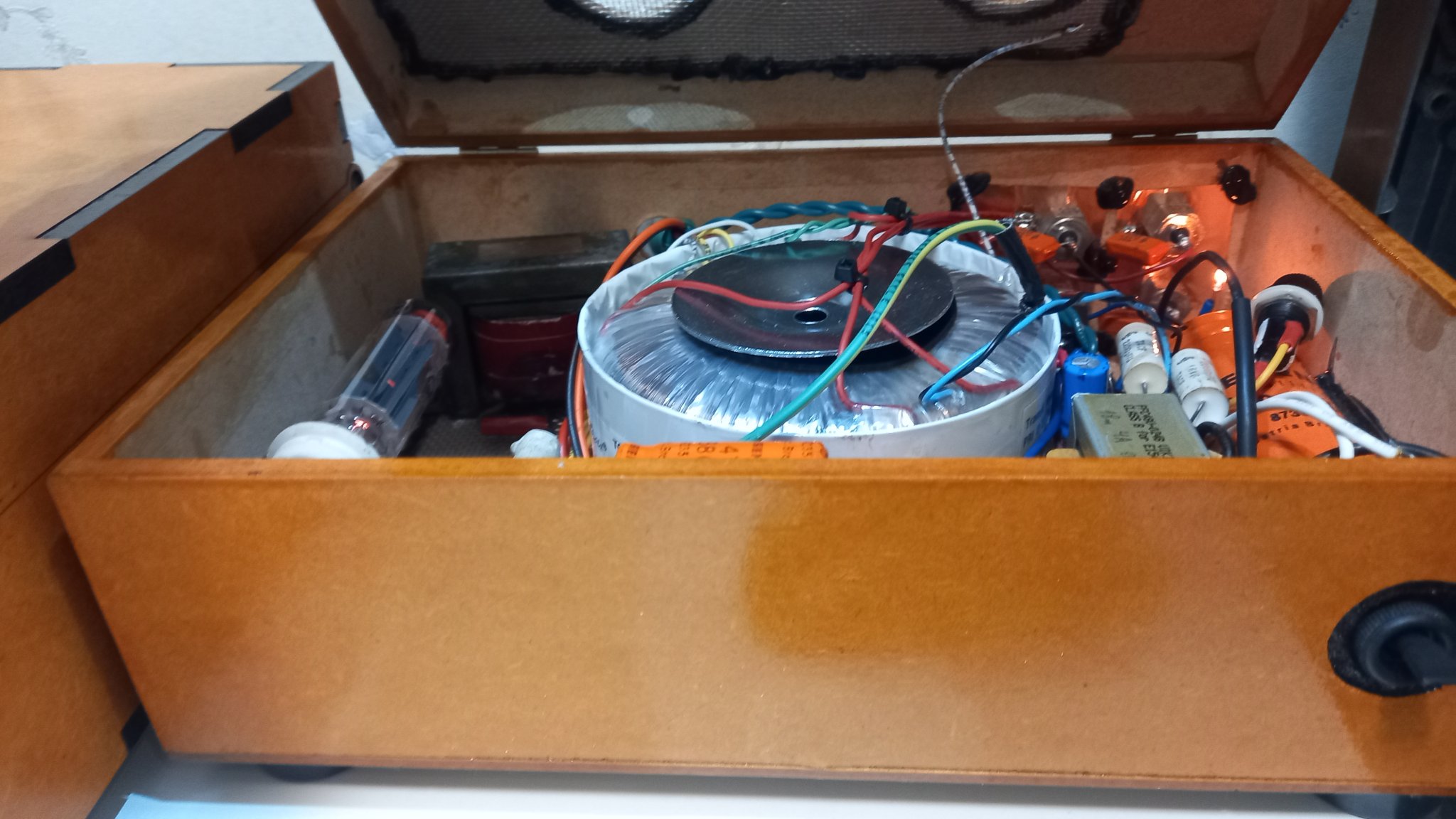

My PSU are completed! And I have the DAC installed!
Not for conquering any beauty contests, and need to tidy some wires yet, but is working and I'm eager to liten with my Stax phones...
Measurements show that the PSU suffices and not contaminates the noise floor with mains garbage.
The PSU is valve rectified, and heaters are rectified by 8A germanium diodes.
I had a hour for listening to it. Including with games (I also uses the phones and this PC for gaming).
But I had a scary fisrt moment: the sounds are weird and strange... I suspected that one of phones being phase reversed. Especially when I test some game; sounds are diffuse. Then I opened my Stax DIY amplifier and corrected the inverted channel.
Sounded like a boost in the sound!
I prefer it than the ES DAC it replaced. This sounds really special. Even with games is interesting to listen to it, sounding natural and well resolving at same time.
But, a thing to mention:
With phones I noticed something:
When I pause a music, it seems to "memorize" the noise about the last level; I believe due to the PC players leaving DC at pause (not zeroing the data). So I 'reset" the DAC using something in the Windows (eg. opening some folder). When this sound stops, the DAC is silent. Ie., The Windows operate correctly, but the players, not.
For other DAC's this are equal to some POP sound. The Valve DAC DAC not make the POP sound, but leaves some noise.
Other equipment can have this behviour, like CD players.
So, is important to remember this phenomenon when trying to zeroing the noise floor: make sure the DAC is at real zero output.
