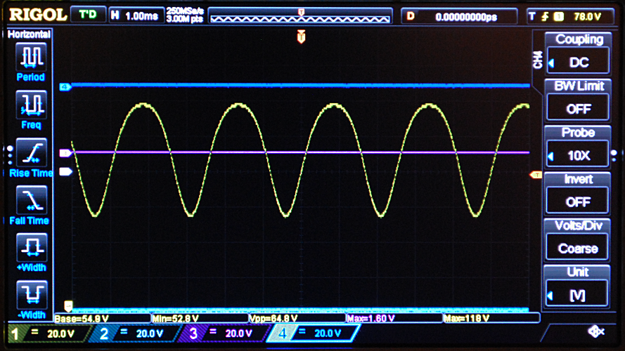

The attached image shows the amount of distortion I needed to get a good clean guitar tone from a low-powered valve guitar amp. 😱But I bet a lot of Guitar people would like that 2nd harmonic distortion.
This is somewhere between 10% and 20% THD, I estimate. And with a guitar plugged in, it doesn't sound distorted, it sounds clean.
This is an oscilloscope capture I took after many, many hours of calculations and test-bench tweaking finally got me a great clean tone out of my little two-watt 6AK6 push-pull guitar amp.
The thing is, any halfway-decent solid-state amp beats the pants off any tube Hi-Fi amp when it comes to low distortion, which is why I myself have no interest in valve Hi-Fi. (But I recognize other people's right to do silly things for no good reason. 😀 )A Hi Fi purist might like the idea of using a real good current sink (not a resistor), and then want perfectly matched plate load resistors.

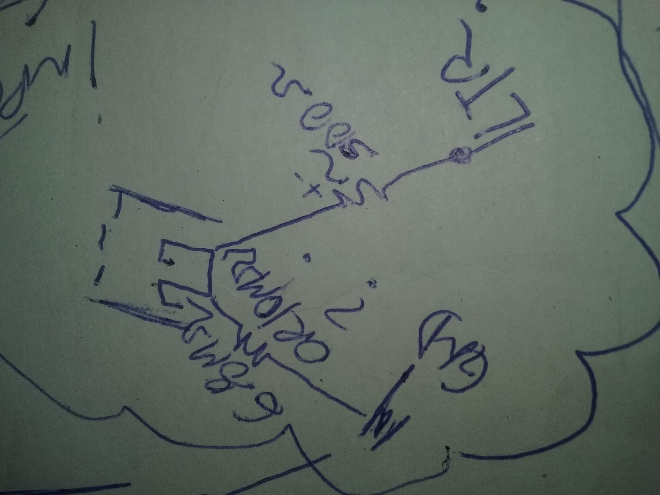

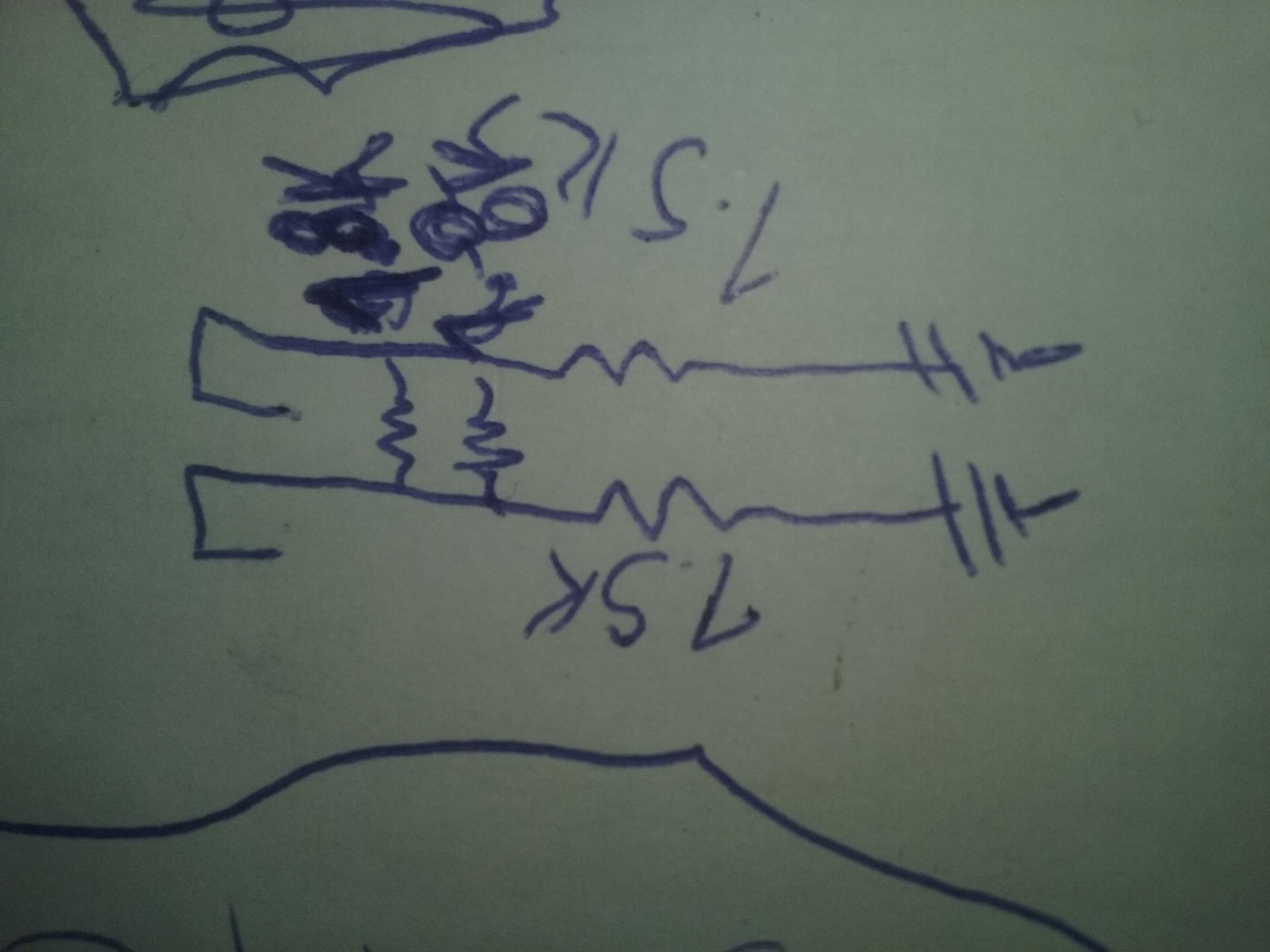

Start with a phase splitter that has a resistor used as a pseudo current sink in the two cathodes circuit. That causes an imperfection of the balance of the two phase's amplitudes. That is due to the imperfect current sink (a resistor, not anywhere near to a near infinite impedance).
i'av attached sketches of what my mind could understand by what you've posted;
since i dont know which value of a resistor is considered a 'resistor-level' for you, lets praise a la Motörhead's Ace Of Spades and start the gambles to try to squeeze information from you:
this time my biggest and farthest bet goes to my pair of 6.8M and 10M... if they are too far from the bullseye, then lets fuse them into some parallel reduction to about 4M, but wait! it gets complicated now... i've got some stuff of about 220k, 68k, 82k, 120k, 33k, 22k, 10k, 1.2k and some big wirewound 5 watters, the green stuff, ranging from 125-270 and 470r
thanks
EDIT: i dont know what a current sink is, goodzilla says things with transistors and diodes, i saddened when had toughts of including silicon (i love crystals... quartz ones) but not in my signal chain... they are cool for optixs, no pun
i'll have the accept the energy of silicon in my power supply until i feel in the mood to rip off the diodes of this amp and install ez81 and kill/omit some cans not needed to keep the diode-tube steady&smooth
-Gnobuddy

okay, but is the drawing of the so called current sink boostrap into the pi cathodes correct?
what value is the so called resistor-level of resistance?
i kinda dont care if its seen as distortion or not aslong as the sound matches with what i want: beautiful roundwaves with no clipping <3
but it doesnt matter to discuss it aslong as i can put this beast to test after finishing
only this questions left thxuall
Trust me, you do NOT want current sinks in your guitar amp phase splitter.okay, but is the drawing of the so called current sink boostrap into the pi cathodes correct?
The long tailed pair phase splitter has exactly the type of distortion you want - smooth and rounded - and it contributes a lot to the sound of the guitar amp. In my opinion, don't change anything in the PI - build it just like the schematic you posted in your post #1 on this thread.
Something was misunderstood between you and 6A3sUMMER - there is no such thing as resistor-level of resistance.what value is the so called resistor-level of resistance?
Again, my opinion: don't change anything in the PI! Build it just like your schematic in your first post on this thread.only this questions left thx u all
-Gnobuddy
Something was misunderstood between you and 6A3sUMMER - there is no such thing as resistor-level of resistance.![]()
-Gnobuddy
okie-dooky i'll stick to your advice!!
on the parallel v1 tho i'll do the bootstrap thingy because our friend 6a3 had a great idea to tame the problems i mentioned
but ltpi will be left untouched
thanks you all for helping, i hope somehow the time you all invested to help me turns into good things for you because i believe only my gratitude and appreciation for yerall help isnt enough to pay for the valuable knowledge yall shared
but all i have to give now is my thanks!
cheers from BRASIL ;D
