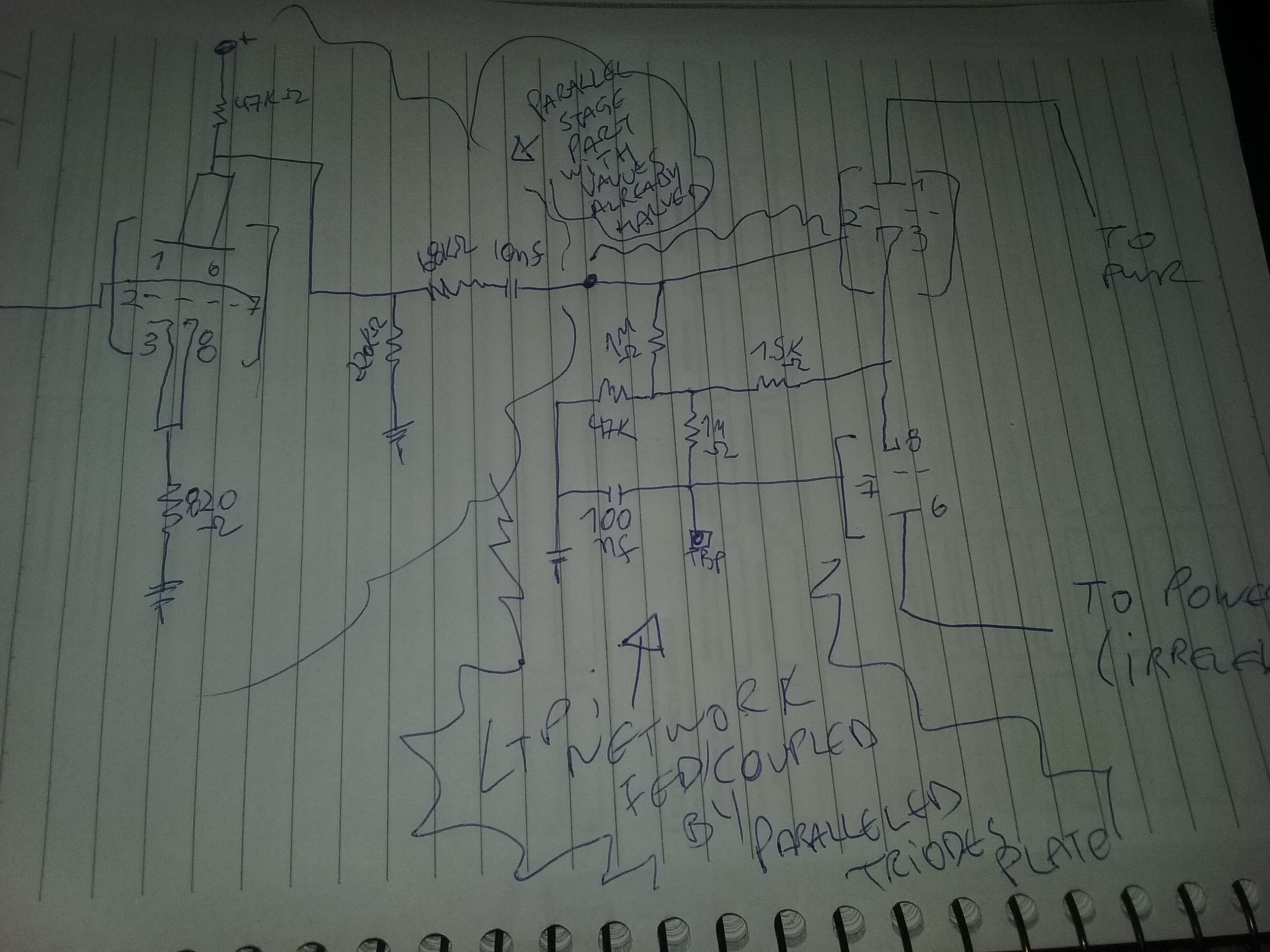

given the schematic added, regarding the V1 conversion of a parallel triode gain stage into the c8 (coupling cap/ LTPI input)
due to parallel triodes behaviour, the following resistors/capacitors in the LTPI network must be changed to be seen/operate at same values as default by design:
c8: 22nf (10nf) [or 2 22nf in series]
r12: 1m (470k) [or 2 1m parallel)
r11: 47k (22k) [2x 47k parallel]
r13: 1.5k (820r) [2x 1.5k parallel]
r14: 1m (470k) [2x 1m parallel]
c9: 100nf (50nf)
is it right?

Can't read your schematic, not enough detail.
Need more resolution.

What parallel triodes?
An LTP (Long Tailed Pair) is not parallel triodes, the triodes are in anti-phase mode.
With a resistor used as a "current sink" for the paralleled cathodes, the plate loads have to be different resistances, or the in-phase and out-of-phase signals will not be equal amplitude.
You would have to use a true current sink, not a resistor, in order to get the amplitudes equal when the plate loads are equal.

i'll draw on paper the schem later then, but basically the thing is:
the signal feeding the ltpi comes from a plate-driven gain stage, this stage is a paralleled 12ax7
since i know the paralleled plates resistor and coupling cap behave in a different way (the plate resistor must be halved and the coupling cap too)
i aint sure if the same happens when the signal from the parallel plates reach the ltpi network since they are coupled and i havent halved their values yet
edit: new scheme added

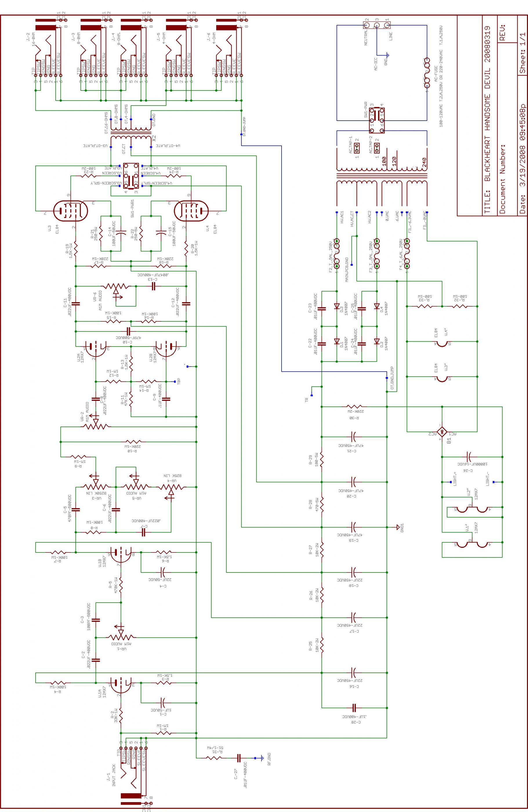

it seems to get lost on skips due to the fact that my main question was skipped aswell so i should apologize for skipping the skippy-skip, but oh well... its a tube amplifier
if you examine carefully the design of the original scheme (on zoom you can see it, i've tried on two phones to be sure) it was designed for guitar
if you care to examine the second schematic, it will tell you its gonna amplify anything in a flat response with minimal distortion, so it can be used for guitar and anything else above around 75hz more or less

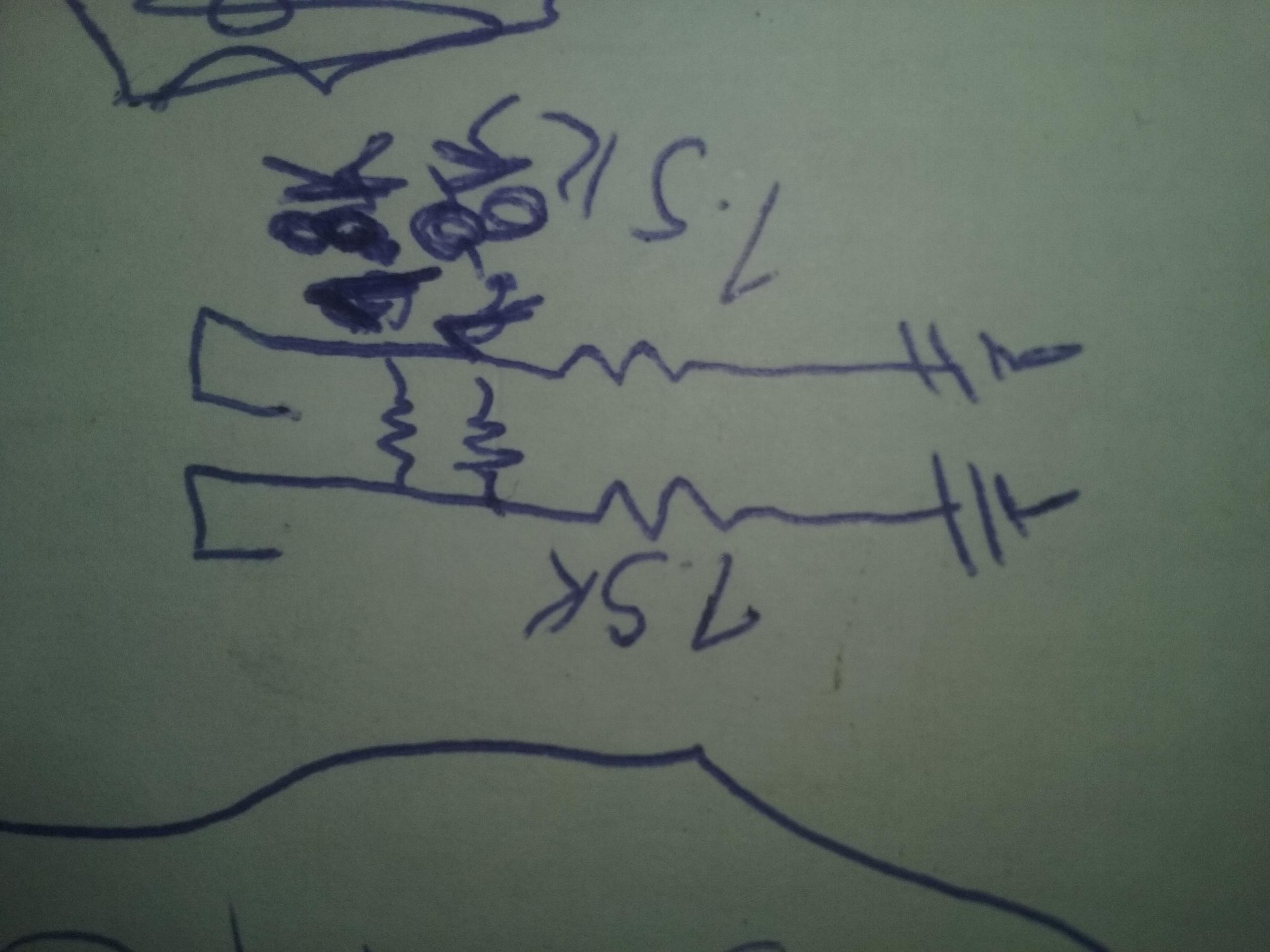

friendie, the long tail resistor and the LTPI network (excluding the plate and beyond that goes for power stage) will be affected by the v1 parallel plate driven stage behaviour? do i need to halve the resistors and capacitor of the ltpi stage thats coupled with the V1 plates??
for example: the 47k plate resistor of v1 is seen as 94k, the 10nf coupling cap is seen as 20nf, the voltage divider before the coupling cap is seen as 440k/136k, because the plates of the v1 are parallelled... but the LTPI resistor tail and adjacent/coupled network?? they are seen by the operation points halved/doubled??

I don't think you need to change anything in the LTP....due to parallel triodes behaviour, the following resistors/capacitors in the LTPI network must be changed to be seen/operate at same values as default by design...
Paralleling the two triodes in one 12AX7 in the earlier stage lowers the output impedance of that stage, roughly halving it. In your circuit, I would expect the output impedance of the paralleled stage to be, very roughly, about 20k instead of about 40k for a single, un-paralleled triode with a 100k anode resistor. (The resistor is lowered to 47k for parallel triodes, which is correct, as you have twice as much anode current to deal with.)
However, this doesn't change very much for the phase-splitter stage. The input impedance of that stage is relatively high, and the paralleled previous stage will easily drive it, even more easily than if you had not paralleled two triodes.
In general, low output impedance feeding high input impedance is a good thing in audio engineering, and is standard practice in solid-state audio electronics. Valves (especially the ones we use most often in guitar preamps) have high output impedances, one of their weaknesses. By paralleling two of them, you've actually made your circuit a little bit better, from the engineering point of view. 🙂
-Gnobuddy

Ok, some discussion, including from Gnobuddy, has really helped me sort out the issues.
(at least I hope to find and explain some of them).
Post 3 Schematic:
First, I do not know if that 220k resistor from the input stage plate(s) was there with the original single triode. If it was already there, it should be changed to 110k to keep the voltage of the parallel plates the same as it was for 1 triode.
You already divided the cathode resistor and plate load by 2, versus with only 1 triode . . . good.
Now, with the cathode resistor, plate resistor, and 220k resistor changed to 1/2 values, then the current in each individual triode is the same as the original single triode. And, the voltages are still the same. That means the linearity and/or non-linearity of that stage is exactly the same (very nearly the same, because the total load beyond the 47k and changed 110k is close to being the same, 68k, 10nF, and 1Meg (well, it is also the very low grid impedance when it draws grid current when the guitar is wailed-on).
But as gnobuddy said, the output impedance of that first stage is about 1/2 of what it was with a single triode.
And before I forget, the Miller Effect capacitance of the paralleled grids is 2X that it was for a single triode (depending on the impedance that drives that grid, now grids, is important, if it is too high, the high frequencies will be rolled off in that stage.
However, what is different is that you have the 68k and series 1 nF cap are driving a high impedance 1 Meg Ohm that is in parallel with the non-linear resistance of the next stage’s
grid impedance. It is high impedance when it is less than 0V with respect to its cathode.
But it is low impedance when the grid goes positive with respect to its cathode.
And the Miller effect capacitance is always there (which may cause high frequency roll off).
But you are driving it from the modified stage that is now 1/2 its original impedance.
If you want the same action when the next stage draws grid current (and clips), you need to change the 68k to perhaps 2 x 68k.

Post 3 Schematic:
We really need to know the exact impedance of the paralleled plates to know the total driving impedance to the following grid (47k in parallel with the parallel plate impedance) that is in series with the 68k.
But now, my brain is starting to fade.
We have to retain the 10nF that drives 1Meg, to keep the low frequency response. It really depends on the parallel plate(s) rp, 47k, and 110k impedances that are all in parallel, and that is in series with 68k and 10nF; all that drives 1Meg.
Keep the same low frequency roll off when all that network is driving 1Meg in parallel with the extremely high resistance of the next stage’s grid, and the Miller Effect capacitance.
OK, fine.
But . . . now we have to figure how to keep the grid current the same when the first stage has large signal and drives the next stage into grid current. That grid impedance is now much much lower. I think we just change 68k to 136k, and keep the 10nF cap the same.
I hope I got it right.
If not, at least I gave food for thought.
Oh, and to keep roughly the same linearity / non-linearity in the paralleled triodes as in the single triode, do this to keep the currents of each triode about the same:
Use individual 1640 Ohm resistors for each cathode, not two cathodes strapped to a common 820 Ohm resistor.
Also that makes it easy to measure the two cathode voltages and see if you have a 'bad' triode that is either hogging all the current, or is weak (loafing).
I did make an assumption, I thought you wanted the same sound with paralleled triodes versus a single triode.
i dont have the parts value for what you've requested for this deed
can it be rk 1.5k
and the bootstrappin' 900?
such as the drawing-thing on attachment?
so the currents balanced are better?
