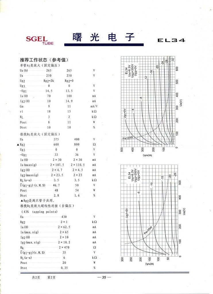

I haven't been successful in finding data sheets from Shuguang except for the attached (which I found through an Ebay add). Can you point me (us) to any other's?

Analog Metric sells Shuguang tubes and has a PDF on its download page containing datasheets for a number of their tubes. Here is a link to the download page (go to the very bottom for the Shuguang datasheet document):
Analog Metric - DIY Audio Kit Developer
and here is a direct link to the Shuguang tube datasheet PDF:
http://analogmetric.com/download/Shuguang Beijing Vacuum Tube Datasheet Analog Metric Limited.pdf
I hope this helps.

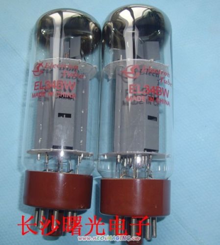

My guess is that Carvin used those EL34As in my son’s guitar amplifier. Except for the “PM EL34/6CA7” inked and "46 mA 11/51" ratings paper tag markings, they look identical to the attached photo.

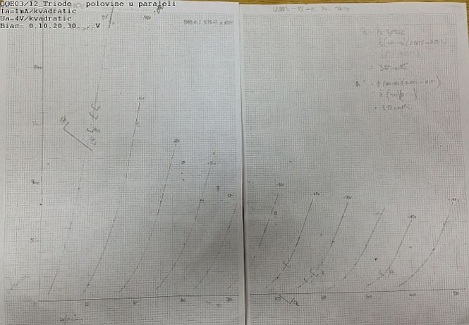

I have triode characteristics with halves in parallel, but the visibility is really very bad, sorry. If can help ...
Thanks, I built the model with a similar parallelled triode curves and simply divided the current by 2 to arrive at the value of a single triode. Like all models, it probably still requires some adjustments to make it work properly in a circuit.Jaz,
