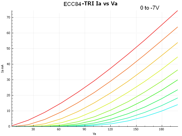

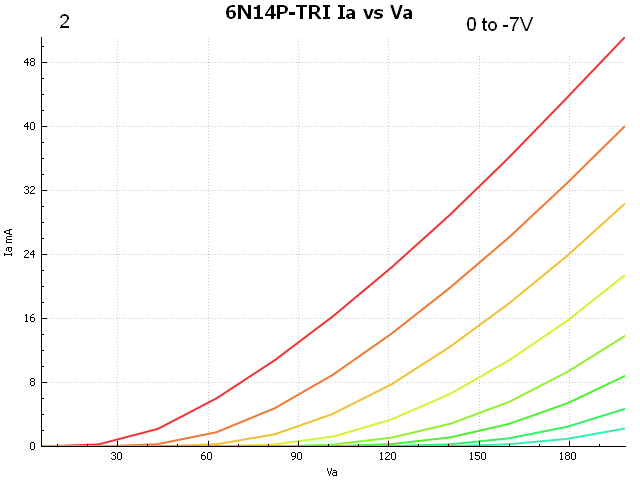

6N14P/ECC84
Some preliminary curves and tube models for the 6N14P and ECC84. The models and curves were generated in uTgui and represent the performance of a single section each of an unselected bogey device. I will post additional models when I have sense of what a representative device looks like parametrically.
Note that you need the generic Koren triode model in your library to use these. (Get from the uTgui site)

Something to note that these models were built from measurements on unselected samples and probably represent relatively large divergences in performance from the "typical" tube of this type. Use at your own risk. 😀

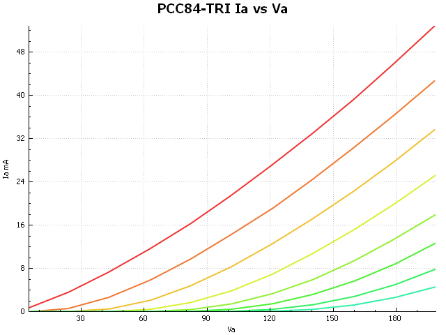

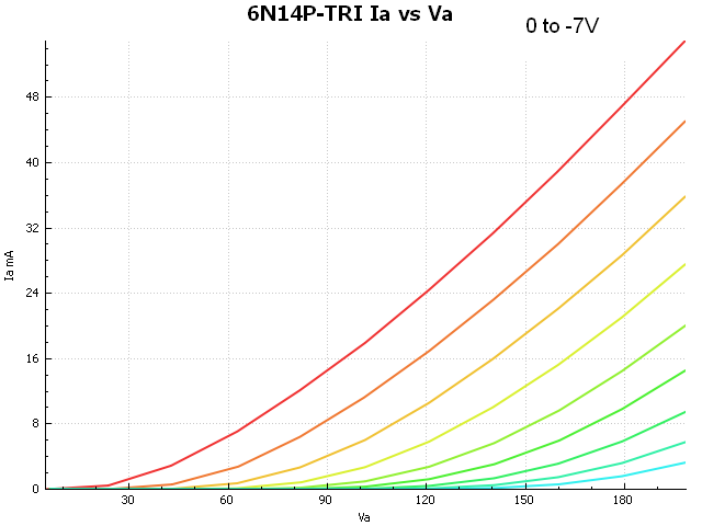

Here is a second 6N14P and a PCC84. I changed the plot from nine grid voltage plots to 8, 0 to -7V in 1V intervals.
The PCC84 actually measured closest of any of the devices I have measured so far to the measured operating conditions of the 6N14P in my latest phono stage design. (I selected them out of a dozen I have on hand)
Something to note that these models were built from measurements on unselected samples and could represent relatively large divergences in performance from the "typical" tube of this type. Use at your own risk.

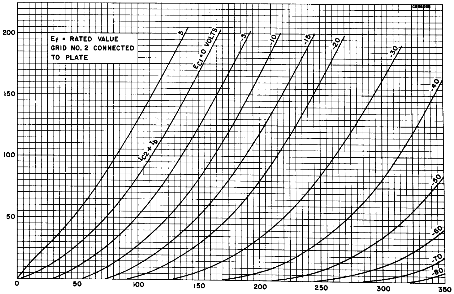

I'm searching for a reliable model of the 5902 penthode. I already found a model but looking ant the curves that comes out from the simulation they are wrong. This is what I have:
If you have the triode connected Ea-Ia curves for 5902 or EL71, I could build the pentode model for you.
