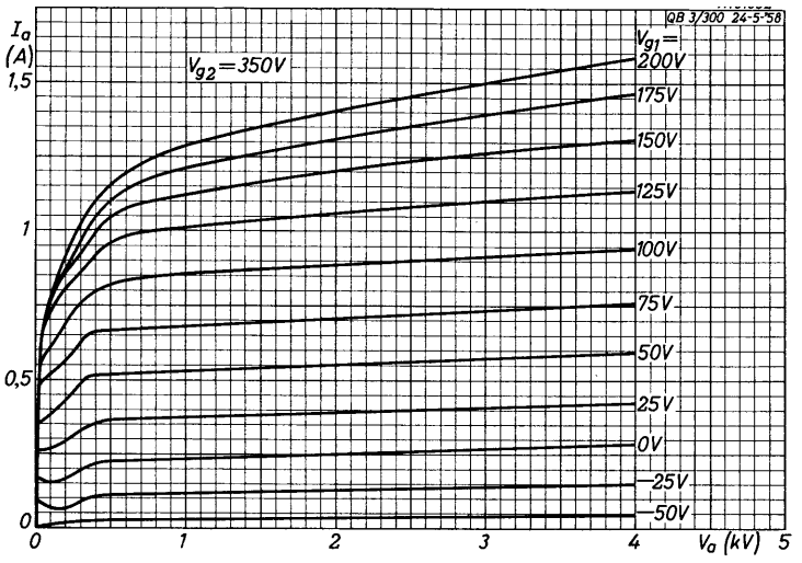

...well, there is a problem. The 4-125A diagrams are quite unusual, I'm not familiar with. So I would start from scratch to find out how my 17 parameters influences this fancy constant current traces...

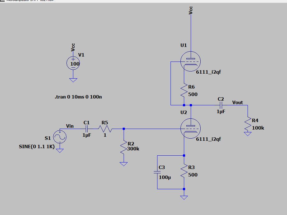

I would start a new thread for circuit discussion, as this thread turns about tube spice models.
How ever, if your circuit is intended to generate an inverted copy of a signal to drive pushpull stages, there are much better/simpler circuits with higher input impedance and less parts needed, like the cathodyn stage, or the long tail PI stage if some gain is needed.
all the best, Adrian

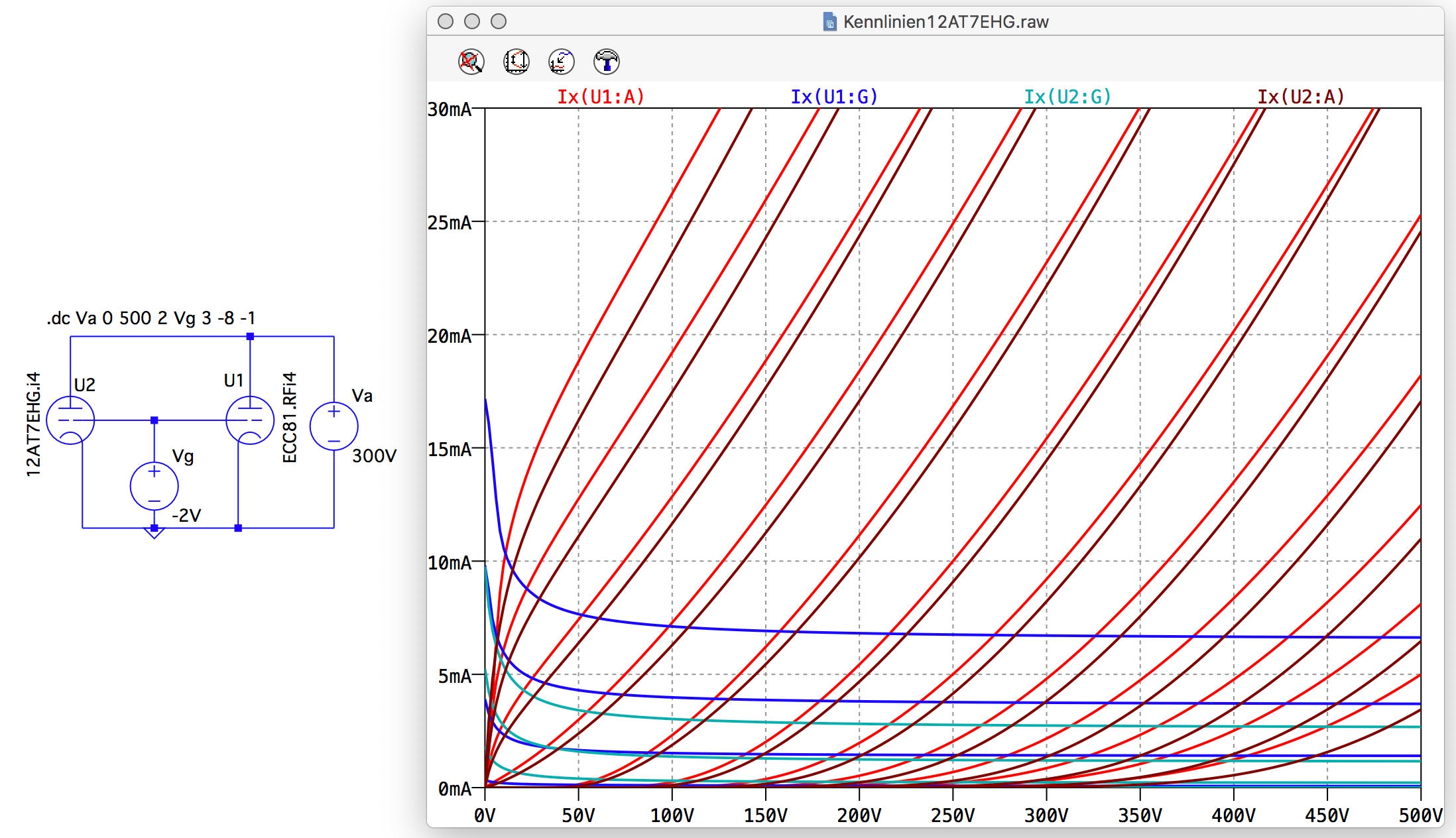

Hi all,
something I have learned the last days is that a tube name is more or less just a convention for a certain mu and gm - and that's all!
(well, ok, also for a certain tube-case/pinout and heater voltage/current, but this is not of interest for spice simulations)
With other words, there are many differences between the same tubes from different manufacturers:
- grid current (especially control grid)
- cut-off behavior (island effect)
- contact voltage (a question of the electrode materials)
- sometimes also the rated plate power
So, that's why I prefer nowadays to generate manufacture-specific tube models! 😀

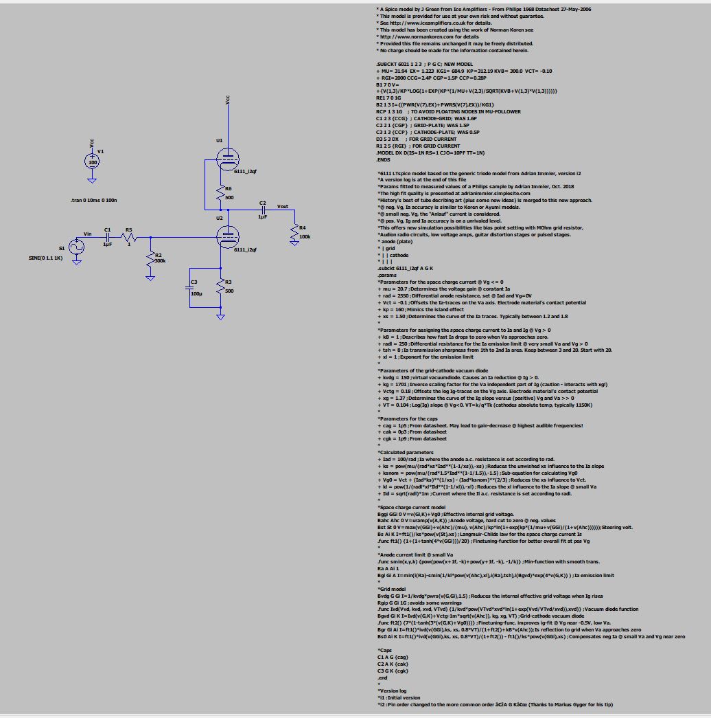

I recently got very good measured data from a 12AT7EHG and a RFT ECC81 (each selected out of 16 triodes for closest match to data sheet) and a you can see in the graph, they are quite different in almost all mentioned properties. Especially between both grid current is more than a factor 2 !!
here the electro-harmonics 12AT7EHG spice model:
...and the spice model for the RFT ECC81:

Bgr Gi Ai I=ivd(v(GGi),ks/os, xs, 0.8*fVT())/(1+ft2()+kB*v(Ahc));Is reflection to grid when Va approaches zero
Bs0 Ai K I=ivd(v(GGi),ks/os, xs, 0.8*fVT())/(1+ft2()) - os/ks*pow(v(GGi),xs) ;Compensates neg Ia @ small Va and Vg near zero
*Caps
C1 A G {cag}
C2 A K {cak}
C3 G K {cgk}
.end
*Version log
*i1 :Initial version
*i2 :Pin order changed to the more common order „A G K“ (Thanks to Markus Gyger for his tip)
*i3 :bugfix of the Ivd-function: now also usable for larger Vvd
*i4: Rgi replaced by a virtual vacuum diode (better convergence). ft1 deleted (no longer needed)
;2 new prarams for Ig finetuning @ Va and Vg near zero. New emission skaling factor ke for aging etc.

Is it perhaps more a case of genuine NOS versus some modern made version that supposedly is the same?
Hi AmadeusMozart
That's what I first also thought, you know the story around short and long plate triodes. But I'm no longer convinced that this is the only difference.
Because if so, all the NOS ECC81/12AT7 would behave identical, but I have found remarkable differences in terms of grid current and also cut-off behavior. See the attached example, comparing the GE 12AT7 with an RFT ECC81.
One may say this is just manufacturing tolerance, but it is not because the RFT is a "golden sample", which means closest to data sheet out of 16 samples.
Another example is the Tesla and Philips PCC88. Their data sheets are quite different regarding cut-off behavior, as an attached graph shows.
But yes, I guess as long as a manufacturer just buyed a construction receipt from another manufacturer (or reverse-engineered it), their tube will behave identical. So actually, a construction-receipt specific spice model would be sufficient. But which self-explaining name should we give for that kind of model? 😕
That's why I hold on to give manufacturer specific spice model names. 😉

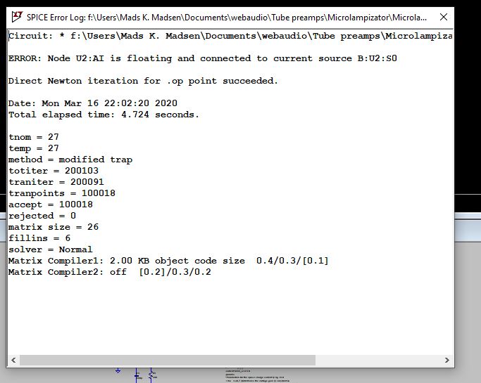

Model for 6111
Found a model for the 6111 tube here:
http://adrianimmler.simplesite.com/440956786
Seems quite elaborated
But get the attached error message when using it in a SRPP circuit.
Any thoughts??
No problems when I use the less sophisticated model for 6021 included in ethe .asc file as well
Any thoughts??
Hi Baldin
Thanks for your feedback!
As I found out, my triode i2 models have a weak point. When a high grid current occurs, the i2 version fails to convergence. Such a high grid current may occur, e.g. when a huge cap is parallel to a cathode resistor, and this cap demands high currents to be charged during the startup phase. 😡
Your attached .asc file was not able to be opened with my LTspice IV, so I send you a private message with a quick fixed 6111 model.
May you test for me, if the error disappear with the quick fixed model?
Thanks!
Thanks!
Thanks Adrian 😉
Did not realize it was your page and model .... new in this part of DIY Audio 😉
See PM, basically the same Error message
Kind regards Baldin
Kind regards Baldin
Hi Baldin
May you send me a screenshot of your opened .asc file?
That would give me a chance to understand whats going on in your simulation.
I wasn't able to open the .asc file in post #2215 so I just recreated it as "6111 Test.asc" from the image in post #2219. It ran without errors using Adrian's 6111_i2 model, downloaded from his website. Note that rather than embed the 6111 model in the .asc file I referenced it in an .inc statement (I store my own subcircuit and library files in a "User" folder). Note also that the model is not the "qf" version shown in post #2219 so that could also make a difference.
I've attached both of my files here. Maybe this will help the troubleshooting effort.
