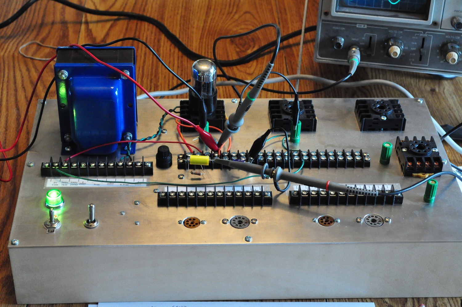

I have a large metal chassis with lots of sockets, transformers on top enclosed with the rest of the ac. Wiring us point to point soldered spread out inside.
Perhaps less flexible than kits here but the same area is used for the day job (IT) so this allows me to setup and pack up quickly.
The chassis protects the transformers, wiring but also defines a safety zone.

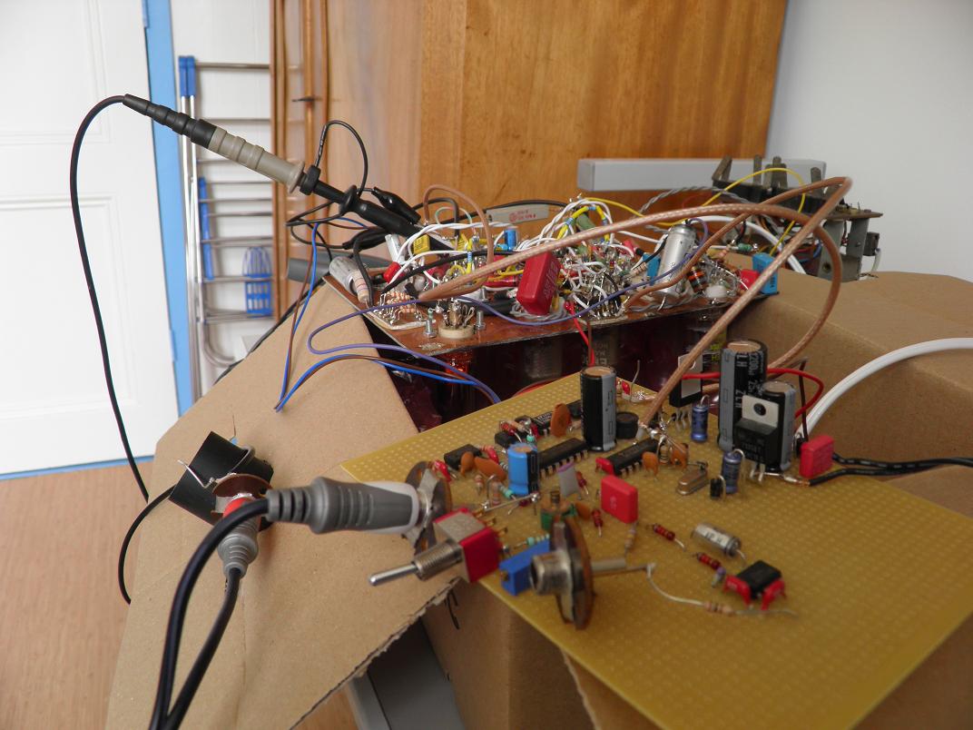

I use a bench that includes several power supplies, 8ohm load resistors, volume pot, input and output connectors etc. The prototype goes in to a generic pcb attached with hinges to the bench so you can work on wiring, measurements etc and put it back when just listening to it.

Nice!I use a bench that includes several power supplies, 8ohm load resistors, volume pot, input and output connectors etc. The prototype goes in to a generic pcb attached with hinges to the bench so you can work on wiring, measurements etc and put it back when just listening to it.

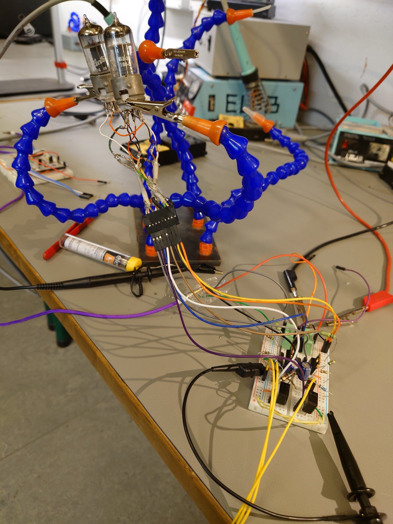

I use a tube socket fitted with rigid wires, compatible with a breadboard, and color coded for convenience and mistake avoidance.
See this for example:
https://www.diyaudio.com/community/...rging-a-e-pcl82-amplifier.351667/post-6134055

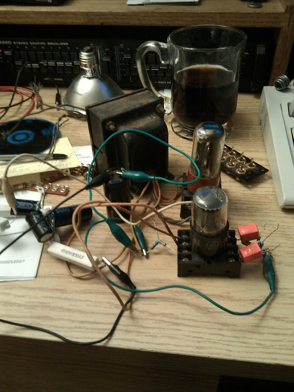

I found a pic from October 2011 I prototyped a tube circuit my first useful tube circuit. It was a simple grounded cathode 6SN7 amp with a 5Y3 powering it.

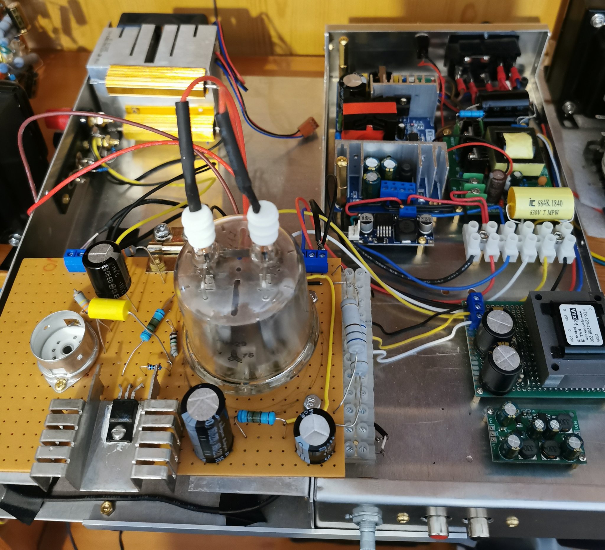

I've used various methods:
Pertinax perfboard with no copper, with some extra holes drilled in it when needed to fit in the pins of PCB valve holders (they are often too thick or not on a 2.54 mm grid). I even used this for a high-voltage amplifier with 2660 V supply once, using two very long perfboards and keeping plenty of space.
Piece of wood with nails.
Single-sided copper clad FR4 with big holes drilled in it, so I can mount valve holders meant for chassis mounting in the holes.
