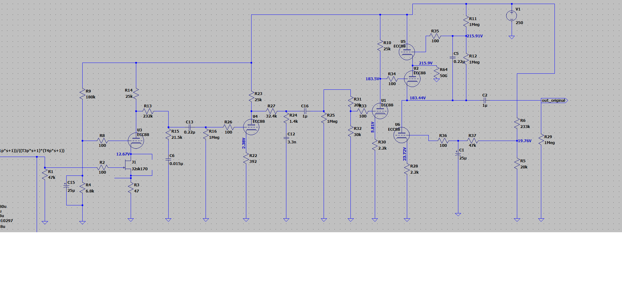

You can experiment with different R values using LTSpice. The theoretical voltage values are very close to yours.@Alex M @Joe Rasmussen I removed R5 resistor and measurements are following.
U1 - Pin 1 - R5 removed - 188 V, changing R3 to 1K resistor lower the voltage to 147 V R5 included -
U1 - R3 - Pin 3 - R5 removed - 5,4V - changing R3 to 1K resistor then it is - 3,9 V R5 included
U1 - Pin 6 - R5 removed - 71,6 V - with a R3 resistor changed to 1K resistor then voltage is 152 V R5 included
U1 - Pin 7 - R5 removed - 19,6 V - with a R3 resistor changed to 1K resistor then voltage is 20 V R5 included
U1 - R6 - Pin 8 - R5 removed - 20 V - with a R3 resistor changed to 1K resistor then voltage is 22 V R5 included
U2 - Pin 2 - R5 removed - 148 V with a R3 resistor changed to 1K resistor then voltage is 190 V R5 included
U2 - Pin 3 - R5 removed - 162 V with a R3 resistor changed to 1K resistor then voltage is 197 V R5 included
U2 - Pin 6 - R5 removed - 162 V with a R3 resistor changed to 1K resistor then voltage is 197 V R5 included
U2 - Pin 7 - R5 removed - 0,02 V with a R3 resistor changed to 1K resistor then voltage is 142 V R5 included
U2 - Pin 8 - R5 removed - 72V - with a R3 resistor changed to 1K resistor then voltage is 152 V R5 included
To get U1A pin 1 anode to 100 V then R3 have to be I think about 380 ohms. How to lower the gain then? How that affects sound quality if anode has much higher voltage than 100V?
Ideas how to get this to sound superb?
LTSpice file with phono stage attached. The drawing of the schematic is not very nice but for simple experiments it works 😉 Upper part is an original and with bottom part you can experiment and compare results. If you will change first cathode resistor to 430, then voltage at anode will be about 102V and current 5.9mA. But amplification will increase about 8dB.

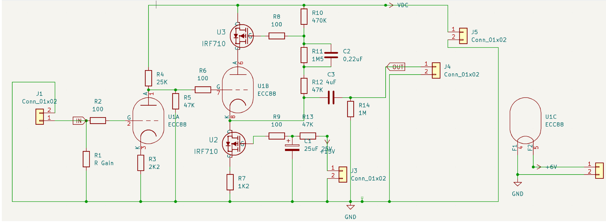

I played again with FVP5 with the one tube version. I had to change MOSFETS to get it to work. I think the tube uses less current than it should be. With already little bit higher volumes from computer headphone output I get easily distortion. If I lower R3 cathode resistor then pin 1 anode voltage lowers but also pin 3 voltage. If I go lower than 100 V on anode pin 1 I get distortion very easily.
Voltages are
1 - 109 V
2 - 0 V
3 - 2,78 V - to low voltage?
6 - 176 V
7 - 109 V
8 - 110,5 V
U2 - R7 - 11.4 V
U1A - 3,64mA = (201-110)/25k
Joe mentioned that current gets split up, 1.7mA through 47K and rest through gain tube 3,68mA-1,7mA= 1,9mA?
Voltage on R3 = 1,9mA x 2k2 R = 2200*0.0019mA = 4,18 V but I have much less than that.
On this current voltage on R3 does not make sense.
Any ideas? Are the tubes so old and used?

I agree that your voltages don't make sense. If V1=109V, the current through the 25K is 5.6mA, which sounds good. But this current through the 2K2 cathode resistor would give V3=12.4V, instead of the 2.78V you report.
I'm suspicious of the voltages V7 and V8 - the cathode should be 4-4.5V positive of the grid.
What voltage do you measure across R7? Measuring the voltages at points 6 and 8 doesn't tell you what the currents through the output stage are.
Alex
Voltage across R7 is 11.40 V and voltage across R3 is still 2,7 V. Voltage on pin 8 is also 110 V.What voltage do you measure across R7? Measuring the voltages at points 6 and 8 doesn't tell you what the currents through the output stage are.

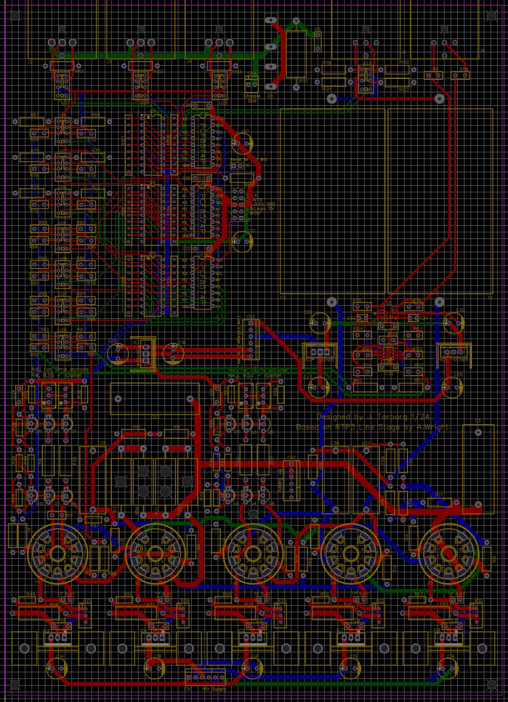

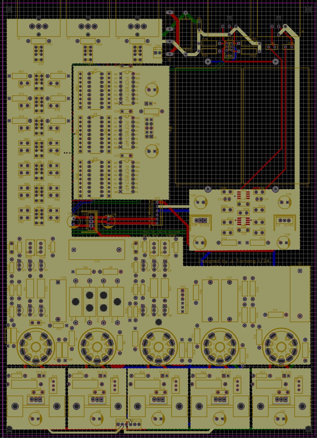

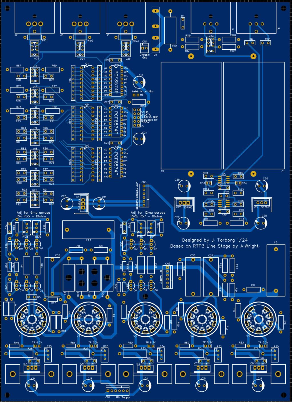

I decided to do a new layout for the line stage and combine the input selection and stepped attenuator on the same PCB. I haven't had this fabricated yet, but I think it is pretty close. This is a 4-layer board with one layer dedicated to ground planes. 263mm x 190mm.
This PCB is for a single channel and incorporates the following functions:
1) Balanced line stage based on Allen's RTP3D design (although not an exact clone).
2) Op-amp based instrumentation-style line stage for balanced subwoofer output.
3) XLR input and output connections for 3 inputs with relay selection, 1 output from RTP and one for the subwoofer connection. RTP output has a muting relay.
4) Relay-switched stepped attenuator with 128 0.5db steps - 50kohm input impedance per phase.
5) RC/bridge connection to chassis ground.
6) Separate current-mode DC-regulators for each tube.
7) Final stage regulators (using Sparkos discrete regulators) for negative bias supply and op-amp supply.
This board is designed to be used with a separate high-voltage shunt regulator for B+, and with pre-regulated DC supplies for heaters (three separate circuits to elevate heater DC appropriately), negative bias supply for current sources, and bipolar supply for op-amps.
A digital serial bus connects the board to an arduino controller for input selection and stepped-attenuator.
I plan to use VCAP CuTf 1uF coupling caps so this is what the board is laid out to accommodate.
I'll be happy to provide gerber files if there is any interest once I have tested the design, although this will likely be many months in the future since I'm busy with my paying job and have a number of other hobby projects I'm working on in parallel.

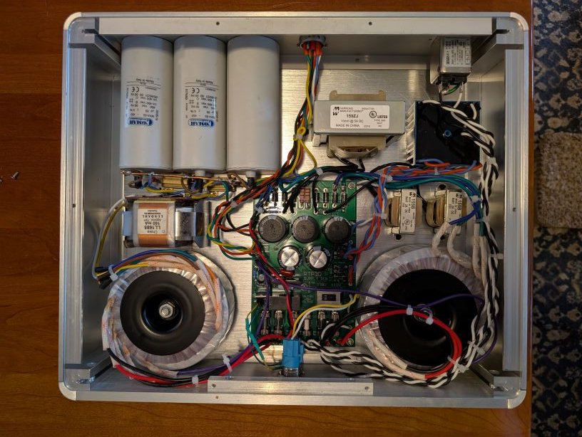

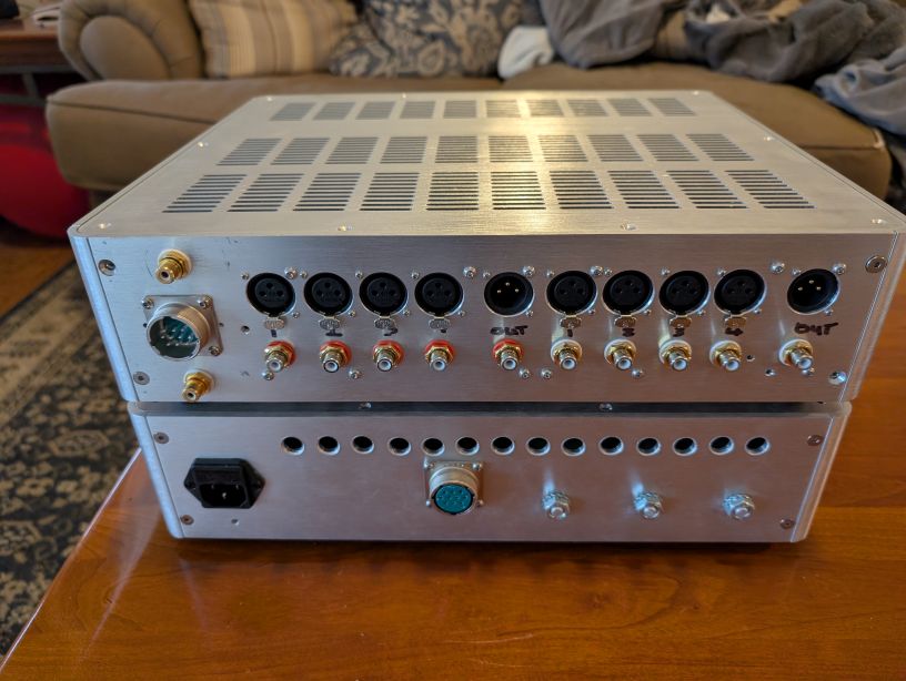

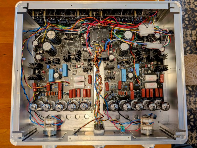

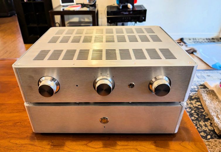

This took me about a year. Probably the most complicated build so far.
I got the PCBs and the information on how to build from @Algar_emi
This was a very difficult build and @Algar_emi helped along the build. I also had help from my dear friend @Sarunas
RTP3 sounds awesome, happy on how it turned out. I didnt have a chance to test the balanced input/output, this is the next step.
@Algar_emi has many other audio projects, PM him and ask what he has, he is a great guy. I am a NOOB and had a lot a patience with me.
