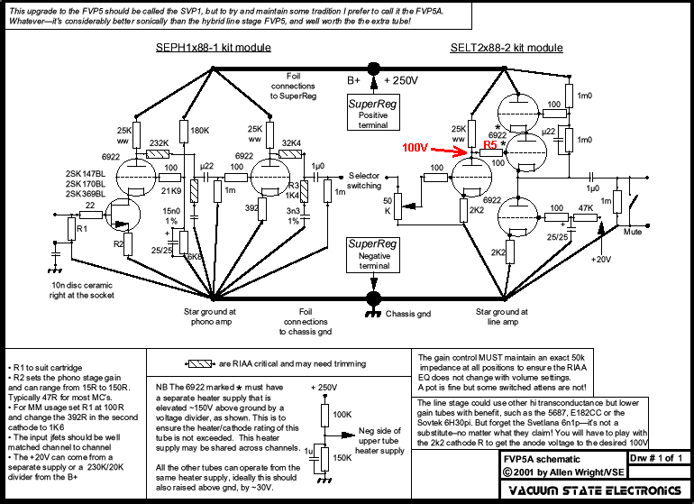

R23, it is grounded, right, hence 0V. Then if you are seeing 23V across it and 23V on the Input Cathode, that means that you are running more than 10mA and hence the tube is turned hard on (23/2200 = 10.45ma). There must be a wiring issue to cause that.
The voltage on the Input Anode needs to be up around 100V or else the SLCF Buffer will not work correctly.
Momentarily remove R5 and measure the Input Anode voltage and report it here. It should be in the 70-100V range I would think.
If it is, then connecting the R5 again, there should be no real change in that voltage. If there is a massive drop, then the problem is not the input stage, but somewhere after that. The problem would then be in the SLCF Buffer. These basic steps in fault-finding. Make sure the input stage is working first.
Can you verify the above and report back here. Depending on what you report, we will determine the next step.

I think Viljo incorrectly reported his measurements first time round - if I understand correctly, the 23V measurement was for the cathode of the bottom valve of the SLCF of the output stage, which is close to what it should be. I think the high voltage on the anode of the first valve, as you say, is the problem, and is consistent with the low voltage of 5.15 V on the first cathode resistor, implying a very low current of 2.3mA. This is also consistent with the initial measurements of my own FVP5, which I remedied by reducing the value of the cathode resistor from 2K2 to about 1K0. This circuit needs about 6mA to get 100V on the anode.

There is a problem with the FVP Line Stage that the bal/differential RTP does not have: Problem controlling the gain and to some extent high gain also gives you unnecessaries noise. With 25K Anode load and 1K on the Cathode, are you getting too much gain. Also, listen close to the speakers, what is the background noise like.
So 2K2 is a compromise, and I perfectly understand you going for 1K to get the Anode down to 100V.

@Alex M @Joe Rasmussen I removed R5 resistor and measurements are following.
U1 - Pin 1 - R5 removed - 188 V, changing R3 to 1K resistor lower the voltage to 147 V R5 included -
U1 - R3 - Pin 3 - R5 removed - 5,4V - changing R3 to 1K resistor then it is - 3,9 V R5 included
U1 - Pin 6 - R5 removed - 71,6 V - with a R3 resistor changed to 1K resistor then voltage is 152 V R5 included
U1 - Pin 7 - R5 removed - 19,6 V - with a R3 resistor changed to 1K resistor then voltage is 20 V R5 included
U1 - R6 - Pin 8 - R5 removed - 20 V - with a R3 resistor changed to 1K resistor then voltage is 22 V R5 included
U2 - Pin 2 - R5 removed - 148 V with a R3 resistor changed to 1K resistor then voltage is 190 V R5 included
U2 - Pin 3 - R5 removed - 162 V with a R3 resistor changed to 1K resistor then voltage is 197 V R5 included
U2 - Pin 6 - R5 removed - 162 V with a R3 resistor changed to 1K resistor then voltage is 197 V R5 included
U2 - Pin 7 - R5 removed - 0,02 V with a R3 resistor changed to 1K resistor then voltage is 142 V R5 included
U2 - Pin 8 - R5 removed - 72V - with a R3 resistor changed to 1K resistor then voltage is 152 V R5 included
To get U1A pin 1 anode to 100 V then R3 have to be I think about 380 ohms. How to lower the gain then? How that affects sound quality if anode has much higher voltage than 100V?

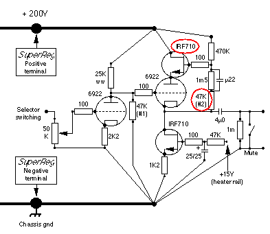

This is the problem with the FVP5/SVP that Joe alluded to. You have to reduce the cathode resistor on U1A to a small enough value to get the anode to 100V to allow the SLCF to work properly, but this gives you a line stage gain that is too high for most systems. My solution was to replace the 6922 with a 5687, which has a lower transconductance. This did reduce the gain somewhat, though I don't remember by how much. To start with I used the other half of the 5687 for the lower triode of the SLCF (the current sink), but since its transconductance is not really high enough for this function I replaced it with an IRF730 as in the "hybrid FVP5", and repurposed it as a tape output buffer with another IRF710 on its cathode, which works well.@Alex M @Joe Rasmussen
Ideas how to get this to sound superb?

Alex, very well summed up and yes, we need to control both the gain and the voltages seen by the SLCF as well. A voltage that would work well is 100V. I can suggest two ways of doing this and that is why there will be two variations and using the 12AT7 tube.
These two basic variations can then had additional customisations in the SLCF and I will have some suggestions to make there as well. For example, the SLCF current source FET can be an IRF820 as there is no voltage swing on the Gate and hence it rather high capacitance is less of a problem. But the FET on to makes the tube follower in 'constant voltage' mode, if using a FET there, then it is much better to use an IRF710 as it has lower non-linear Gate capacitance. That IRF710 has voltage swing on its Gate. Below is shown Allen's compromise/solution that could be improved upon.
The IRF710 or even IRF820 on the bottom is just fine. But the IRF710 is better up top. But note the 47K is a compromise because of that Gate capacitance, this is not used in the SVP as it becomes a tube. My FVP-6 12AT7 version solves the problem by using a high voltage Darlington there and that gets rid of the 47K resistor.
So there is stuff like that we can discuss, but the gain and noise is top of the list, but also sorting out the best but most simple SLCF is also part of it.
