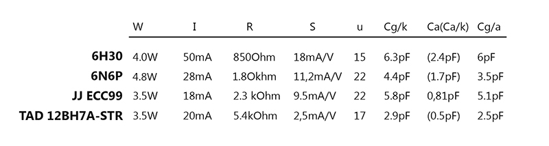

Regarding tube selection. How detailed or clean the tube sound is somewhat connected to Miller capacitance, and generally speaking: The lower the capacitance the cleaner and less distorted the signal will be.
Oneminde,
Interesting your remark on Miller Capacitance and its impact on sonics although I'm not sure if this impact is true and major for all kinds of tube circuits.
For cascodes like applied in the RTP3 gain stages Allen made a remark, I think I have read that in Audioasylum, that transconductance of a tube is the most important factor for operation in a cascode circuit.
Günter
Günter
That might be true, so high transductance 🙂
I have also heard from several people that the 6N6P sounds better than the 6H30 and if we compare does two only, then the 6N6P has less Miller effect, higher gain but less transductance than the 6H30 ... hmm

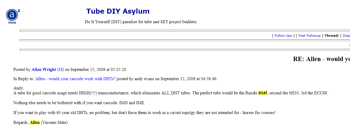

Yes, here a remark from Allen on cascode tube choice in Audioasylum although he forgot here to mention the E288CC:
RE: Allen - would your cascode work with DHTs? - Allen Wright - Tube DIY Asylum
On input capacitance he said the following in the schematic explanation of the line stage cascode in the instructions:
"The cascode topology also greatly reduces the effective input capacitance
of the first tube—allowing a bandwidth beyond 1MHz, which is little effected by the source impedance."
So this probably makes clear that input capacitance is less important for a cascode.

Amplification Factor, u; 52
It has among the lower Miller effects + highest transductance + highest gain factor.
Yes extremely high transconductance, but also an amplification factor of 52!
This is good for a phono stage but way too much for a line stage in my opinion.
And I have no idea how sensitive this tube is wrt to microphonic effects.
Günter
Günter
Right, for a phono stage it would be good. So if; "The cascode topology also greatly reduces the effective input capacitance of the first tube—allowing a bandwidth beyond 1MHz, which is little effected by the source impedance." - then the 6H30 will do since has higher transductance than 6N6P.
