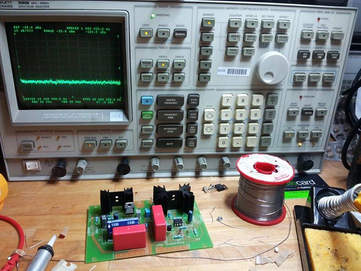

Can you tell me the ground scheme with this reg, please? I 've got a heavy background noise.
I am trying to use 2 Salas boards from one HV raw supply to feed R&L channels. I just couldn't understand how to connect grounds. So I went the easiest way - just disconnected 1 channel and tested each SSHV with its own channel. But before that I changed all the grid resistors from 100 Ohm to 1K. Hum was gone. Not sure what cured the problem - resistor change or channel isolation. Anyway, now I know that everything works perfect with each channel supply separated and I need to decide which way to go - 2 separate supplies for SSHVs and also heaters or to revert to 1 raw supply and see what comes out.

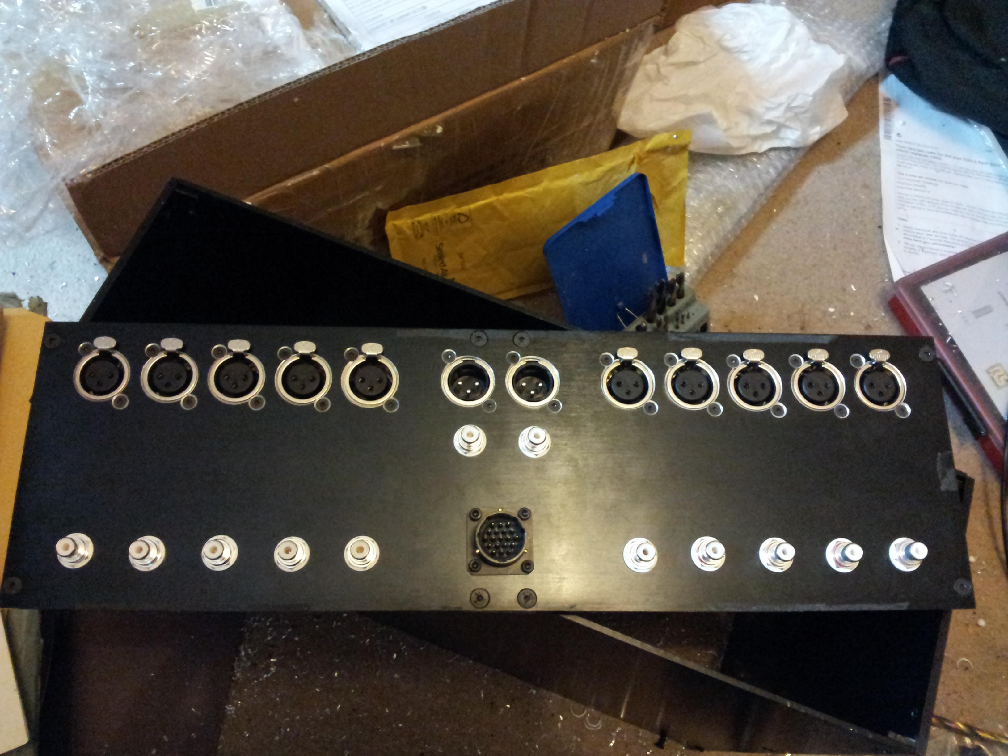

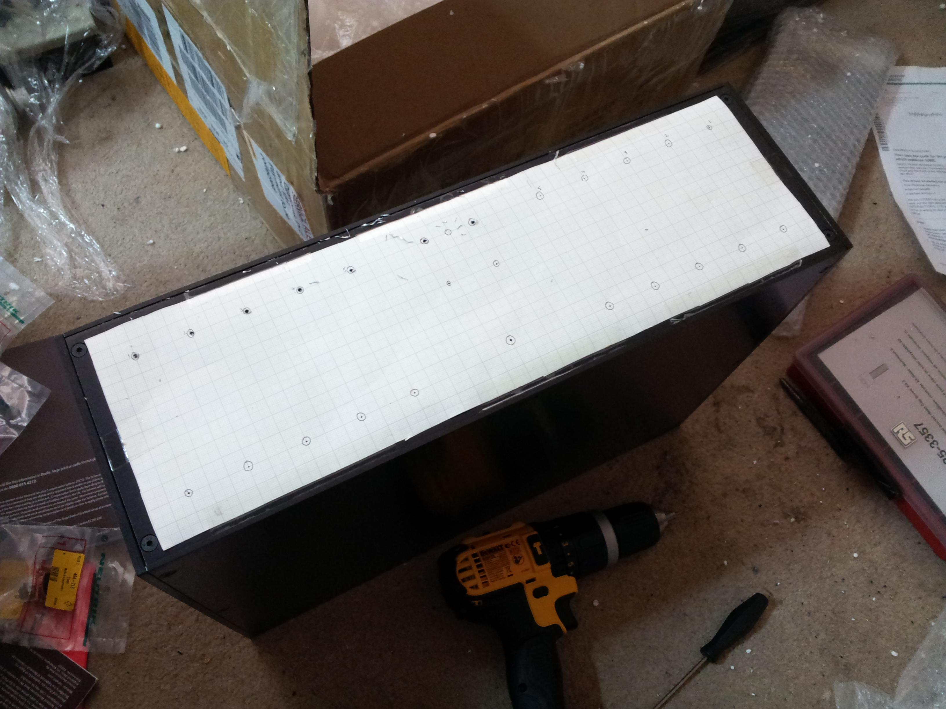

Start of RTP3 build
I've just started building my own RTP3 having read this thread and buying a copy of Allen's excellent pre-amp cookbook. What an inspiration the man was.
Knocked up the first super reg today. Will try and post regular updates of my build.
