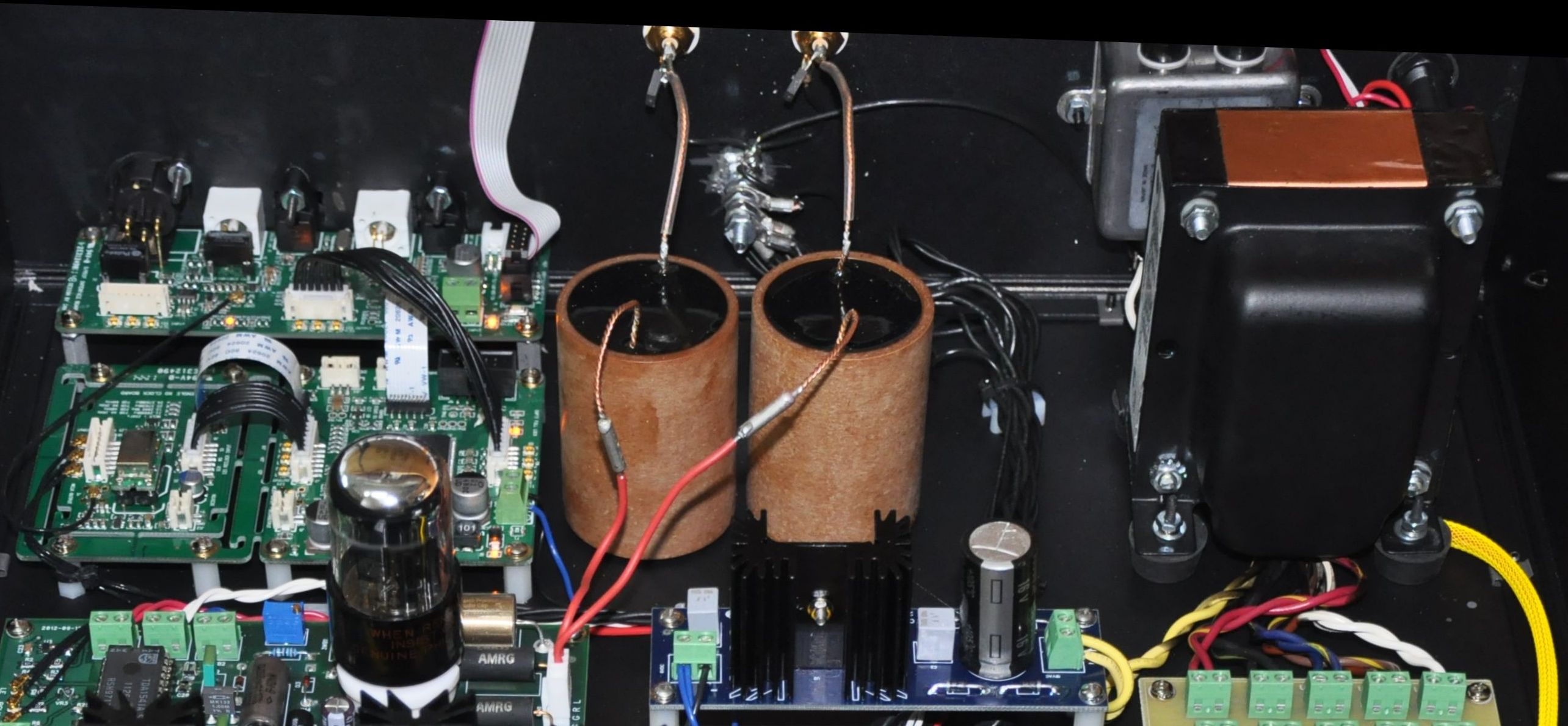

Here's a picture of my DAC employing a single point ground using a #8 bolt with soldered ring tabs. Every PCB (or item) that requires a GND is returned to this point. Ideally, all grounds should be the same length as the purists will tell you. Have used this method in every piece of equipment I have made and I can tell you it's the best way to implement it. I cannot emphasize the importance of ensuring AC Line and Neutral connections are kept consistent and correct from transformers in each piece of equipment and between components to ensure the quality and safety of this approach.
BTW - the term "star ground" is typically used when describing PCB ground methods. When wiring a chassis, the ground point can be at any location as long as the "star points" (the wires) are reasonably close in length.
Thanks! That's a fine looking DAC you have made there!
I'd forgotten the restriction of all the leads being of the same length, thanks!

I'd say Roger's photo of his DAC is a very good example of employing single point star ground. There are a lot of variations though but the whole concept is pretty much the same.
