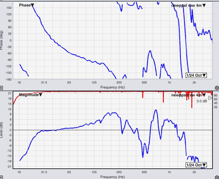

Not sure what you are looking for, but maybe it's just the raw response... here it is... same 4m outdoor that's been the basis for all posts..
Since I never use a sub past about 120Hz, I don't bother thinking about response higher up in freq, .....other than making sure of no resonances, rattles, etc when cranking lol.
The upper response of course affects the crossover choice- the 120Hz LR24 is -15dB at 240Hz, a 120Hz LR12 would only be -3dB at 240Hz.
The "V" twin has no major cancellations below 250Hz, while your 2x18 PPSL using the same drivers has a notch at 160Hz and a steep drop above 200Hz.
Thanks for posting the raw response, it's interesting to compare upper response to see what is required to "fix" it, and the useful range.

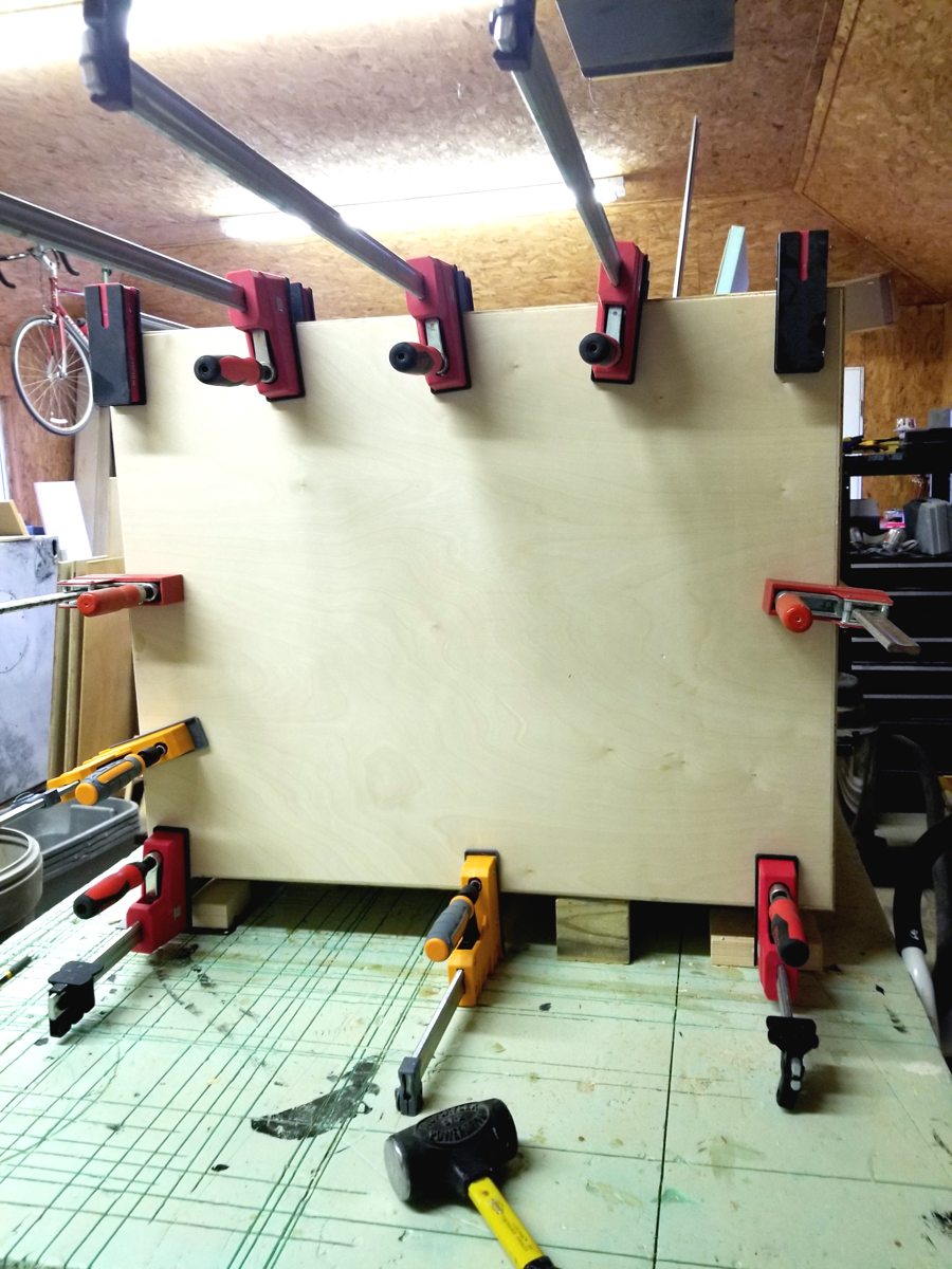

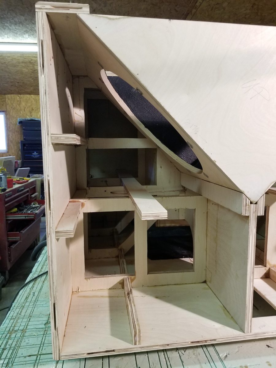

Last one...#3 of 3.
Getting close to done...time to put the lid on this one...
Lid on.
Gotta say...I'm listening to a pair of these subs in stereo right now, under some unity/synergy horns.
ROCK.
25 Hz response,..... smooth and level... good to high SPL......just asking to be unleashed and let breathe..and let me work out any resonances LOL

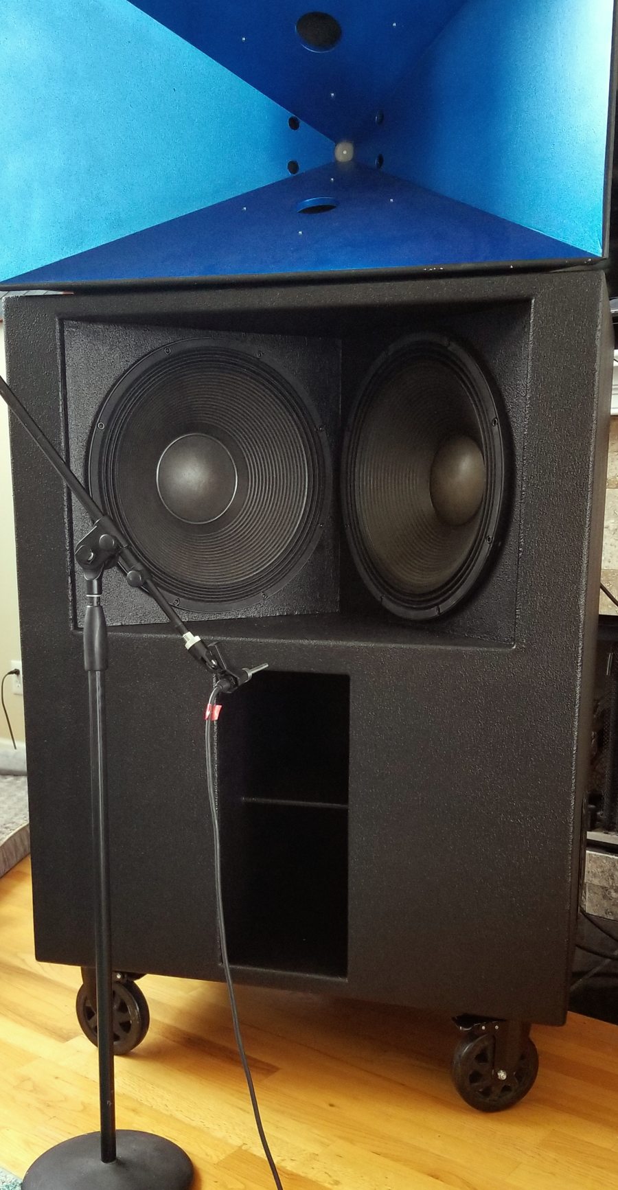

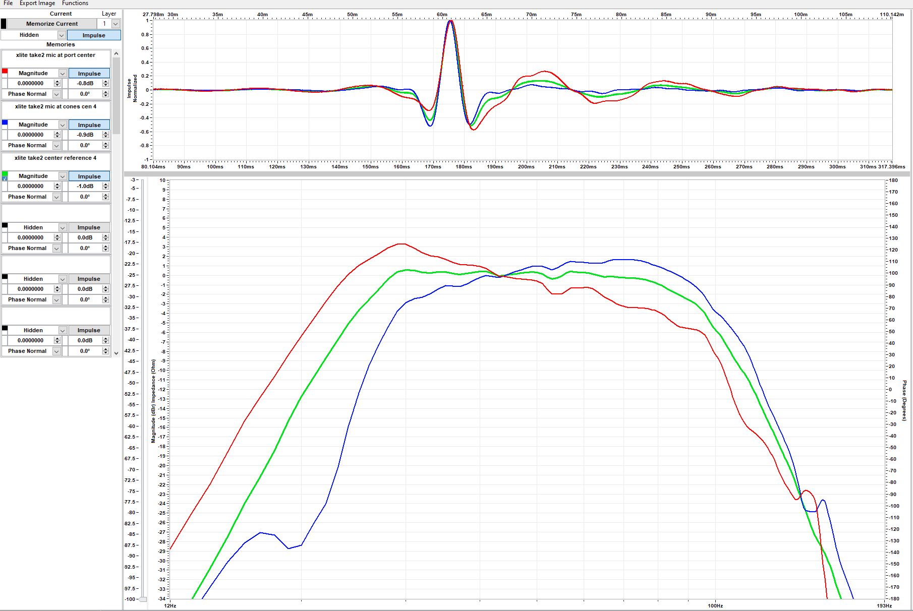

Never had a sub before like this new 'V-Twin',..... that is so easy to measure indoors (up close).
With sealed subs, I've always had to get within an inch or so of the dust cap.
And with vented, it was the same problem with sealed, but that left the port(s) pretty much out of the measurement.
Or at best, the mic could be positioned to catch one of the ports.
So I've always ended up going outdoors on the driveway, to make a raw measurement that I'm willing to use as the basis for processing.
(personally, I feel most indoor sub measurements...esp at LP, are hopeful thinking at best...but that a whole 'nuther topic, huh?😛)
I can measure this new guy indoors anywhere around 2-8 inches away from the box, in between the cones and port....
and the box centered measurement closely matches outdoor ground plane measurements!!
No splicing, no gating !!
Mic like this pict
Here's a set:
with the mic centered between cones and vent as shown above, GREEN
and then raised to cones center, BLUE
and dropped to port center. RED
1/24th smooth,
100Hz lin phase xover, 20 Hz IIR 3rd order high-pass, and a few min phase PEQs
The indoor ease sure beats lugging sub out to driveway...never had the option before.

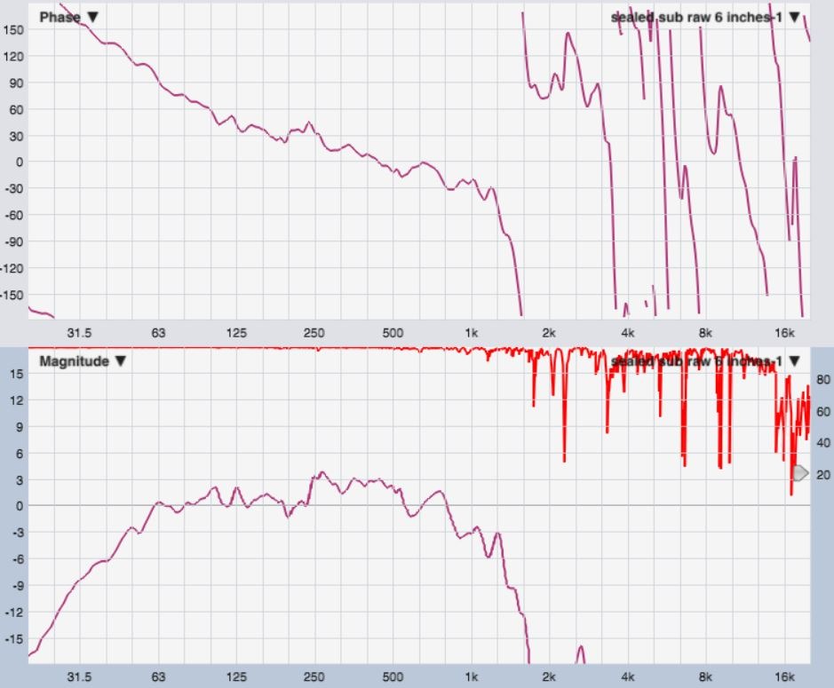

I’m interested in just how high the 18N862 can be used (2 per side), so could it smoothly reach 300hz?Yes.
@ BP1 Thanks 🙂
And yeah, who cares about subs running up higher.
Only time I've ever done that was seeing if a sealed 18n862 sub could reach smoothly up to 300Hz,
that a B&C dcx464 CD / me464 horn combo could go down to..
Here's raw response of sealed, albeit close indoors. I think i have ground-plane outdoors...will try to find.I’m interested in just how high the 18N862 can be used (2 per side), so could it smoothly reach 300hz?
300Hz is pretty easy with the 18n862...
Hi Studley, sorry i can't find outdoor raw.
Hmmm...I don't think i ever even made such for the sealed, because I found the right drive/files, but there were only indoors traces.
I think I probably saw f-6 @40hz and said why bother lugging outdoors LOL.
I do see where I put an LT transform on it, but man how I hate to use low end boost...which I think simply robs max linear SPL for the whole sub.
Anyway, I'd be very comfortable using the driver up to 300Hz...
