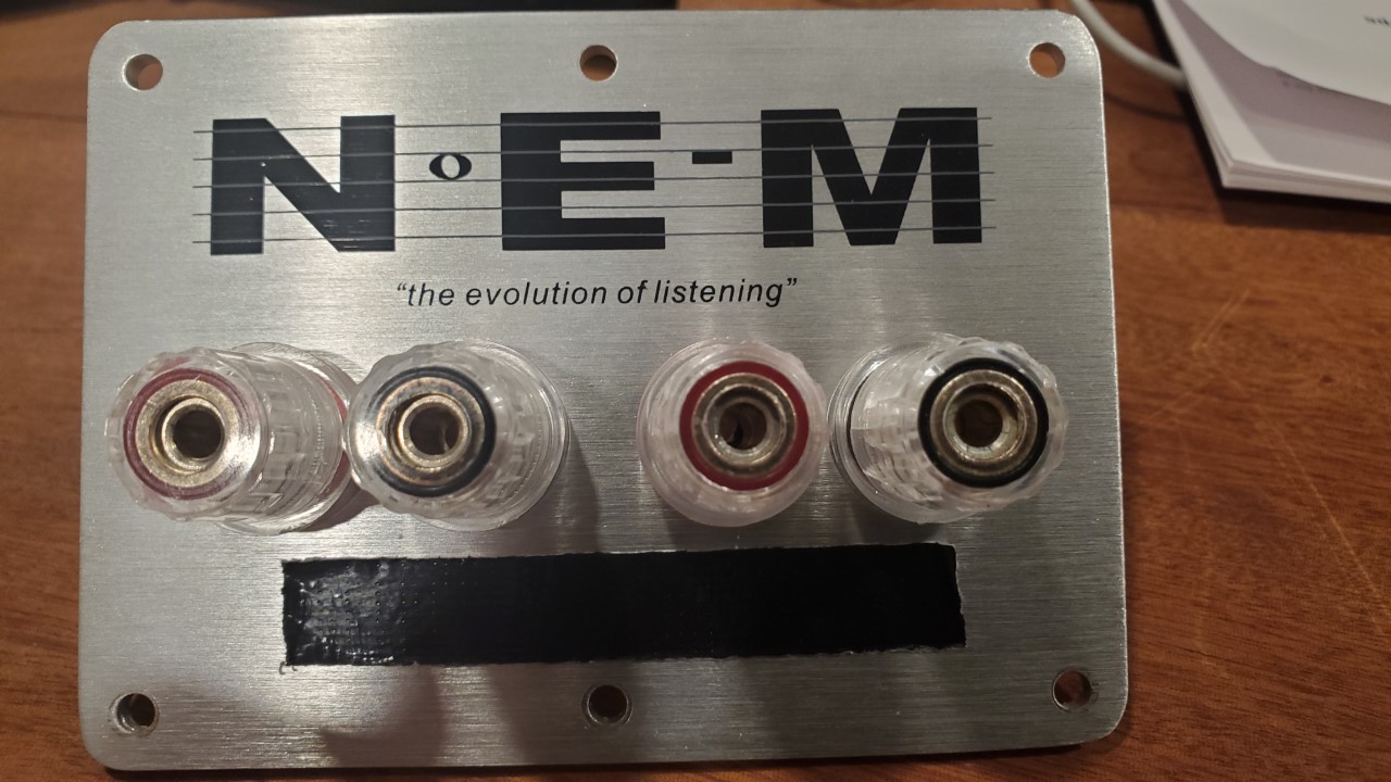

You can see the screen in the large black areas. Using the black strip below the connectors, I count 12 threads. If that strip is 1/4" high (only an estimate), there would be 48 horizontal threads per inch. Since the mesh size is the number of threads per square inch, that would make that screen 48 x 48 per inch = 2304M screen. I also see quite a lot of "ink bleeding" fill in, so that would seem to indicate the masking effect is being used to make "the evolution of listening" acceptable.

You can see the screen in the large black areas. Using the black strip below the connectors, I count 12 threads. If that strip is 1/4" high (only an estimate), there would be 48 horizontal threads per inch. Si.
The black strip is a piece of tape. just covering some lettering that will be removed or replaced

I can see that now - you got me!https://files.diyaudio.com/forums/images/smilies/redface.gif

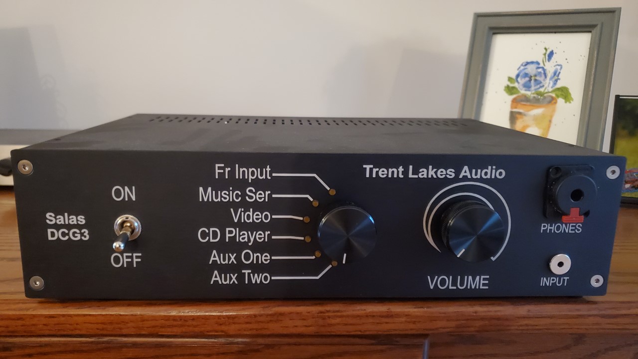

Lucky guy!!!! 😀Turns out my newest neighbor has a Trotec Machine and also a 4x8 steel and wood laser cutting cnc machine..
I Will be getting all faceplates etched right next door.. Pic of the first one!
