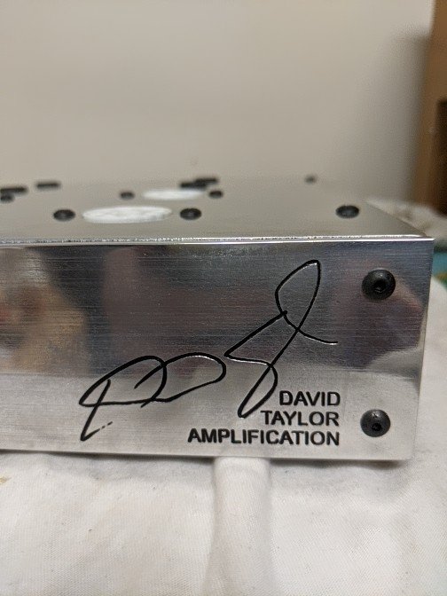

Kuroguy - nice engraving; looks good.
The engraving in post 20 looks great - I have a feeling the machine was worth $K's.

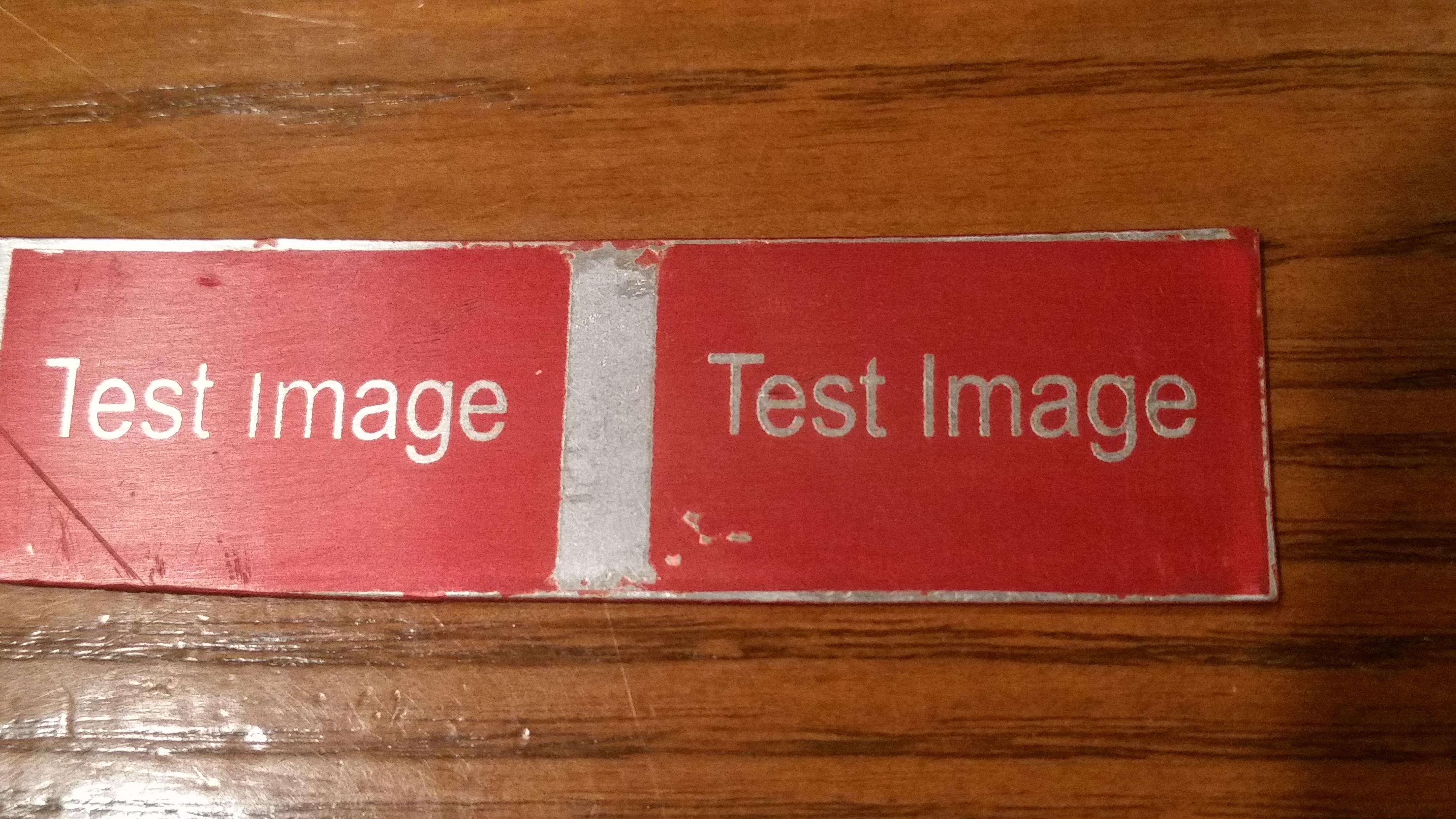

Turns out my newest neighbor has a Trotec Machine and also a 4x8 steel and wood laser cutting cnc machine..
I Will be getting all faceplates etched right next door.. Pic of the first one!
Lucky guy!!!! 😀 :up: :up:
