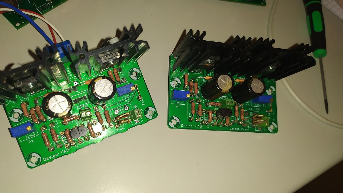

Hello everyone, a few days ago I received the PCBs thanks to the courtesy of Fab who already has a new child since last Sunday even if he does not know it
: D
The preamplifier (USSPA 1) is very promising, after a proper break-in I will report my listening impressions ... Thanks again Fab.

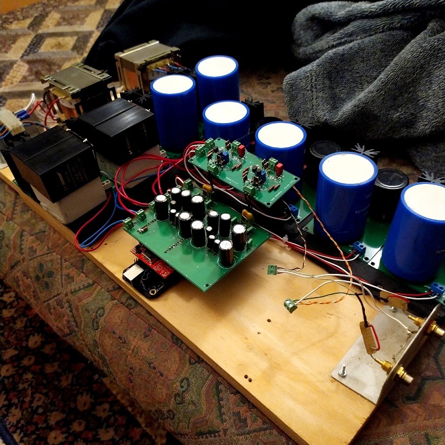

Hi, it is sounding ... for now I can only say that it sound good, the soundstage is good in three dimensions, the tonal balance is correct, the dynamics are decent, but overall the sound appears a bit tied. It's changing for the better minute by minute. Too early to judge. The power supply uses silicon carbide diodes, 4-pole Mundorf AG + 6800uf and 4-pole claritycap TC4 100Uf, the regulators are belleson. It is one of my strengths.
Hi Pinocchio, you see well, these 4-pole capacitors, they are really special and I think this preamp is special and that will be followed by the version with the Sanken, first I need to recover some 2sk170 and 2sj74 then surely I will make it ... maybe together to a USSA.

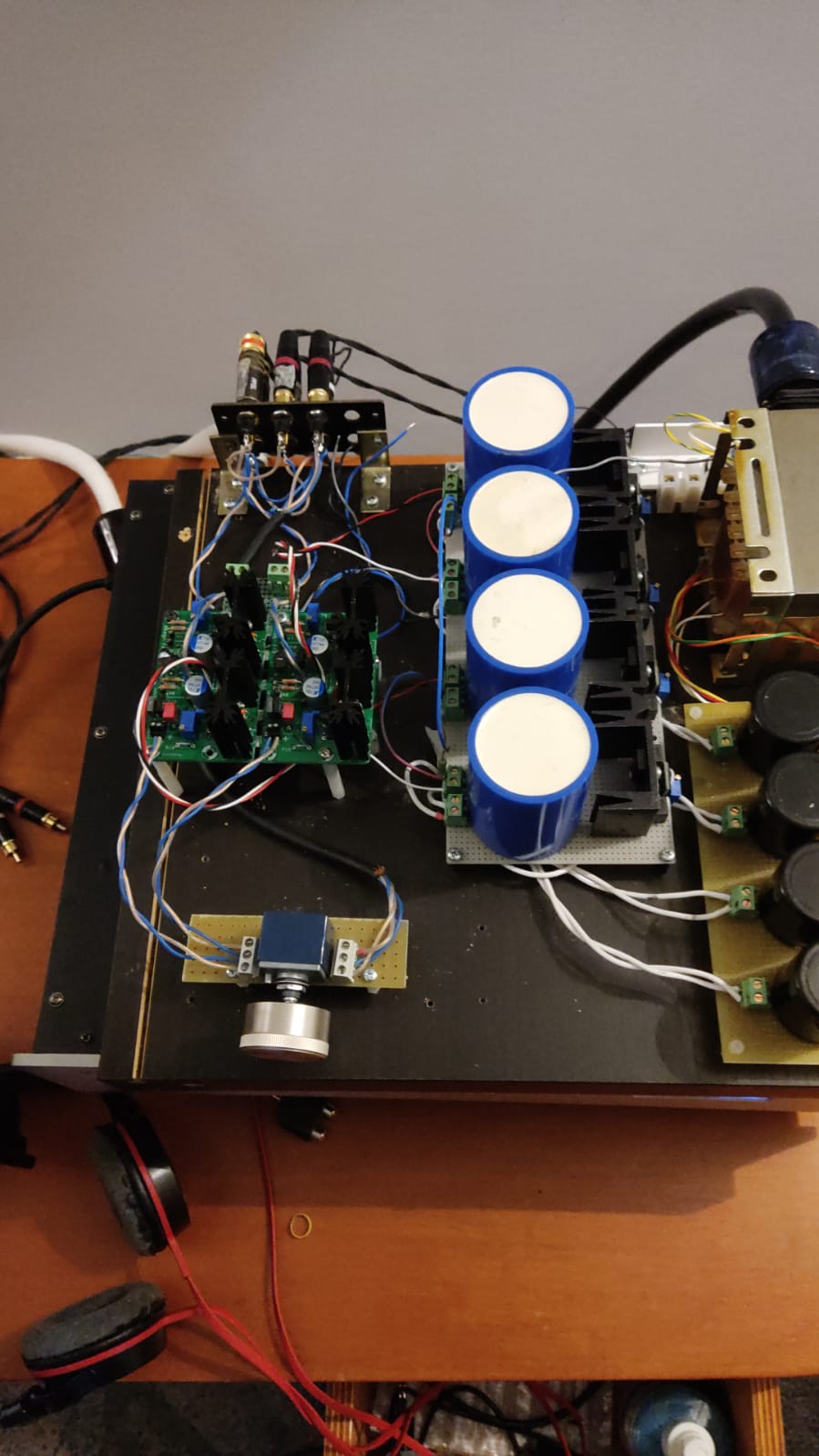

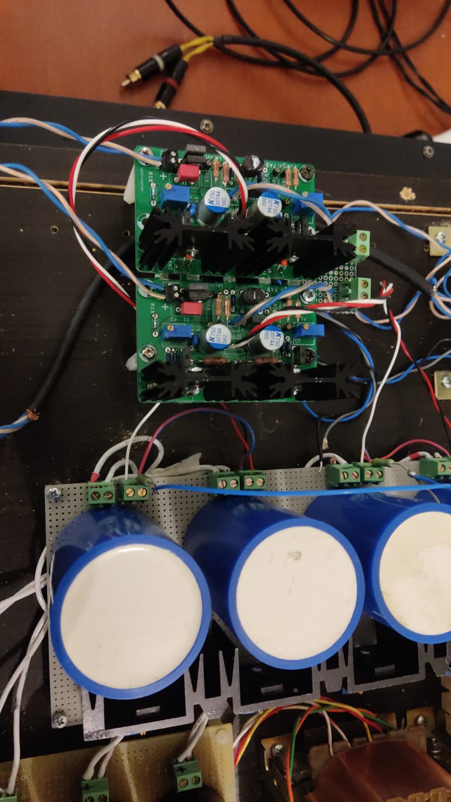

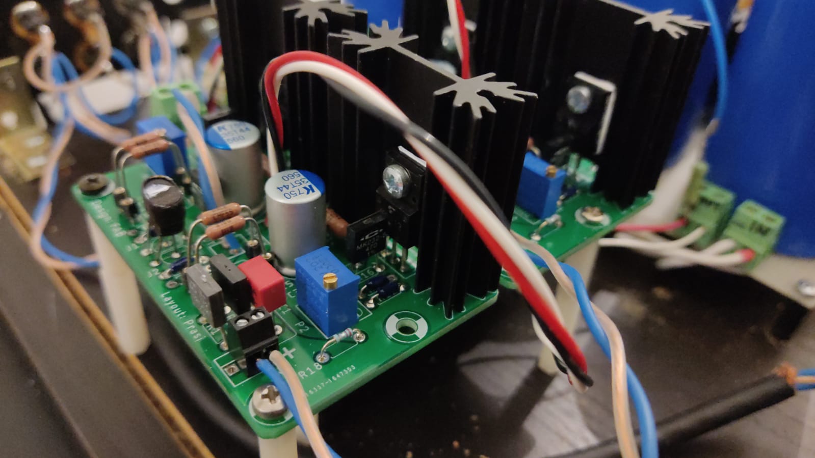

My friend Fabio (fabiodipietro27 member) made me discover your USSPA project. The reason that affected me to this pre-line was my need to use it as part of the analog section of my DAC with a sufficient gain after the execution of the I/V conversion (the DAC adopts the PCM1704 and the conversion takes place using the 'Opa861). The task had been assigned to some candidates all put on par to compete for the primacy. My main goal was to have the best and at the end of long tests the best was the USSPA-1 equipped with the Mosfet Toshiba J313/K2013. The most interesting thing for me was that I wanted a pre -line without coupling condensators on the signal. Not only was this goal centered, but the reinforcement quality of the USSPA is absolutely extraordinary. All aspects of reproduction are brought and valued at the highest level. My DAC uses PCBs entirely designed by me and initially I built the USSPA using the PCBs made available by Fab. However, as I wanted to make small changes and above all having a sufficient number of PCBs to compare by adopting other active components I thought of drawing them on their own. So I got the freedom to have my PCBs. I do not intend to compete with the author in the least. They are mine, for exclusive personal use. I still haven't understood well if the usspa-2 with the Sanken I like it more, I need other tests. What I have left to ask Fab, while I congratulate him for the exceptional performance of the USSPA which will be a reference for me, is this:
I wanted to try the FQP3N20/FQP3P20 mosfet. What values should I use resistance on the circuit to be able to use them? For now I have tried to put a 22 -ohm R on the source but I can't perform the size of the bias.To tester marks zero mV
This is original PCB
My PCB (modified)
MyDAC ( under test with another line pre )

I see that you have moved the wire connections toward the edge of the pcb in your version for ease of using screw type terminals. I prefer quick connect type terminals like in the actual layout. But it is a personal choice. Also, having the 2 jfet coupled together reduces dc offset drift due to temperature stabilisation.
thank you for not selling your version of pcb to compete👍
As for the FQP3N20/FQP3P20 mosfet version, there are some resistors value adjustment to be done to cope mainly for the different VGS threshold. I will get back shortly on that when I have the chance.
