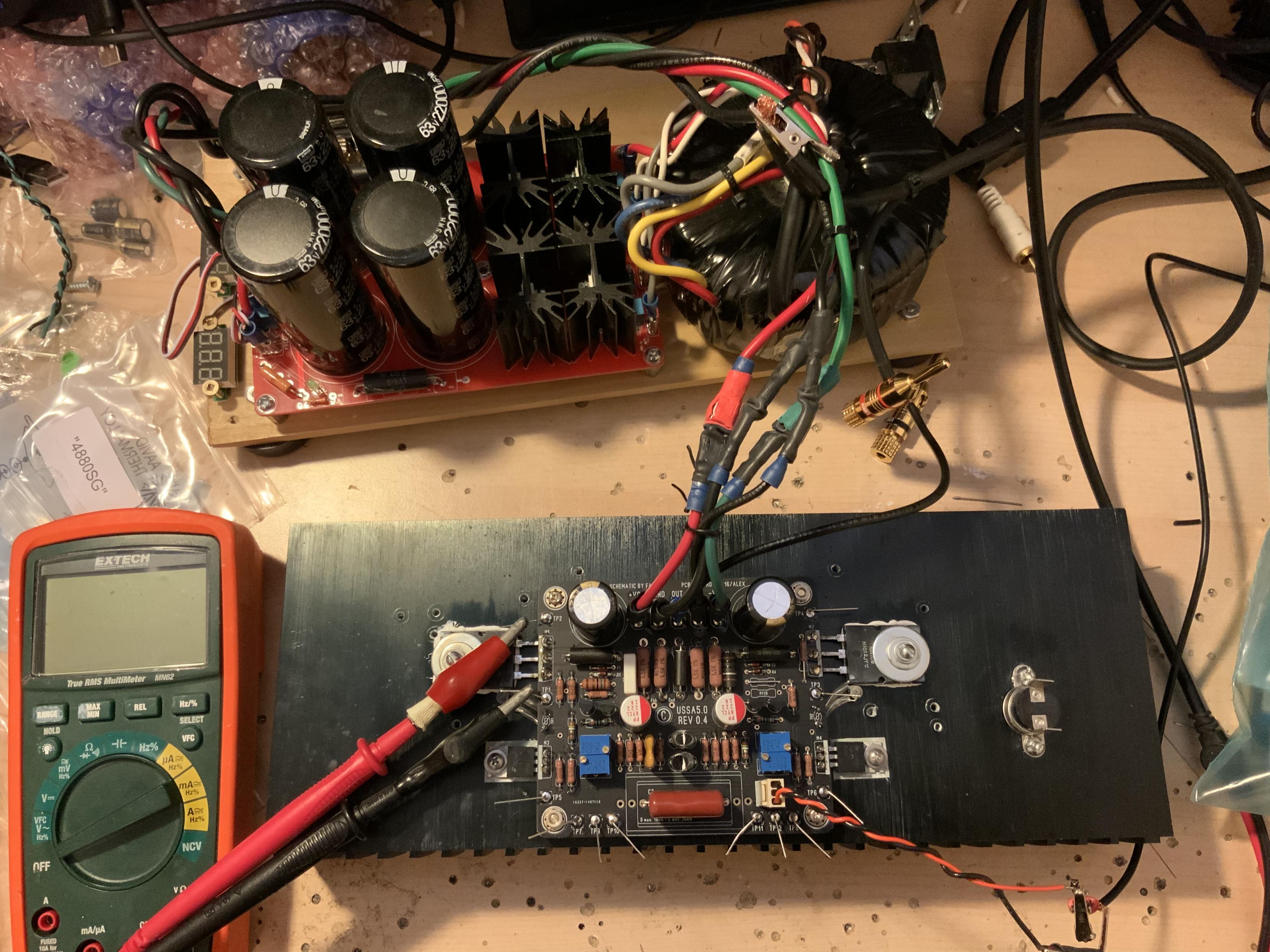

New USSA-5.2 version info

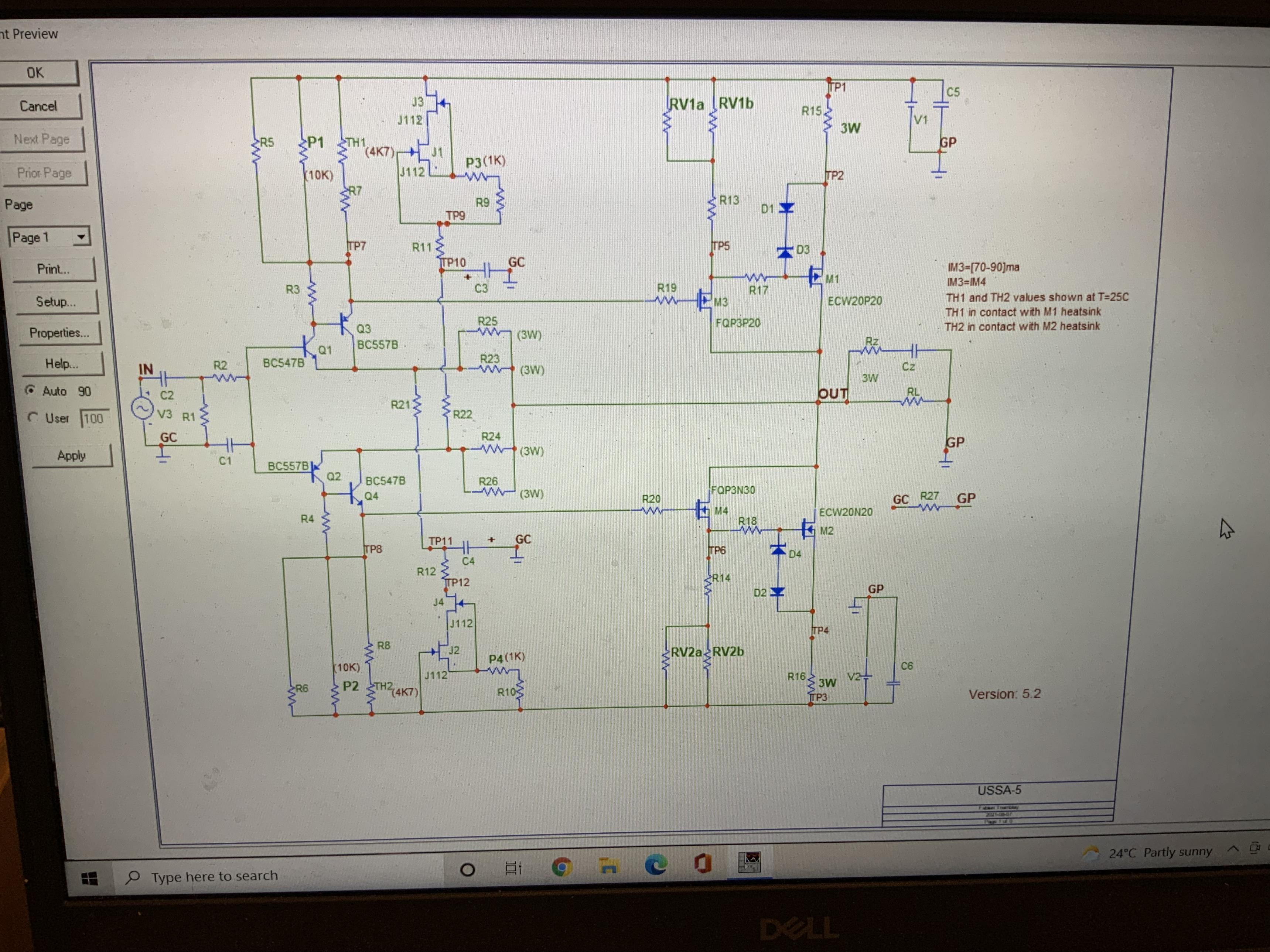

This is the schematics of the v5.2 and one channel under test. Main change is the driver transistors and adjustment of resistors value accordingly.
Fab
Fab

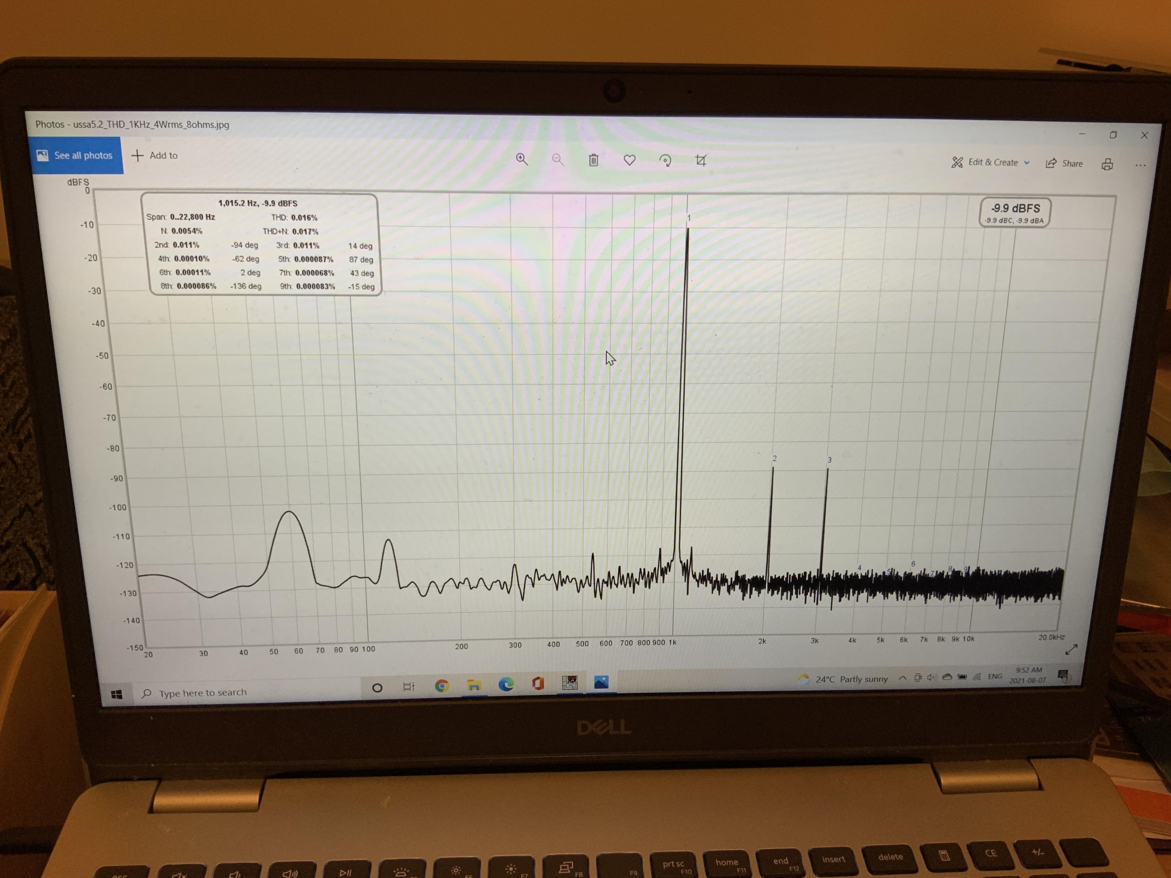

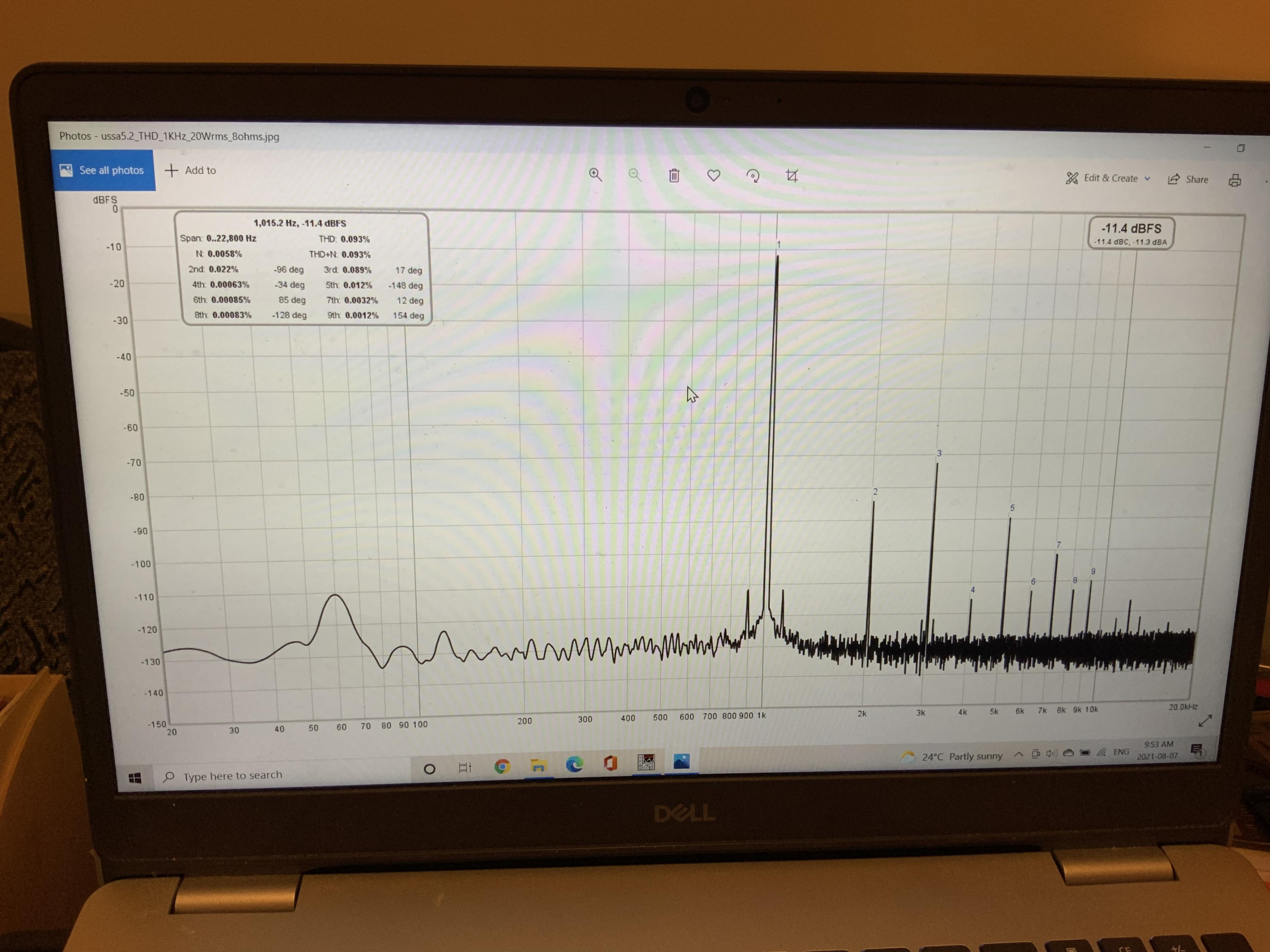

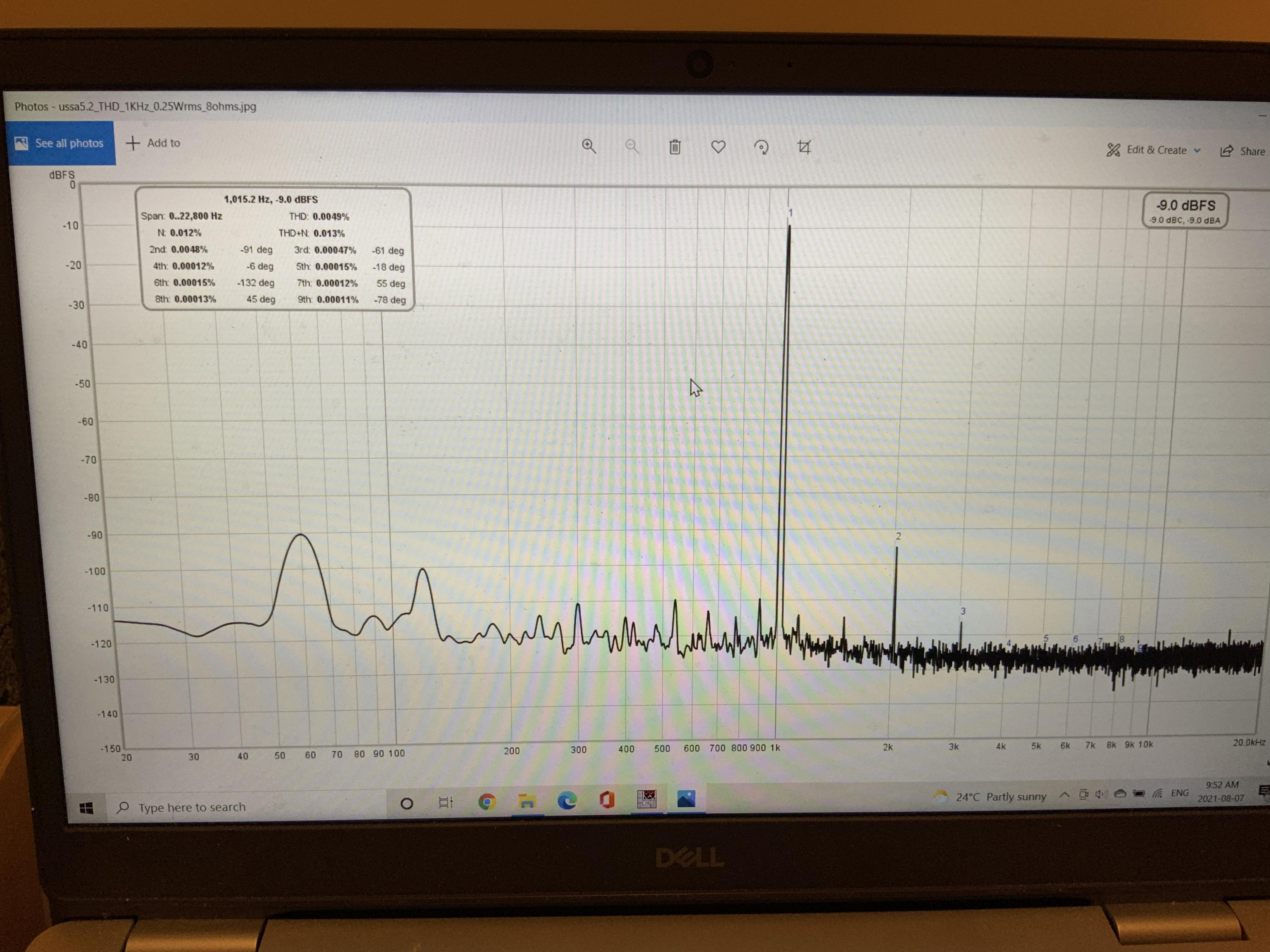

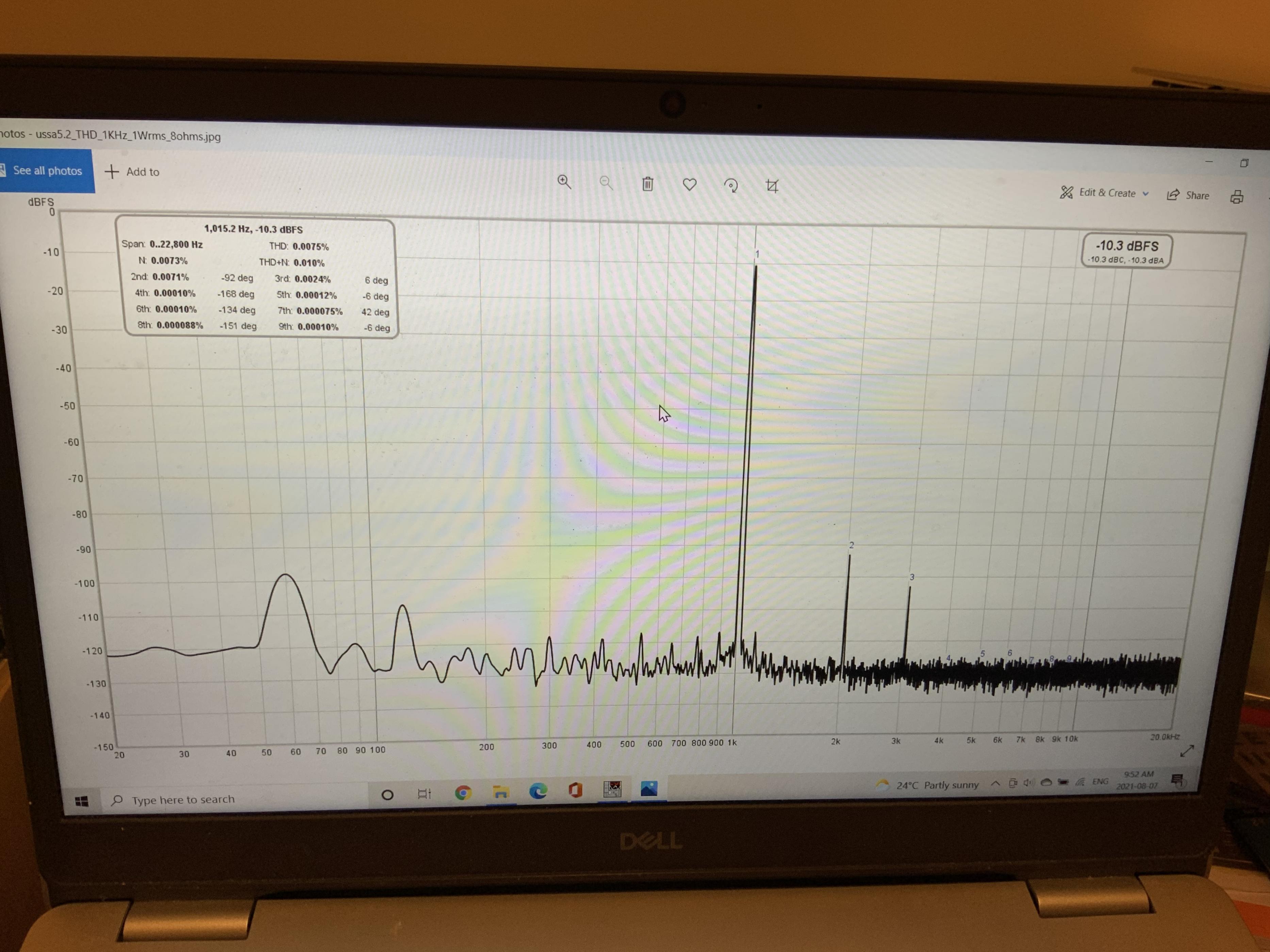

New version 5.2 THD

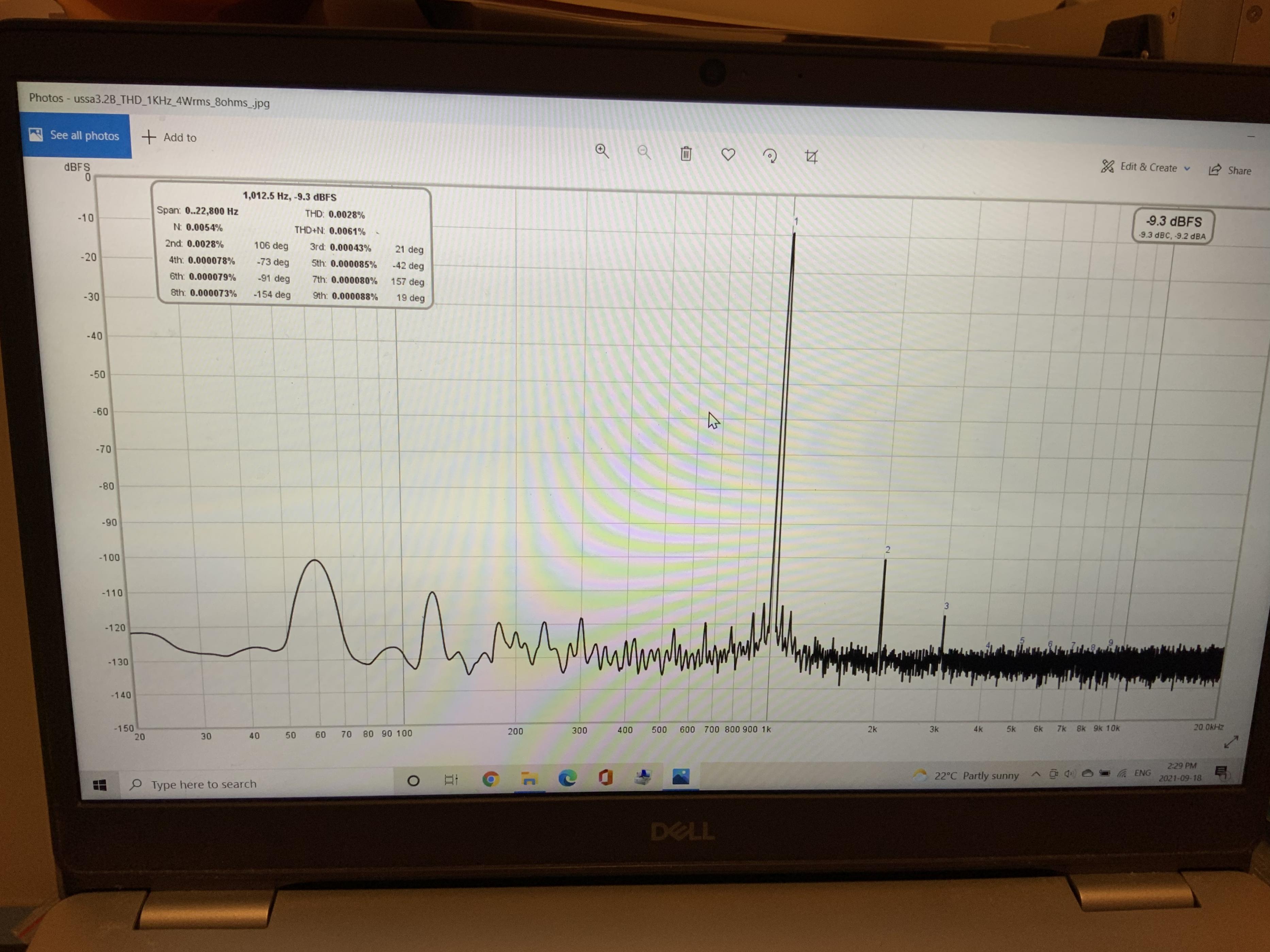

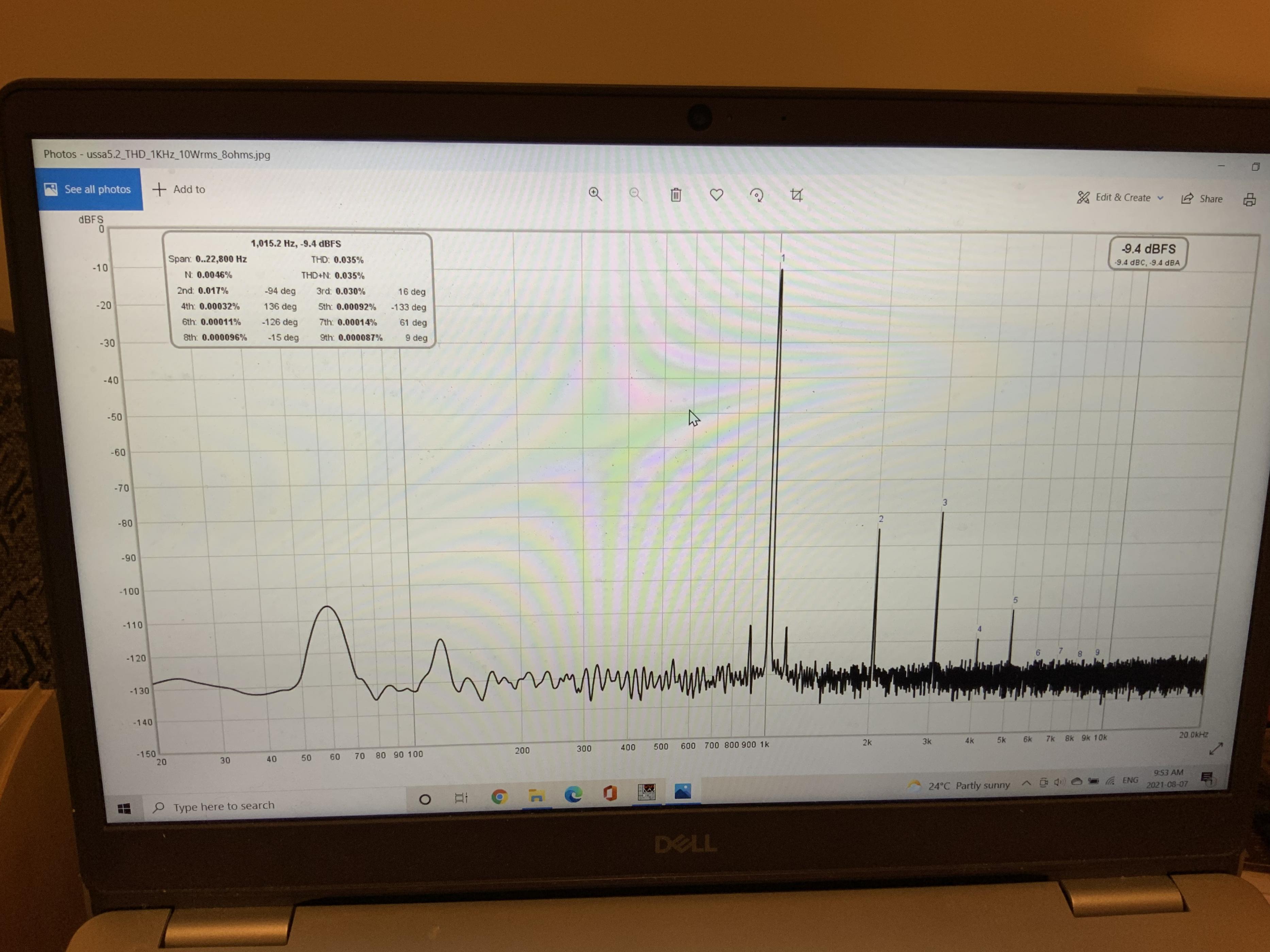

Here is the THD measurements profiles done at 1KHz under 8 ohms load for different powers :
Fab
Fab

From the thd profile, negative phase H2 is king
Only H2 and H3 visible up to at least > 4W rms.

Hi manniraj
Yes that’s true that 1W is usually enough. But in my case I have 87dB efficiency 4 ohms speakers and I usually listen at moderate level. Anyway as you can see even at 4W there is no presence of bad distortion. Even at higher power the amplitude profile is decreasing while harmonics becomes higher.

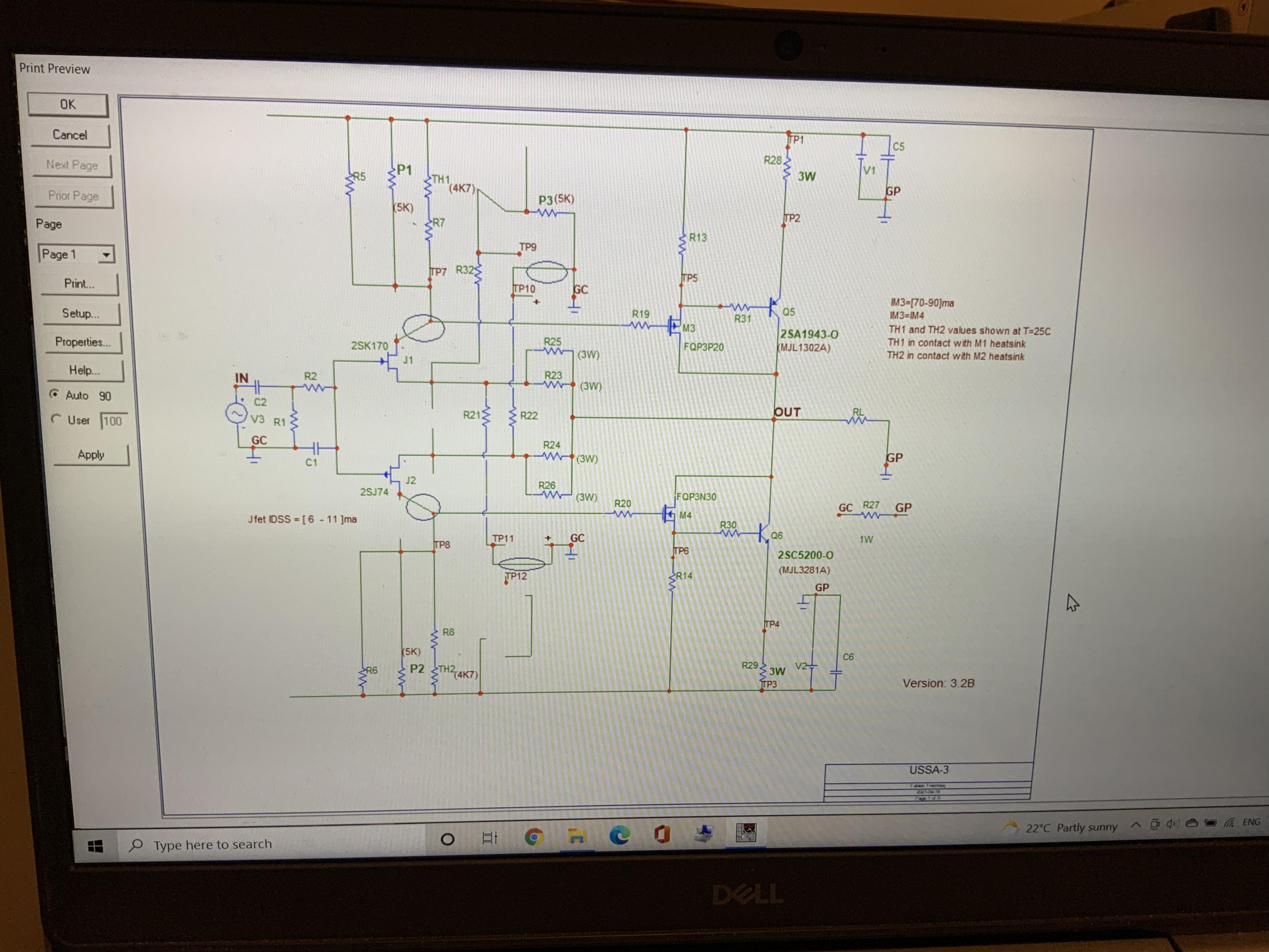

New USSA-3.2B version
Still in the process to update the USSA amp series with readily available drivers, after the USSA-5, my next candidate was the USSA-3B so it has become the USSA3.2B. The « .2 » means vertical mosfet FQP3 complementary drivers. “B” stands for bjt power output.
This is the same topology as the USSA-3.0 or 3.1 or 3B, except:
1) Drivers are FQP3. Recommended from the PASS forum over the IRF ones that I personally dislike;
2) LSK/LSJ (or 2SK/2SJ) jfet IDSS is now much higher [6- 12]ma “B “ grade which is the only grade easily available at this time in new stock;
3) DF is higher;
4) THD is overall the lowest one obtained from all USSA-3 series (if that matters).

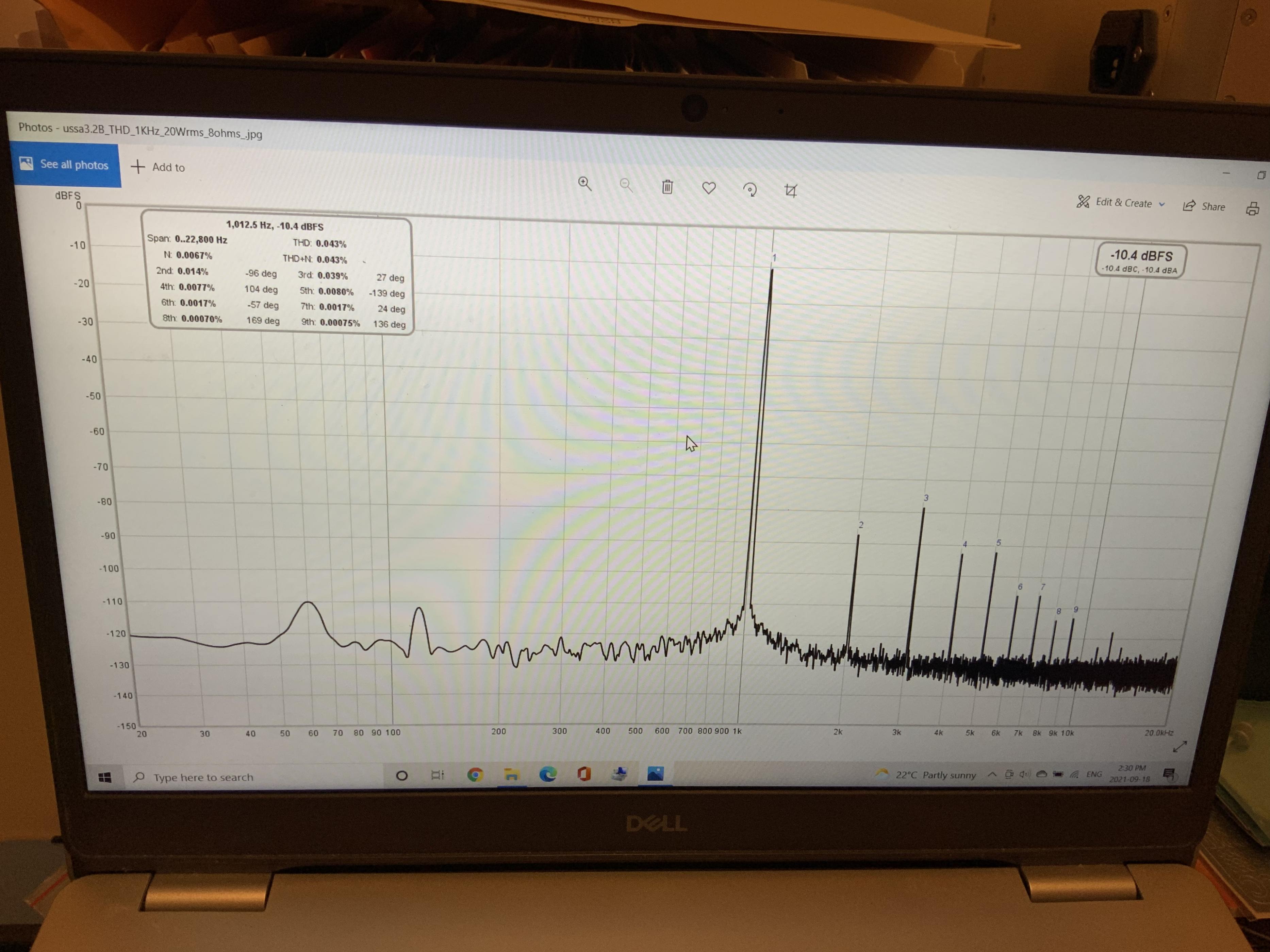

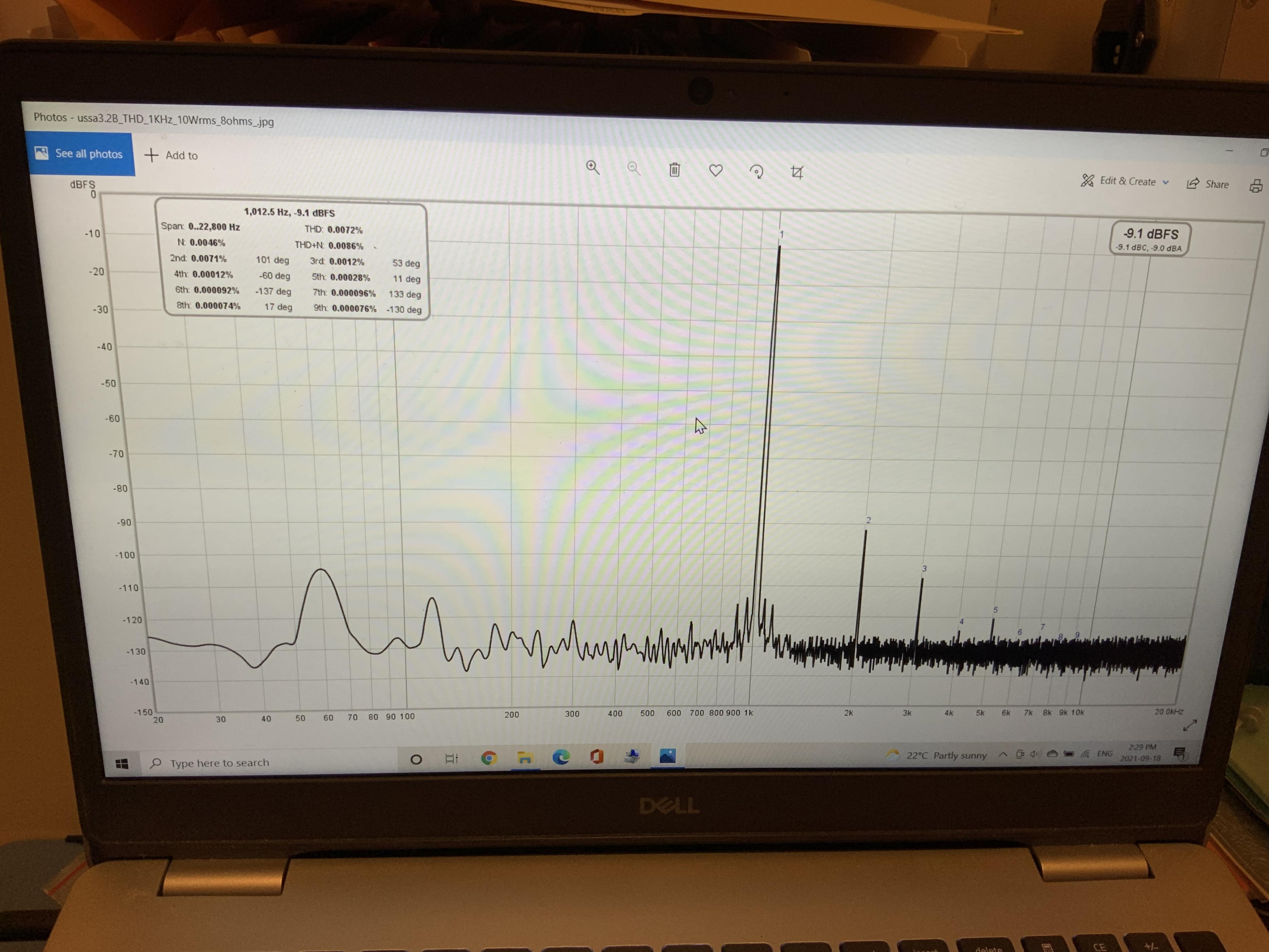

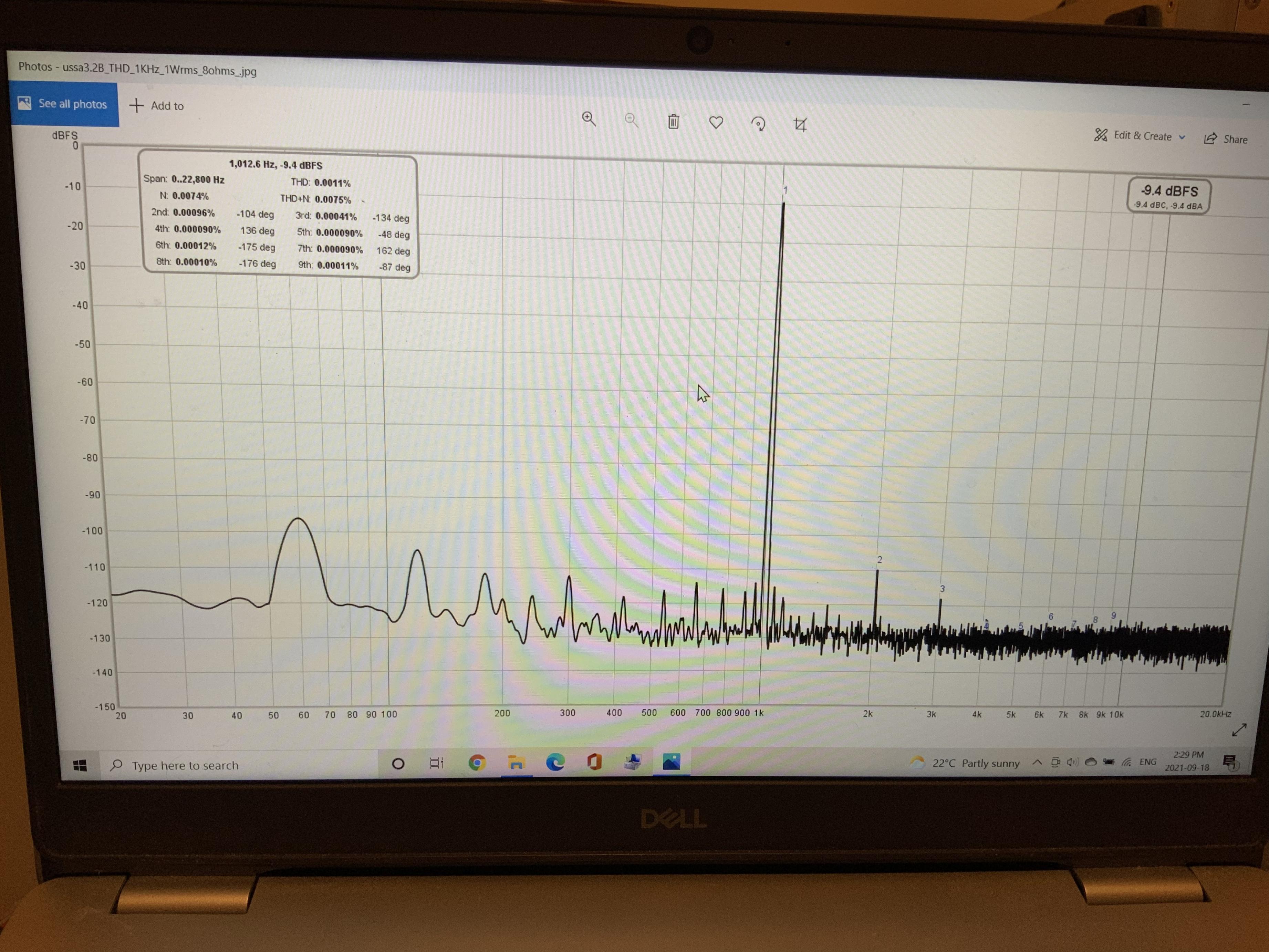

THD profile taken at some RMS power for 1KHz into 8 ohms. THD profile is again tuned with a potentiometer P3.
My first build is using MJL bjt output.

hi baggerbole
The jfet need to have IDSS matched within 8%. Driver mosfet should be matched < 100mv for VGS at (20 to 40)ma ID. Output dual die mosfet only needs to be selected (-S suffix) with same VGS Color code between N & N, and P & P to have similar characteristics between left and right audio channels.
